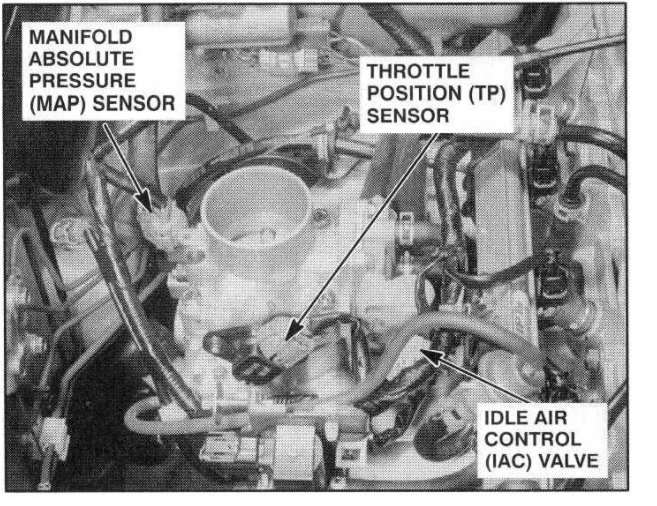

This sounds like you have a MAP sensor that is going bad. Here is a guide to help you see what other tings it can be but I am pretty confident in the MAP sensor correctly the problem.
https://www.2carpros.com/articles/engine-hesitates
