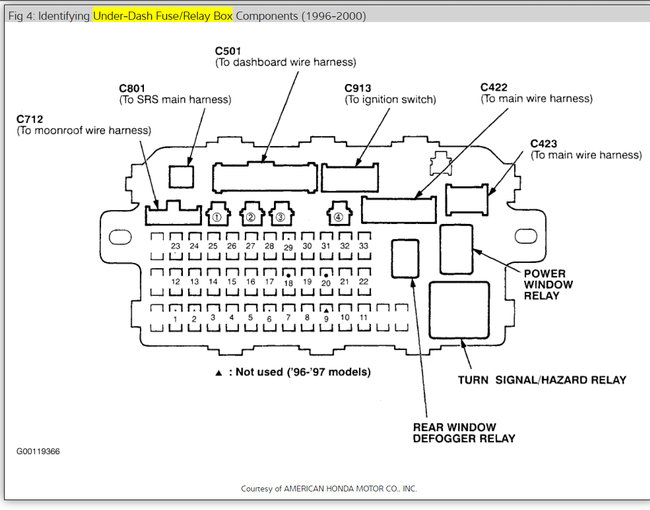

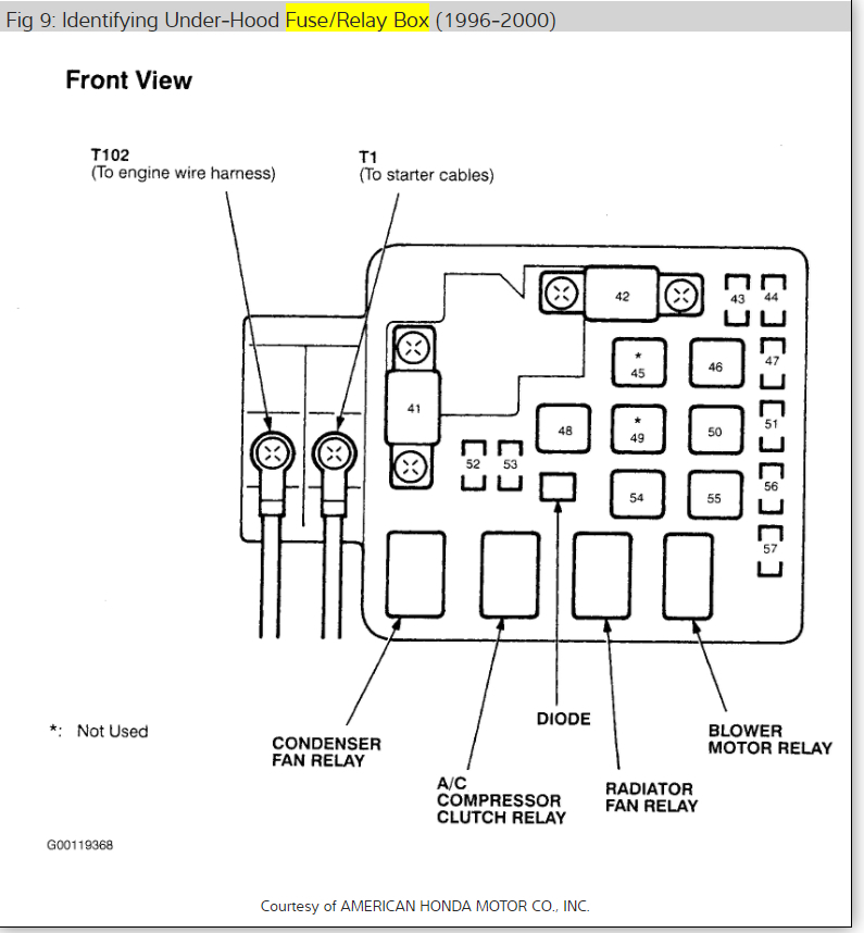

Hello. My power door locks recently stopped working completely. I havent had any glicthes with them before. I checked all my fuses and can't figure out what is wrong. I am still able to unlock the doors manually. Thank you
Mar 23, 2010 at 1:40 PM
KHLOW2008
  • 41,814 POSTS
Hi MicNB,

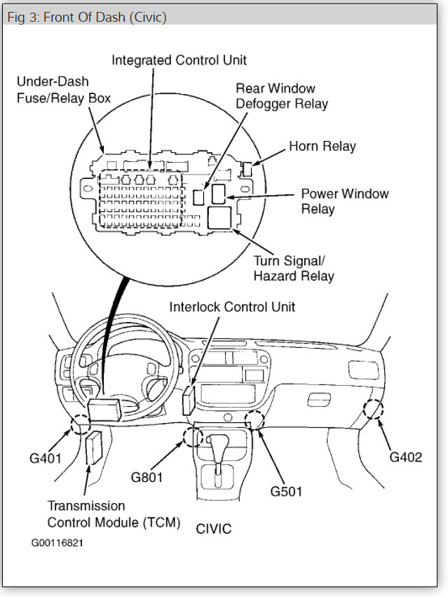

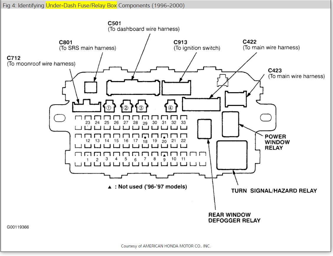

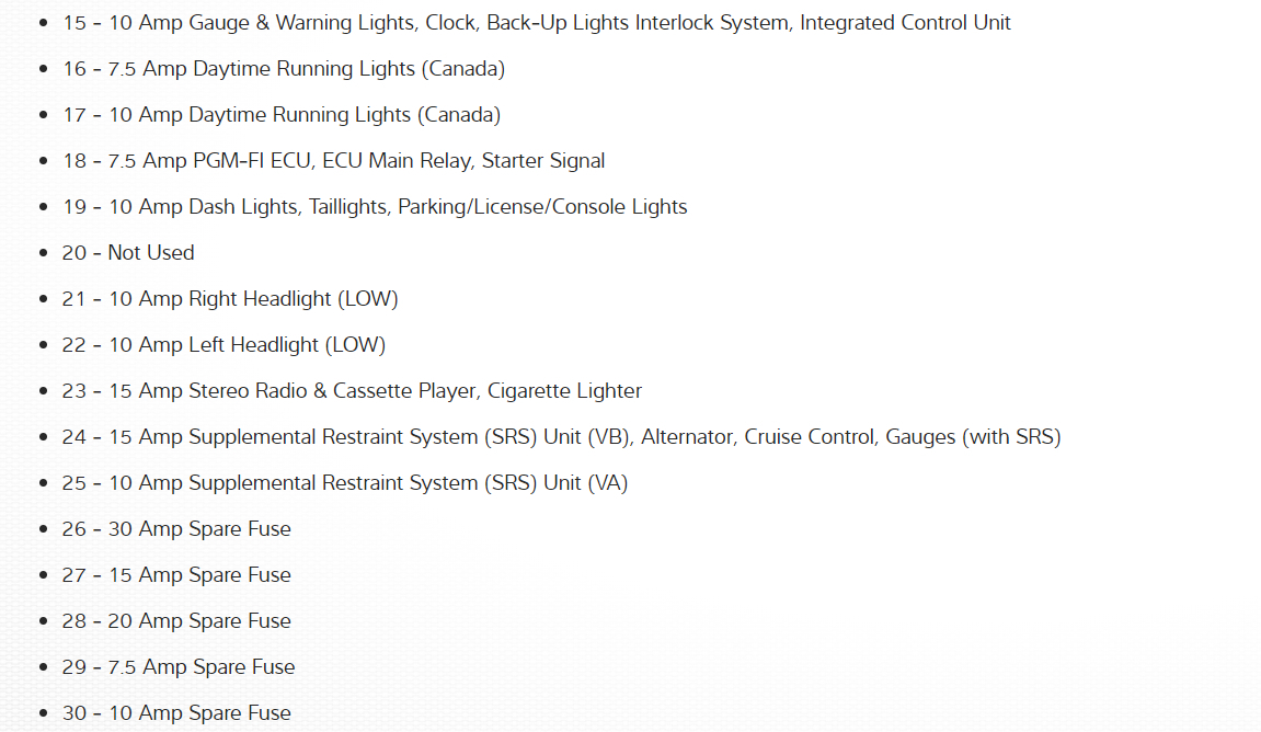

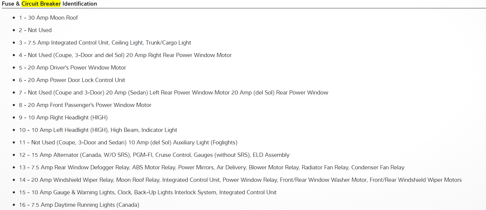

The power door lock fuse in # 51 ( 20 A) in underhood fuse box. The item likely to cause the problem would be the control unit, located at front of driver door, behind the door panel. Here is a guide to help test tit with the fuse location in the diagrams below.
Check out the diagrams (Below). Please let us know what happens.
