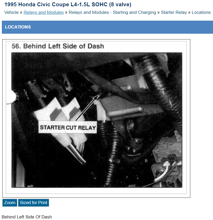

My car will not turn over. I bypassed the starter wire from the starter to a push button switch on the dash. This allowed the car to start. I have power on the starter leg of the ignition switch but not at the starter wire on the solenoid. I believe it is the starter relay or clutch safety switch. Where is the starter relay located? I am 6'6" and getting under the dash is difficult.

The starter relay is located under the dash on the drivers side here is a guide and a diagrams (BELOW)
