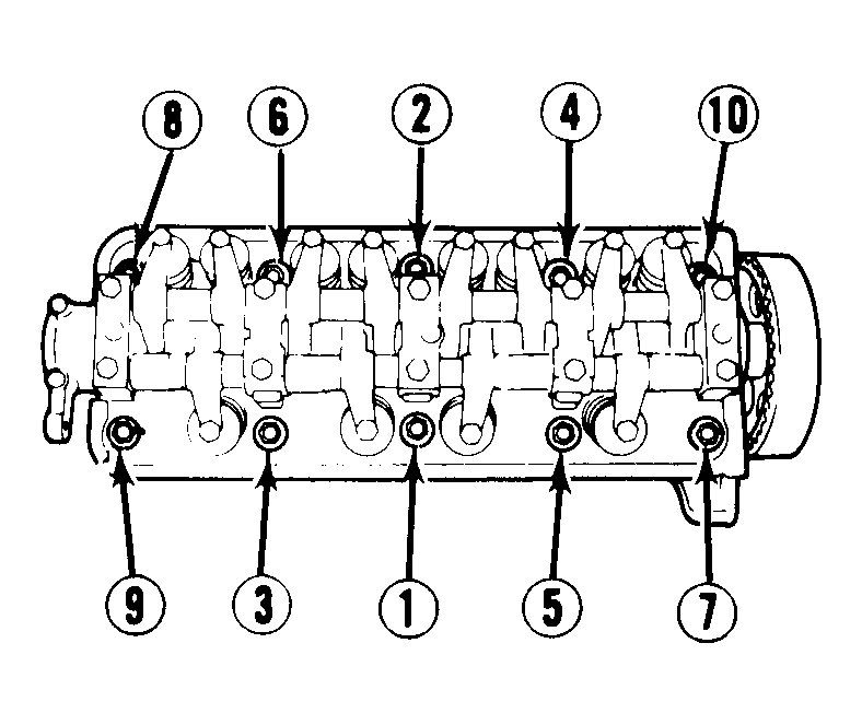

can you tell me the torque specs. on 94 1.5 head bolts and intake manifold?
Dec 3, 2008 at 7:55 PM
BLUELIGHTNIN6
CERTIFIED EXPERT
16,542 POSTS
Great. Thanks for that.
It looks like there are several engines used in the Civic DX. The engine serial number is located on exhaust side of engine block, below cylinder head near bellhousing. The first 5 characters of engine serial number identify engine type. Please take note of your serial number before following instructions below, although the tightening sequence remains the same, the torque specs are different for each engine type in the Civic DX.
Here is a video to help you see how to use a torque wrench.
https://youtu.be/juOClONIWeY
SOHC ENGINES for Civic DX
Cylinder Head Bolt Specs.:
Engine Type D15B7 & D15B8 :
Stage 1 - 22 ft lbs (30 Nm)
Stage 2 - 48 ft lbs (65 Nm)
Engine Type D15Z1 & D16Z6
Stage 2 - 53 ft lbs (73 Nm)
Cylinder Head Bolt Tightening Sequence
Intake Manifold-To-Cylinder Head Nut Specs.:
17 ft lbs (23 Nm)
Cheers

What is the torque sequence for the head bolts, and PSI?

Step one 30 Nm Step two 65 Nm.

CYLINDER HEAD BOLTS TIGHTENING SEQUENCE
Tighten the cylinder head bolts in two steps.
1st step : 30 N·m (3.0 kg-m , 22 Ib-ft)
2nd step:
D16Z6, D15Z1 engines:
73 N·m (7.3 kg-m , 53 Ib-ft)
D15B7, D15B8 engines:
65 N·m (6.5 kg-m , 47 Ib-ft)
