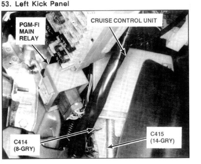

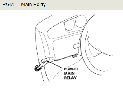

Here is a guide to help you see how to remove the relay
Here is the location the fuel pump relay is called a PGM- FI relay btw.
