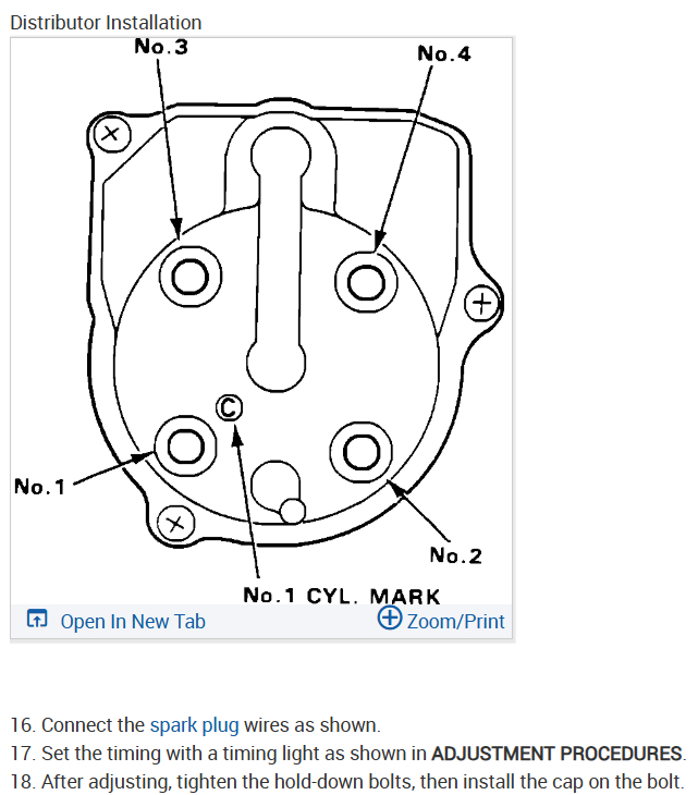

whats the firing order. i mixed the cables up

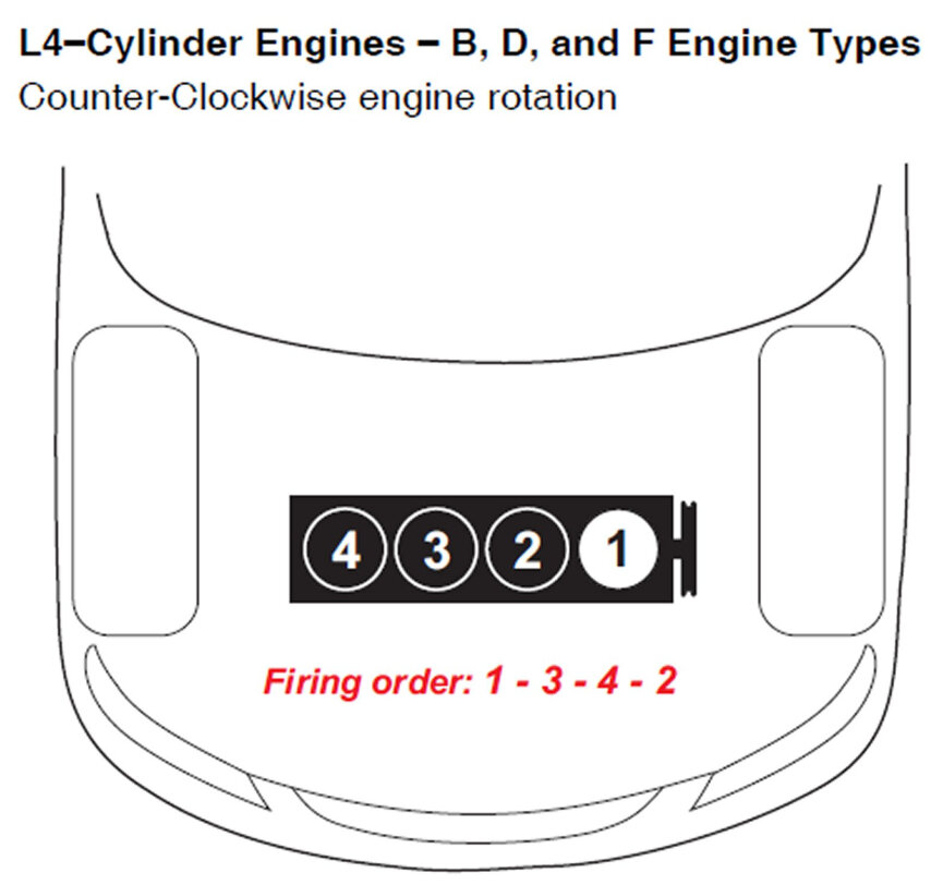

Hi there,
the firing order is 1.3.4.2. No1 on the distributer is looking from the top R/H front terminal at about 5 O"Clock and turning in a clockwise direction.

Here is the firing order and how the spark plug wires go on the distributor cap. Check out the images (below). Let us know if you need anything else.
