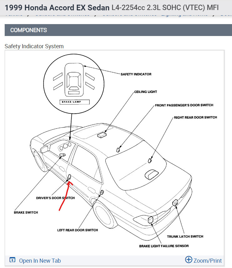

Sounds like a switch problem in the drivers door. Doesn't the lamp point to the door that is causing the problem? It should be a bad door latch or pin switch. Here is how to change the switch out to fix the problem. Check out the images (below). Please let us know what happens.
