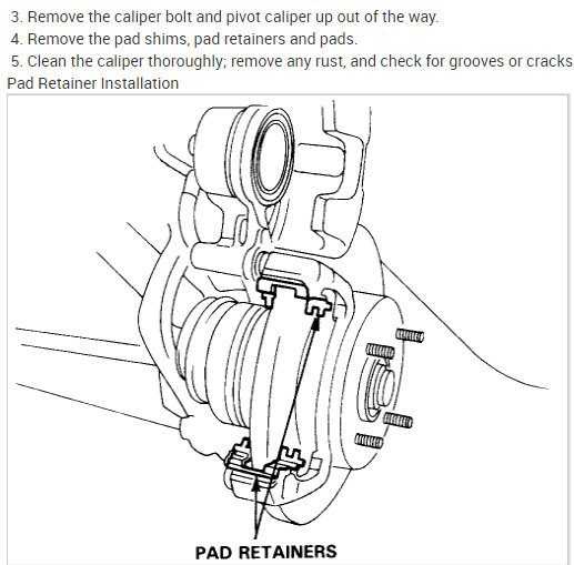

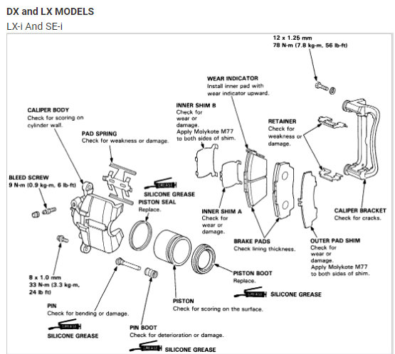

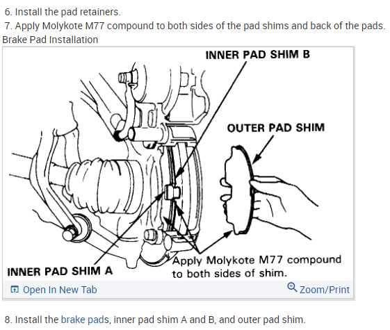

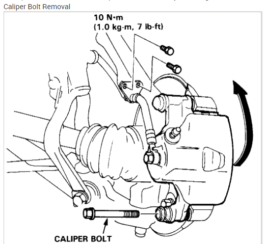

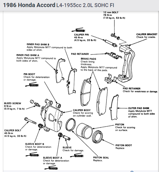

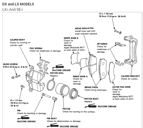

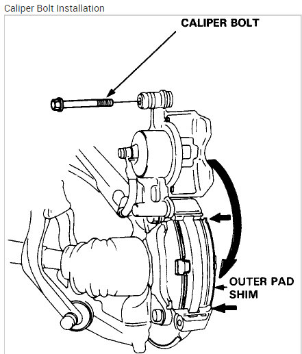

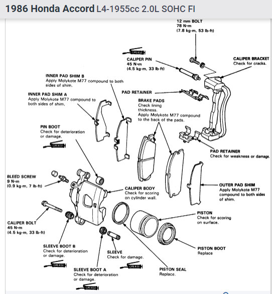

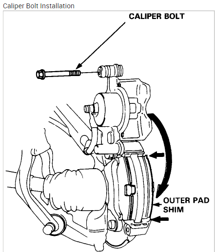

Here is the information you requested. This is a tutorial showing step by step what is involved on how to inspect and change front brake pads and brake rotors:
I've attached picture steps below on how to change the front brake pads and rotors on your car. Hope this helps and thanks for using 2CarPros.
