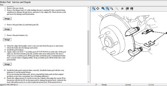

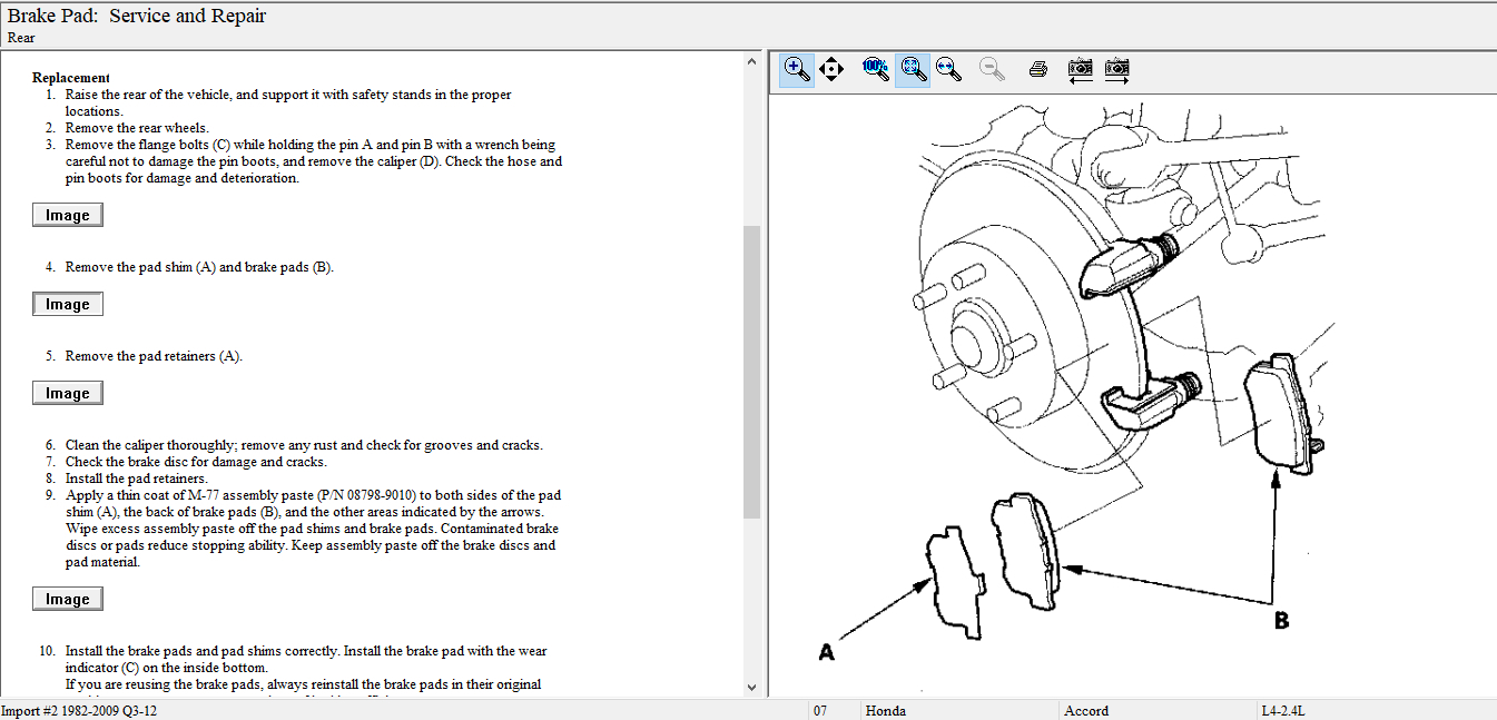

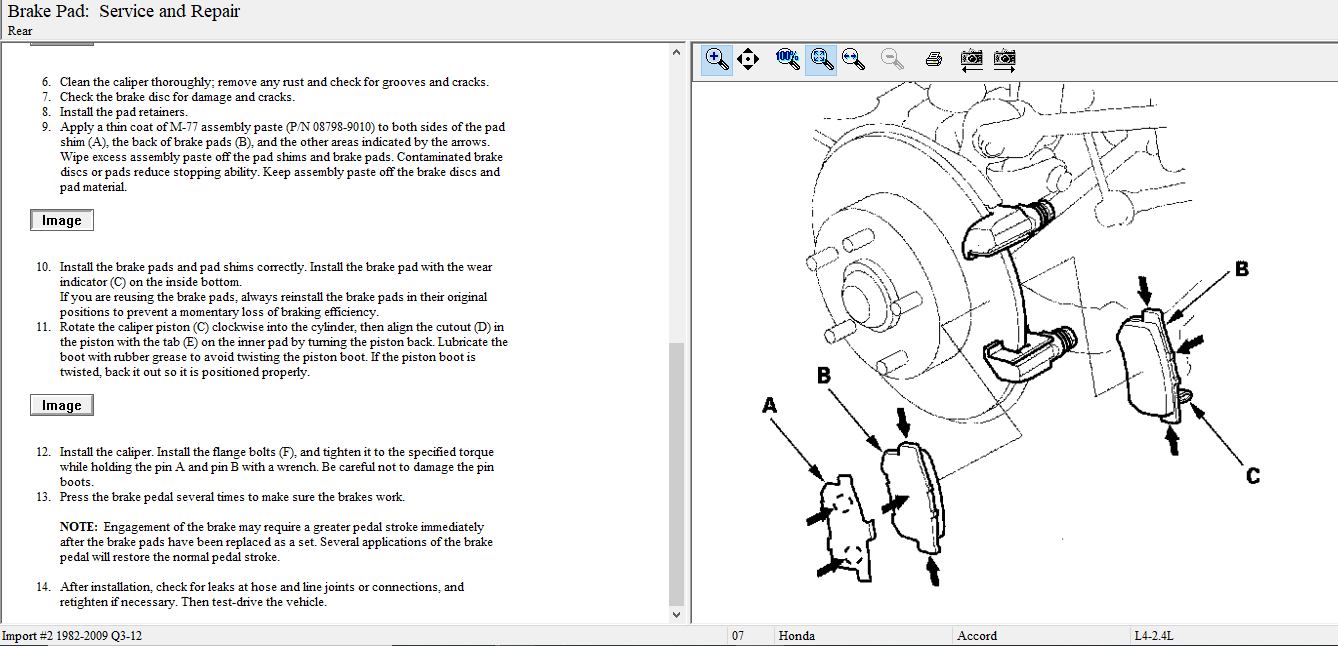

hello,

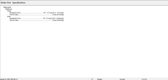

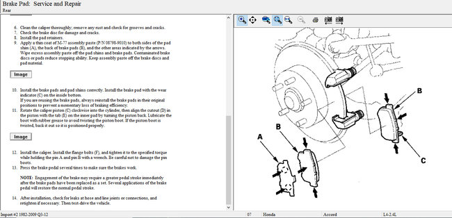

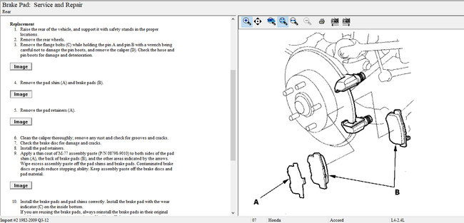

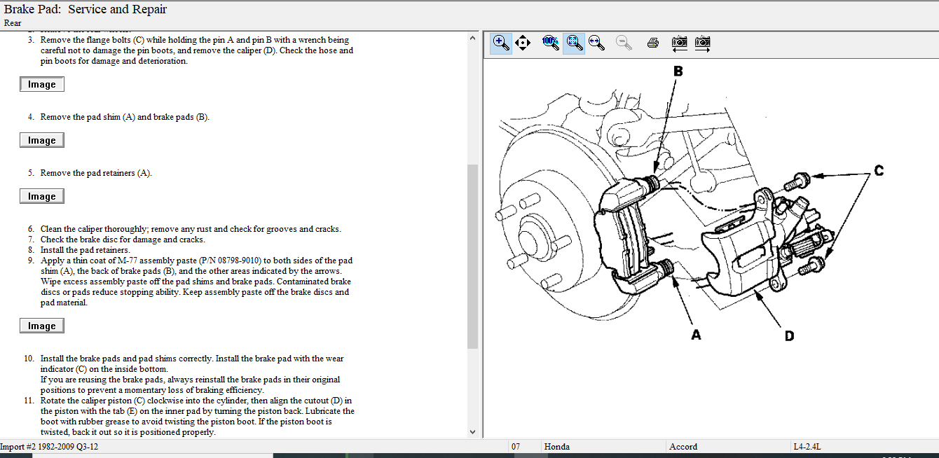

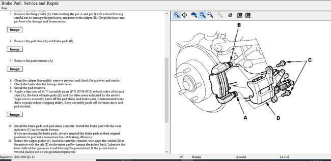

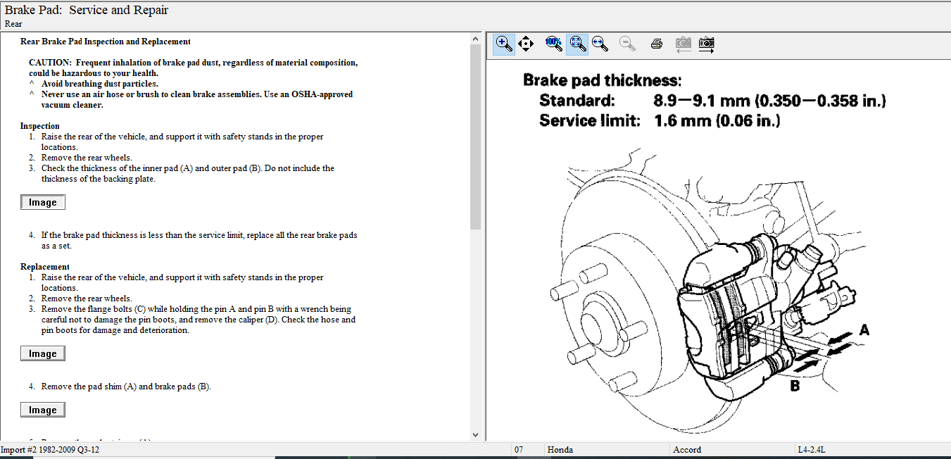

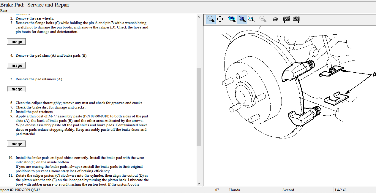

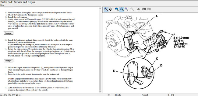

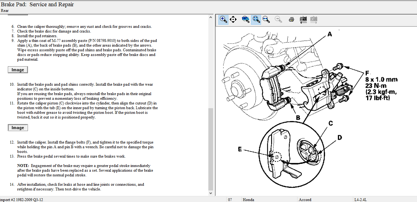

Check our link below how to replace brake pads and rotors
https://www.2carpros.com/articles/how-to-replace-rear-brake-pads-and-rotors

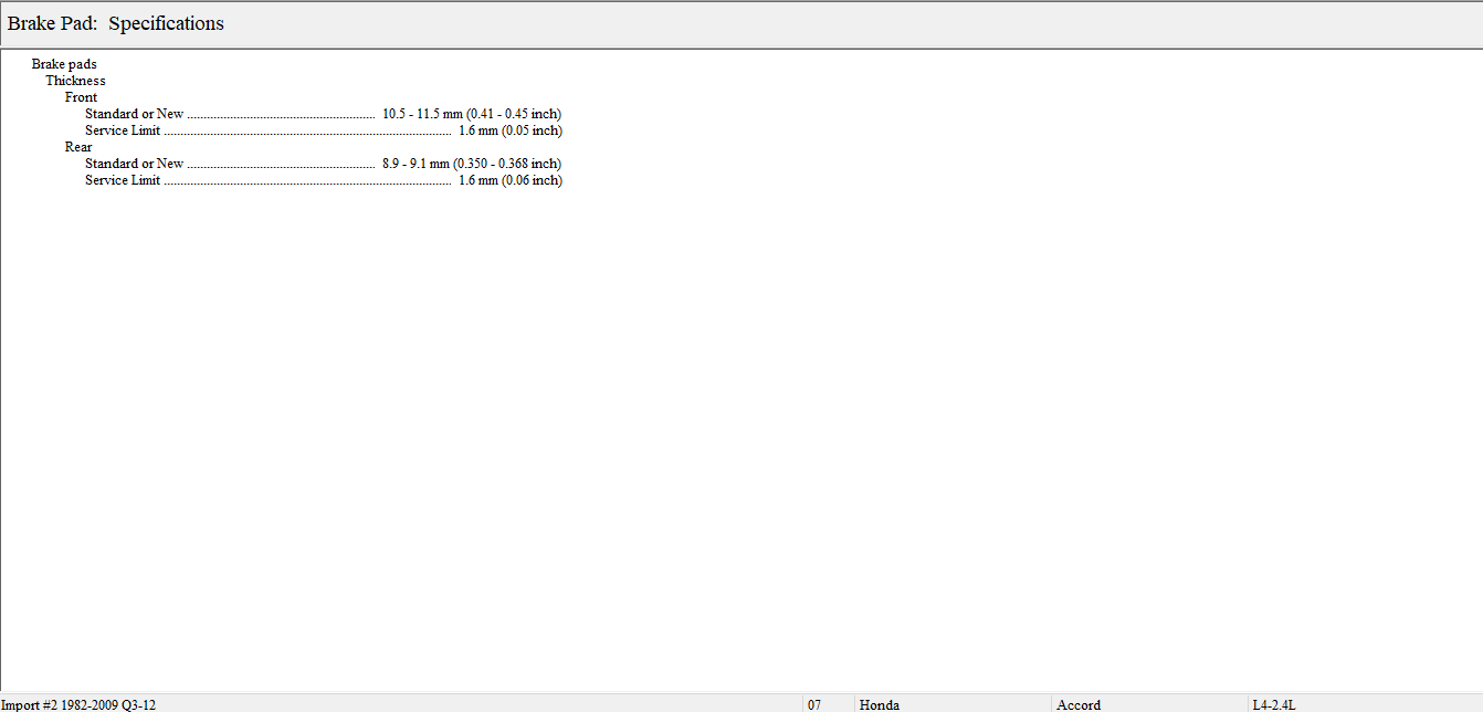

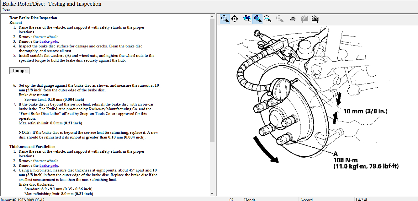

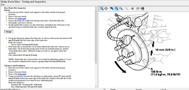

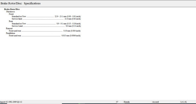

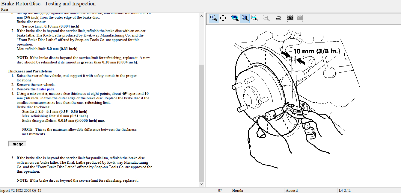

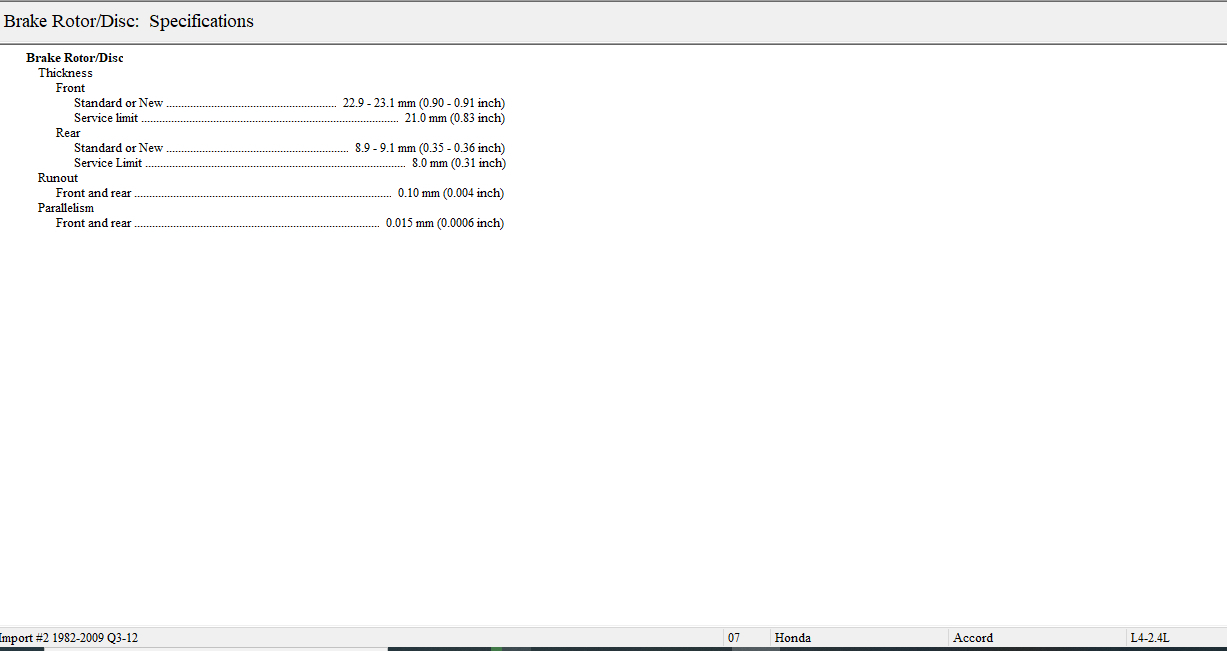

Check the diagrams below how to remove and reinstall brakes with the inspections, check how to measure the rotors lateral run out by using dial indicator, and rotors thickness by using micrometer and compare with the specification tables.
let us know if you need more help thank you.
