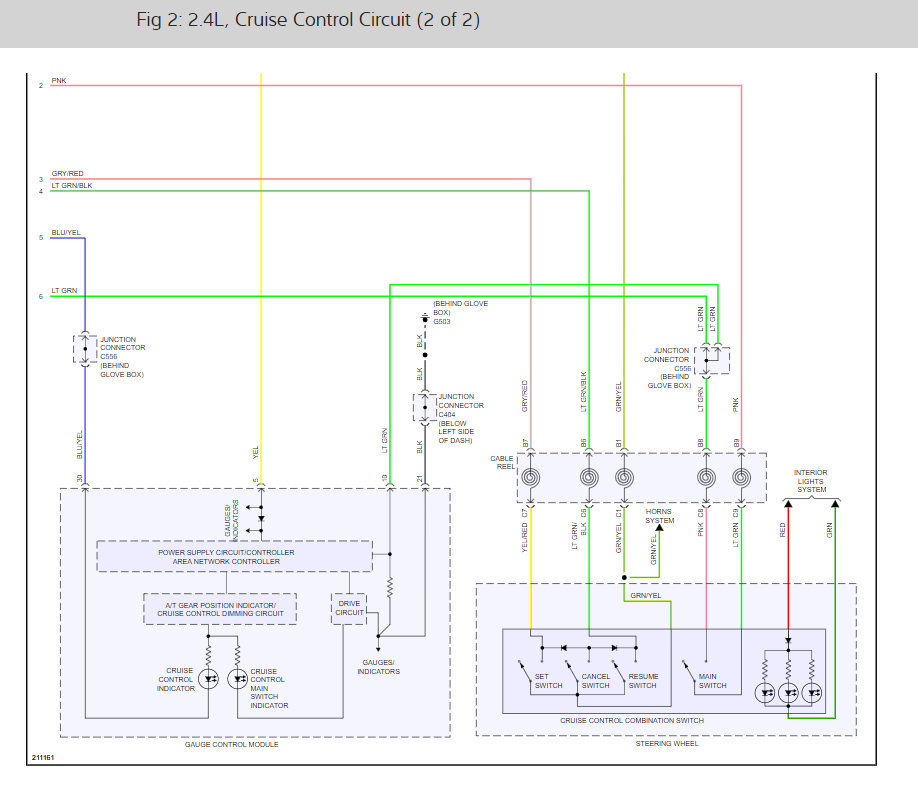

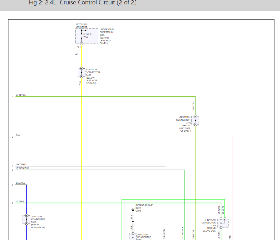

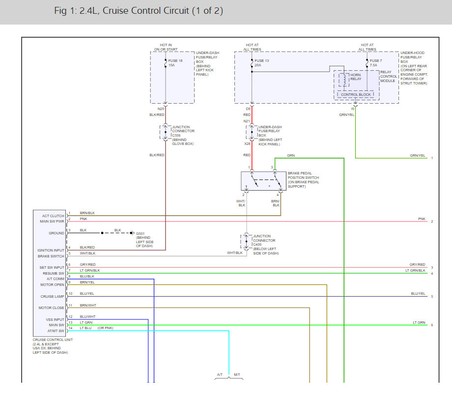

Hi rah140,

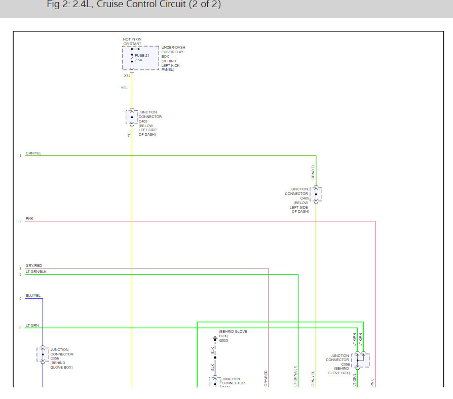

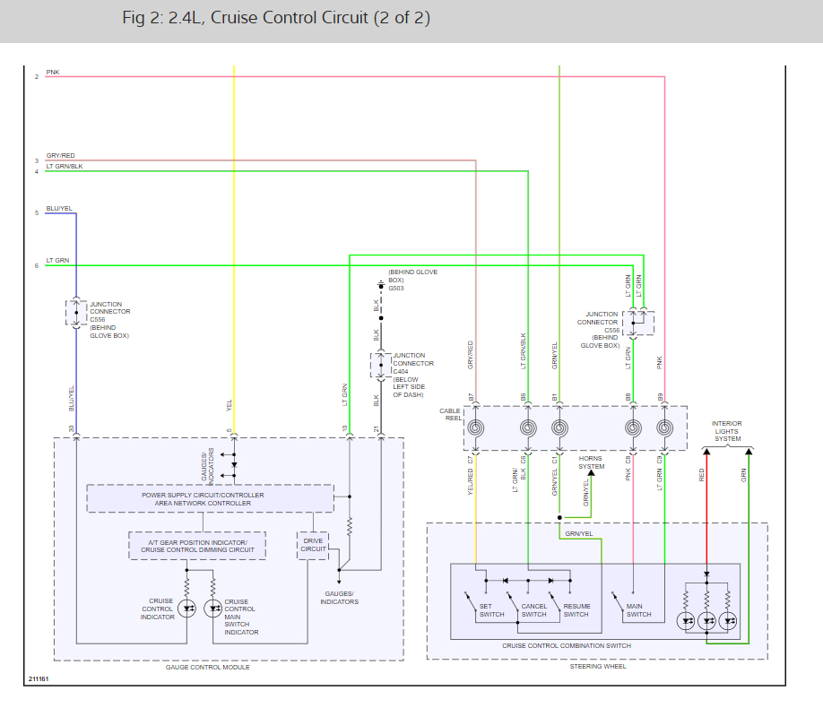

Nine times out of ten its the clock spring behind the steering wheel shorting out but to be sure here is the cruise control wiring diagrams so you can see how the system works and a guide to help you test the connections.
To perform a simple test, when problem occurs and you are not able to set the cruise control, use your left foot to lift the brake pedal and if it works, the brake switch is out of adjustment. They call the clock spring the cable unit FYI.

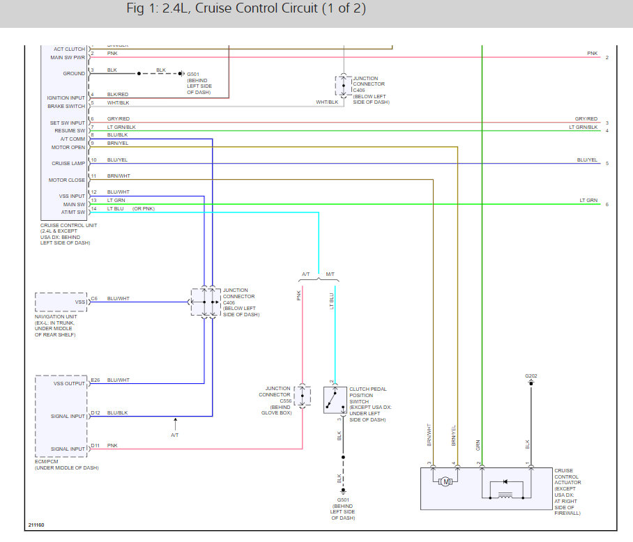

BLUELIGHTNIN6
  • 16,542 POSTS
The vehicle speed sensor is located on top of the transaxle. If the vehicle is equipped with a tachometer, then it will be ran by the speed sensor as well. Diagram of wires from the speed sensor is below. I have highlighted the appropriate wires for your convenience. NOTE: The blue wire continues on to the PCM off screen.

BLUELIGHTNIN6
  • 16,542 POSTS
My apologies. I have found and posted the VSS wire for you located inside of cab. It is located under the middle of the dash at the PCM. The tachometer signal wire (yellow/green) will be located behind the instrument cluster or in left hand side of steering column. When hooking up a cruise control system, the tach is usually not required for the cruise control to work, it is just a safety feature. If the engine RPM's reach a certain rate (usually at or above 4000) the cruise control will disengage preventing any possible harm to the engine.

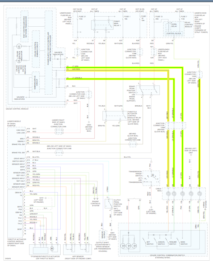

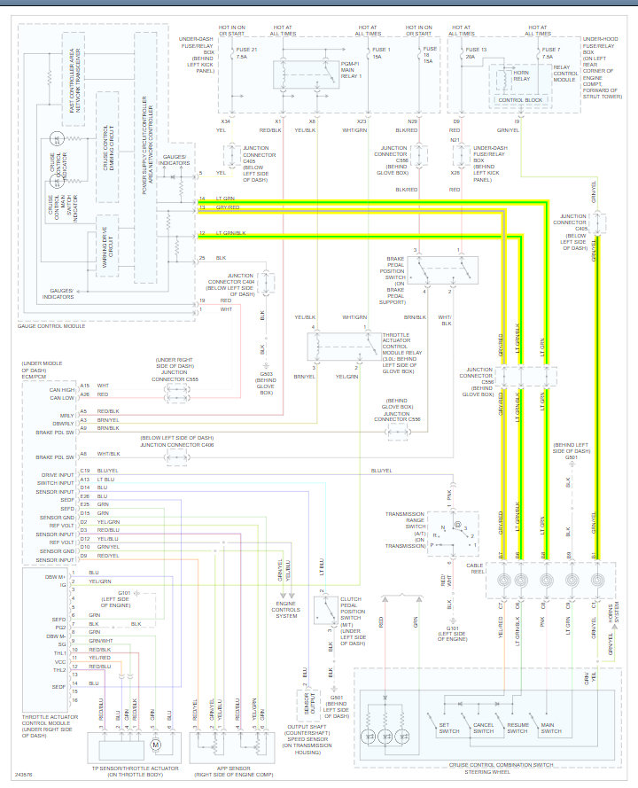

If your clock spring has been changed then we need to find a little more detail out about what your cruise is doing. When you press the buttons, do any of the lights come on that show the cruise is on? Does it just not engage the cruise?
Basically we need to know if you are getting voltage from the buttons to the gauge control module. The way this works, is the buttons tell this module that you have pressed the button and it then sends the correct signal to the throttle control actuator.
We are going to have to track voltage through the system and find out where we are losing it.
The issue is you are not going to be able to track voltage from the gauge module to the throttle module as that is what is called a bus network and it sends coded messages to tell it what to do. Here is a guide that talks about this:
https://www.2carpros.com/articles/can-scan-controller-area-network-easy
Let us know if you have voltage at the gauge module on the circuits highlighted below and we can go from there. Or if the cruise indicator is working then we can make an assumption at this point that this is working.
