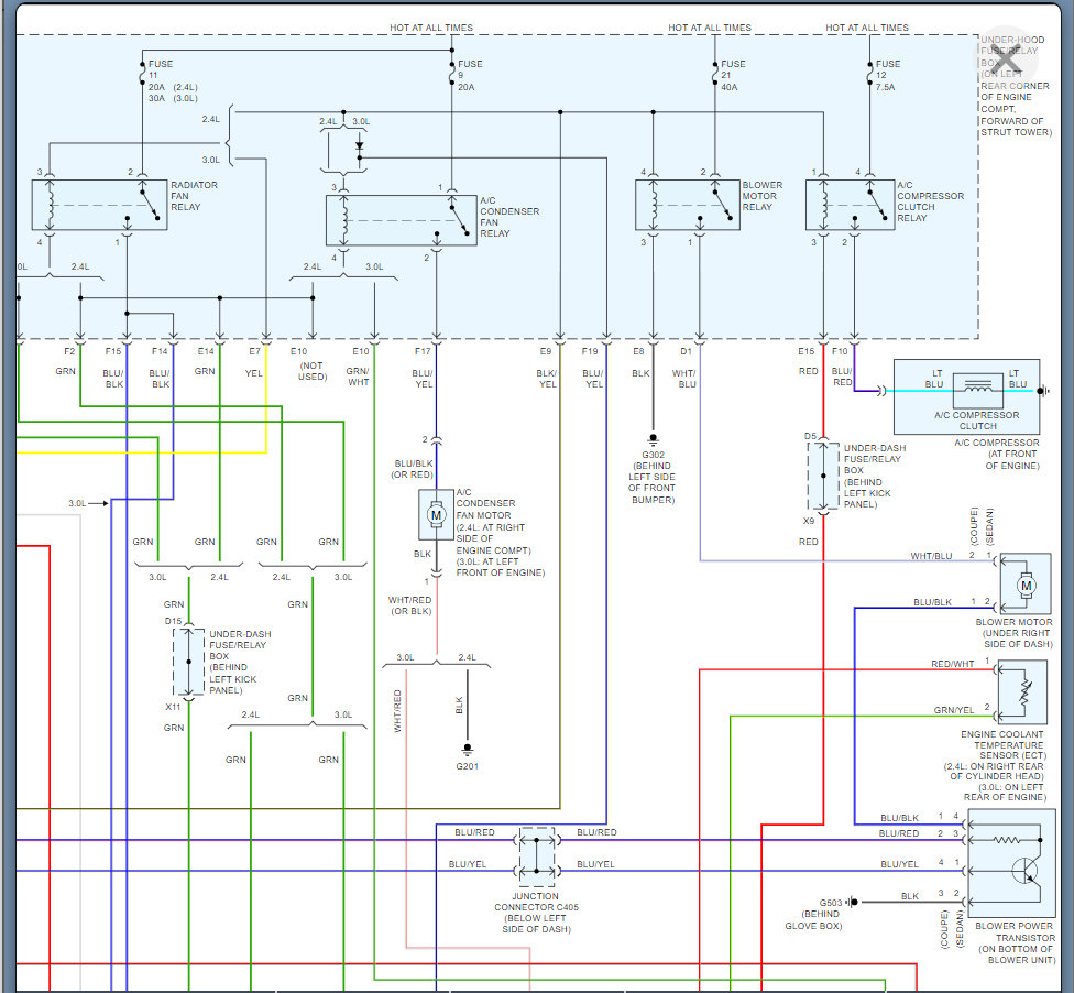

No air is coming out of any of the vents. It doesn't matter if the heat, air or defrost is on nothing comes out. We have checked the blower motor and resistors, fuses but still does not work. Any suggestions? I do not have a lot of money and I really need to fix this. Thank you
