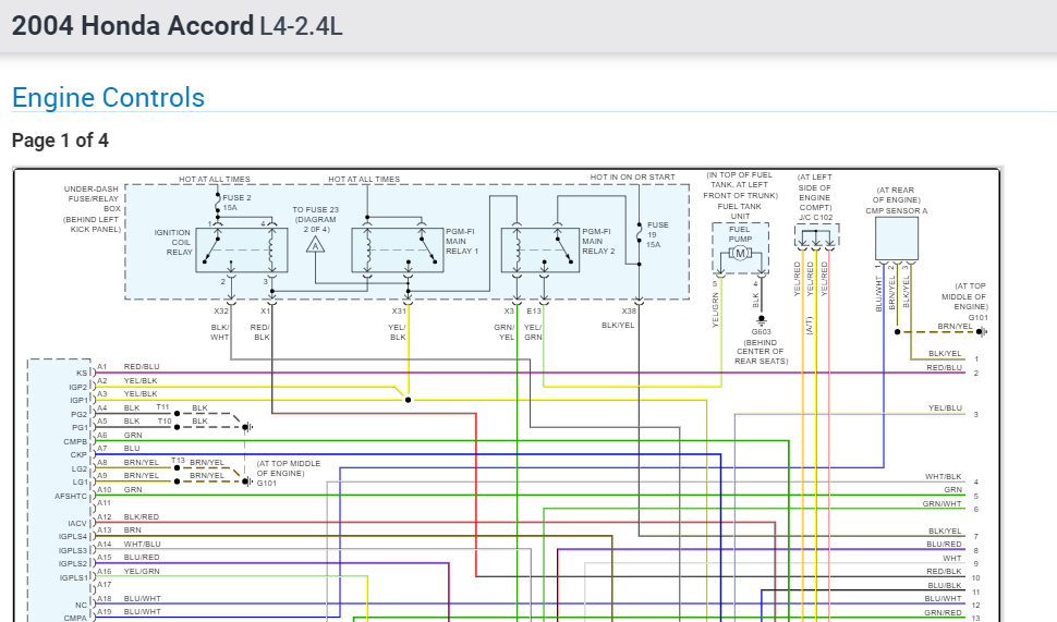

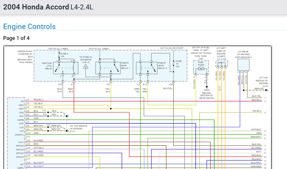

Do you have an image because I don't see the switch in the fuel pump wiring diagrams. Check out the images (below). Please let us know how it goes.
