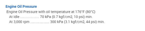

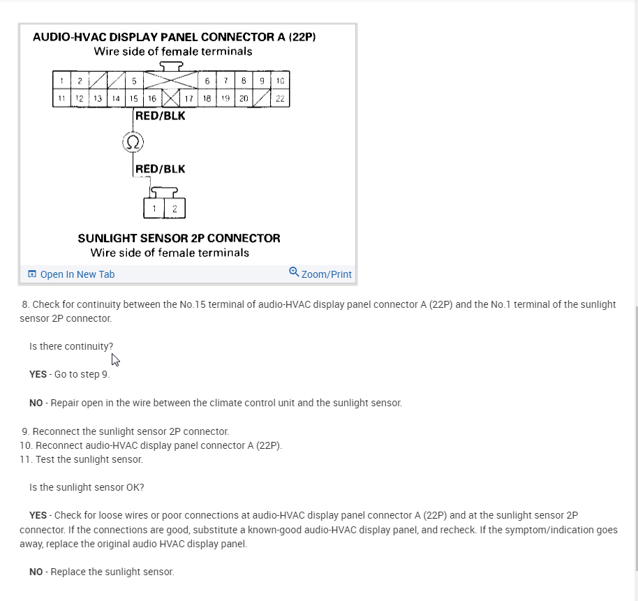

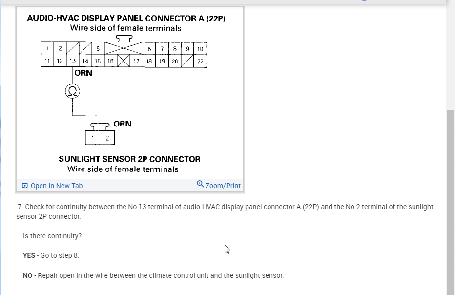

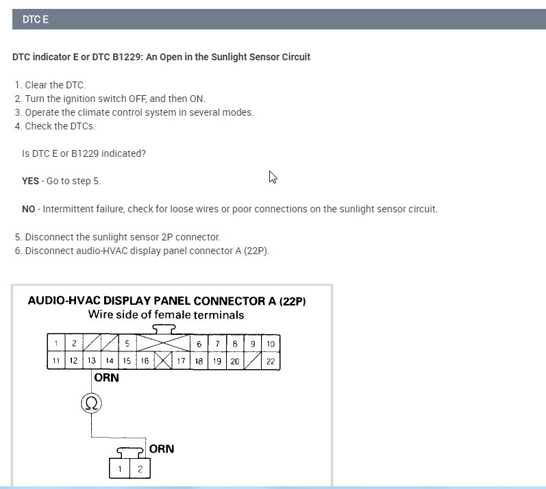

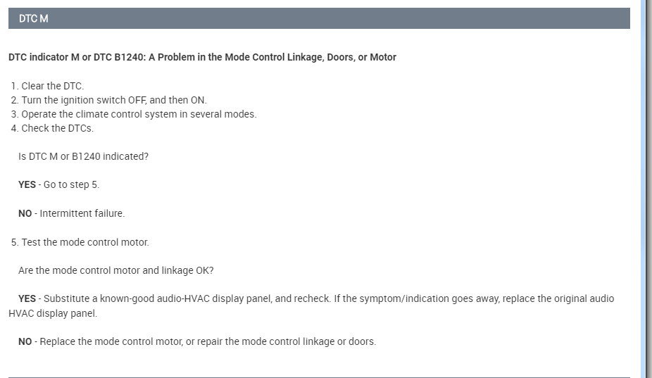

This sounds like we have a number of different issues. The oil light is due to lower oil pressure and the battery light is due to lower battery voltage. They are not necessarily related. The codes that you got are all for the HVAC system so again, not related to the other issues.
I would suggest with starting with the oil pressure light as that is the most crucial. We need to hook up an oil pressure gauge and see what the actual pressure is. If it is low then we need to suspect the oil pump or possible larger engine issues. If it is not then there is a sensor issue. Not as crucial but still something you need to address. After that, you will need to have the battery and alternator tested to find out why you have low voltage.
