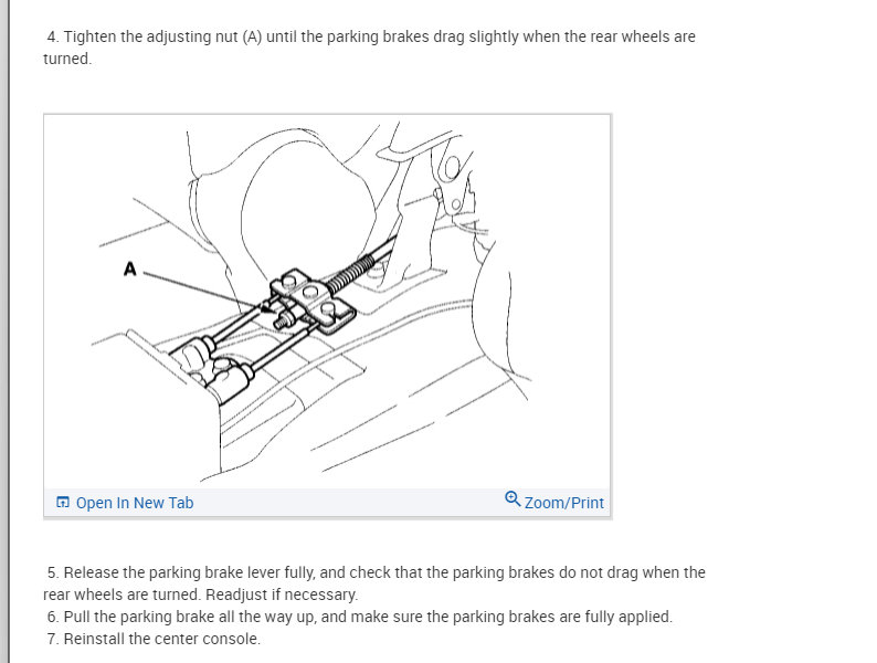

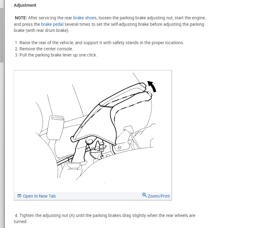

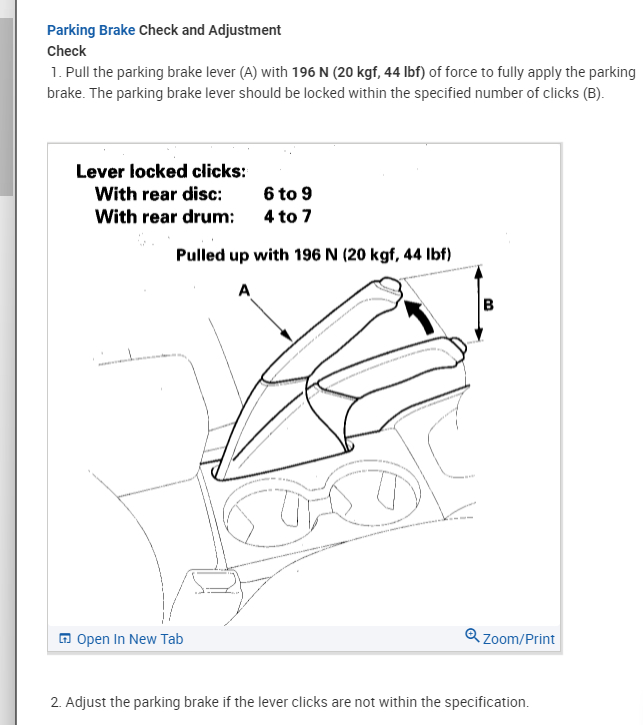

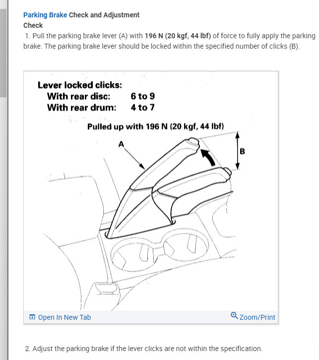

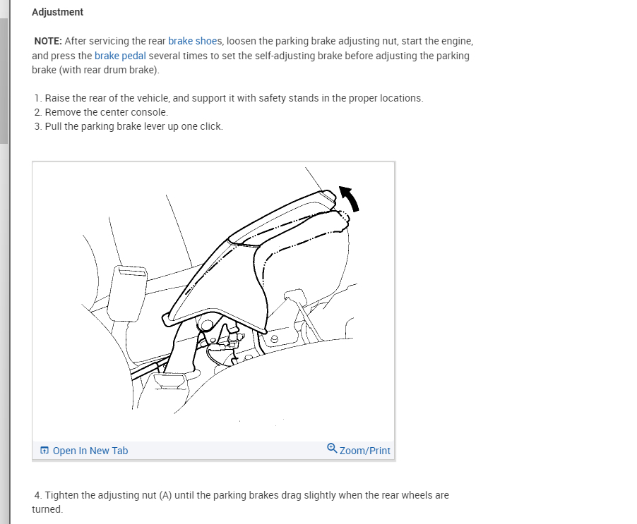

Here are a couple guides that will help with replacing the rear braking system and adjusting the parking brake:
https://www.2carpros.com/articles/how-to-replace-rear-brake-pads-and-rotors
https://www.2carpros.com/articles/parking-brake-shoe-replacement
I would suggest making sure this vehicle gets driven at least once per week and put it through some pretty good braking to make sure the rust is knocked off the rotors.
Please see below for more info on this.
