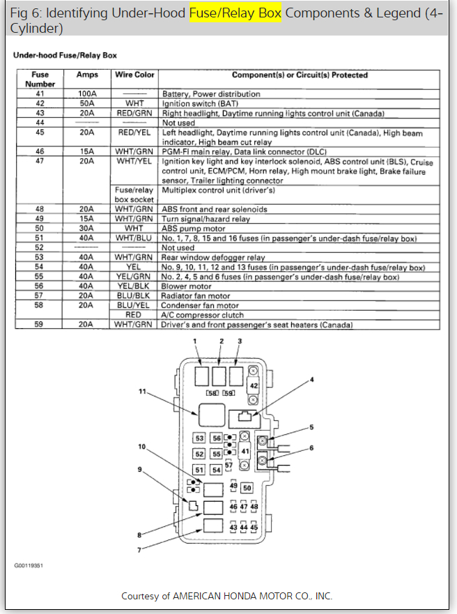

I bought both bulbs, replaced clock bulb. Upon turning it 1/4 turn to secure it, a wisp of smoke appeared and entire instrument panel and power windows failed, along with not being able to shift out of park. Car still started OK, but couldn't drive.
I found some help regarding fuse replacement, followed it, and everything went back to normal.

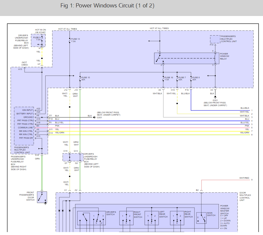

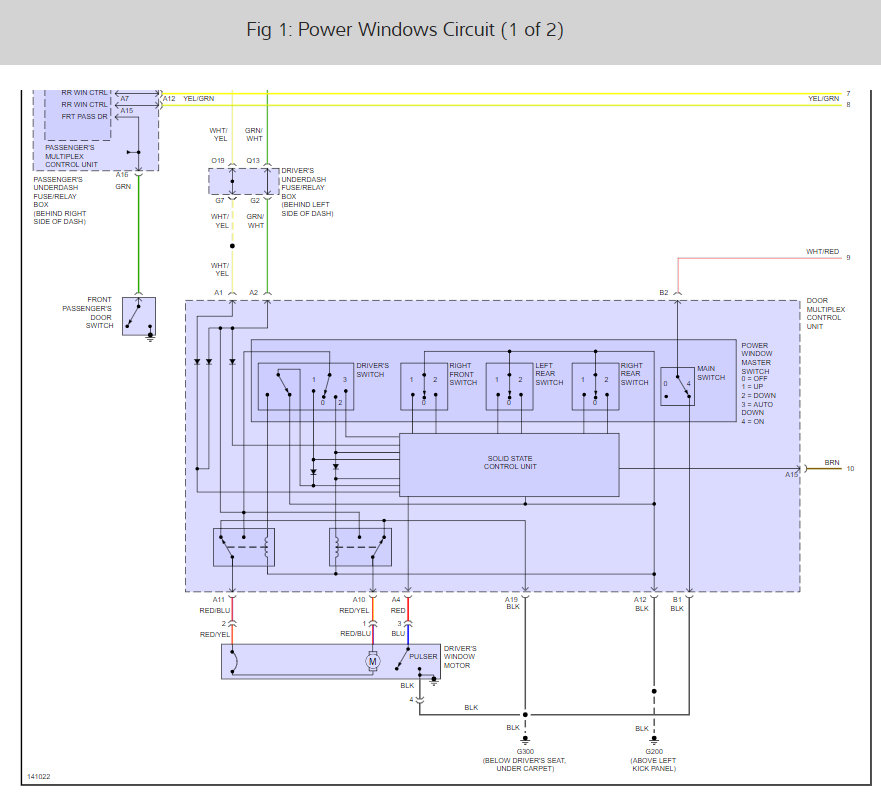

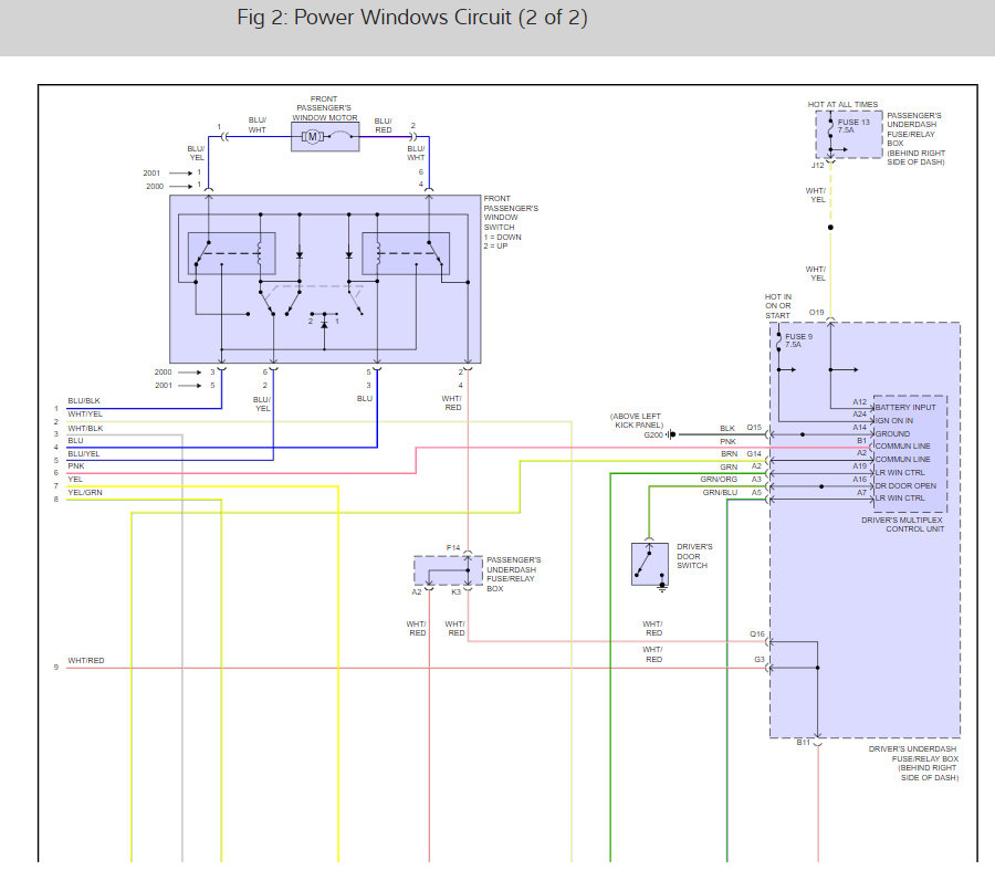

Then I needed to replace the battery, and since replacing it, now only the driver's door power window goes up/down, whether using driver's control or individual door control switch.
1. What would cause the replacement of the bulb to blow a fuse?
2. Could this be related to the power window issue, or would that more likely be from the battery replacement?
I have not tried to replace the clock bulb again (I re-inserted the old bulb when it smoked) and I never attempted to replace the odometer/trip meter bulb since this happened.
Sep 26, 2018 at 9:33 AM

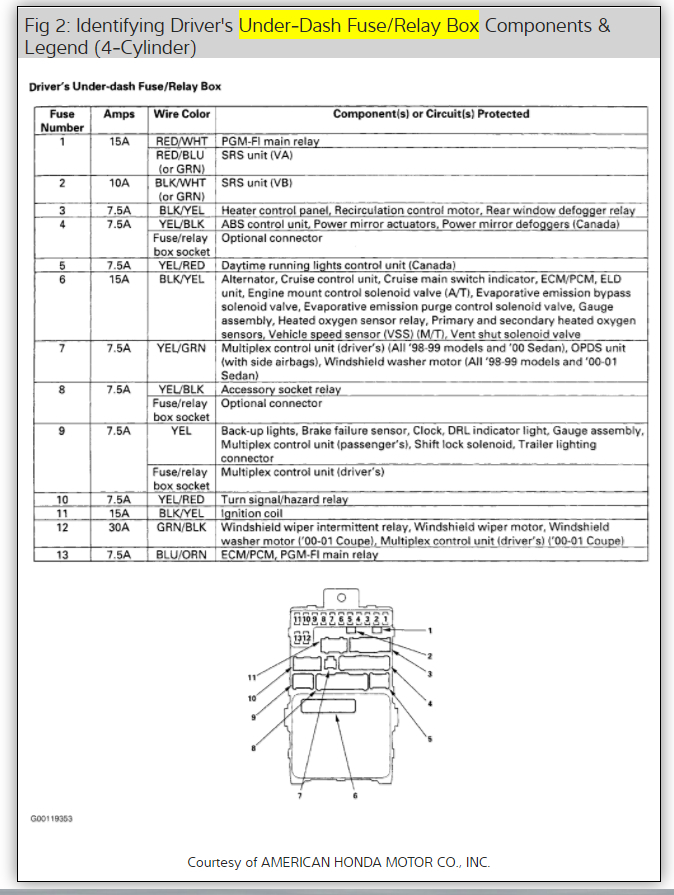

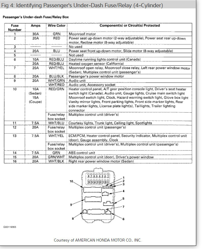

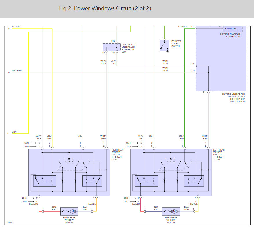

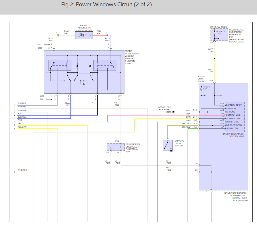

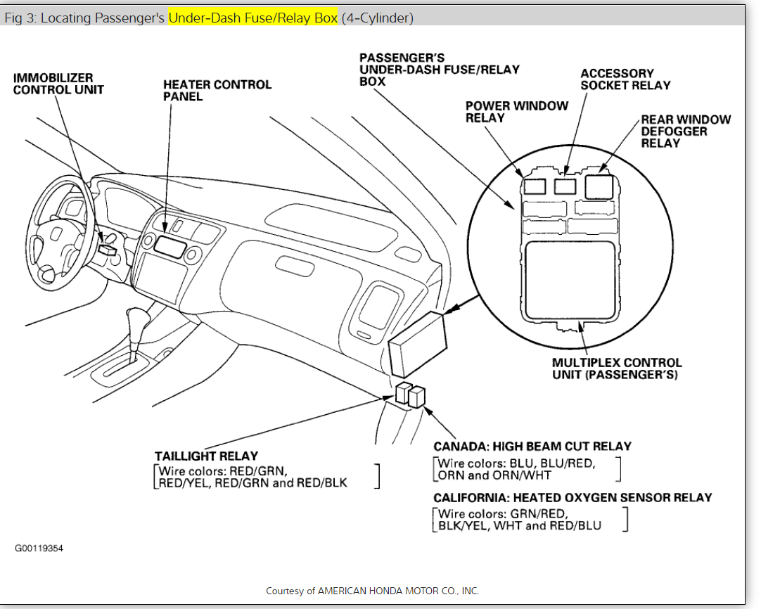

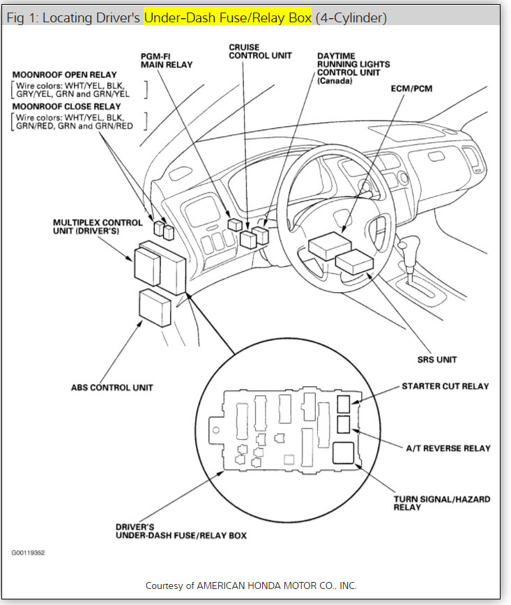

If the battery is connected while you replace the bulb it can blow the fuse because you connect power and ground when removing the socket. It sounds like the drivers side multiplex unit might be out. We are losing power somewhere. Here is a guide to help you check for power and the window wiring diagrams so you can see how the system works. There are several fuses that run the system.

Bulb blowing the fuse has not been resolved yet, but the power window issue has. Turns out my fifteen year old daughter had engaged the childproof switch inadvertently.
