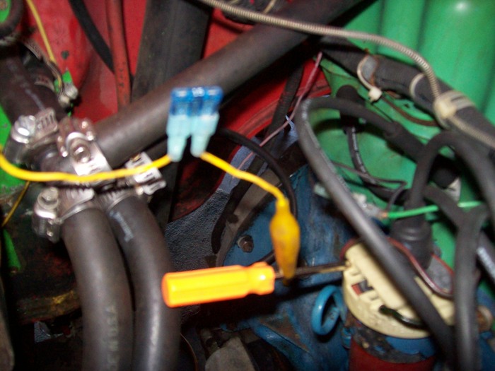

See below
https://www.2carpros.com/forum/automotive_pictures/12900_ect_4.jpg
