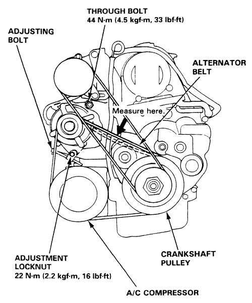

Fig. Accessory drive belt routing-2.2L and 2.3L engines without A/C

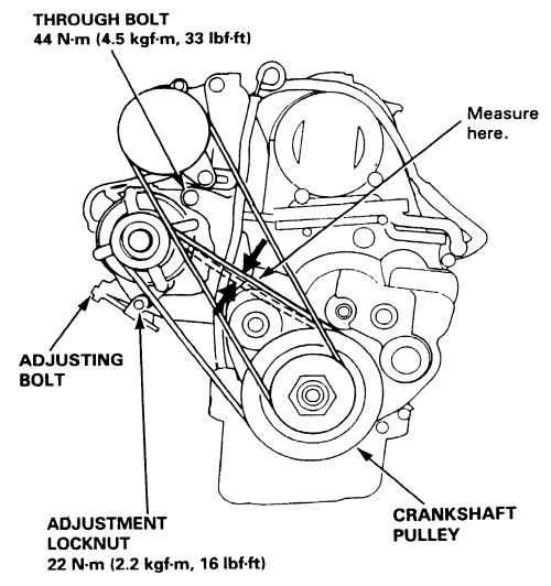

Fig. Accessory drive belt routing-2.2L and 2.3L engines with A/C

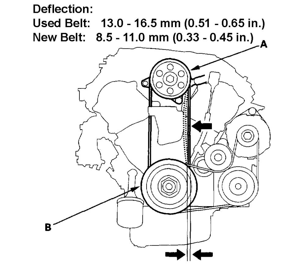

Fig. Accessory drive belt routing-2.7L engines
If a belt must be replaced, the driven unit or idler pulley must be loosened and moved to its extreme loosest position, generally by moving it toward the center of the engine. After removing the old belt, check the pulleys for dirt or built-up material, which could affect belt contact. Carefully install the new belt, remembering that it is new and unused; it may appear to be just a little too small to fit over the pulley flanges. Fit the belt over the largest pulley (usually the crankshaft pulley at the bottom center of the engine) first, then work on the smaller one(s). Gentle pressure in the direction of rotation is helpful. Some belts run around a third, or idler pulley, which acts as an additional pivot in the belt's path. It may be possible to loosen the idler pulley as well as the main component, making the job much easier. Depending on which belt(s) being changed, it may be necessary to loosen or remove other interfering belts to access the being replaced.
When buying replacement belts, remember that the fit is critical according to the length of the belt ("diameter") and the width of the belt. The belt shape should match the shape of the pulley exactly. Belts that are not an exact match can cause noise, slippage and premature failure.
After the new belt is installed, draw tension on it by moving the driven unit or idler pulley away from the engine and tighten its mounting bolts. This is sometimes a three or four-handed job; and an assistant could be helpful. Make sure that all the bolts that have been loosened are retightened and that any other loosened belts have the correct tension. A new belt can be expected to stretch a bit after installation, so be prepared to readjust the new belt, if needed, within the first two hundred miles of use.
