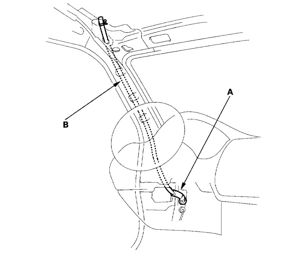

The leak could be coming from the moon roof drain hose, remove the driver's side kick panel (Plastic cover by your left foot, under dash) to inspect the drain hose and the drain valve connection. The drain hose should be connected to the drain valve.
Attached below is a drawing of where the drain goes
