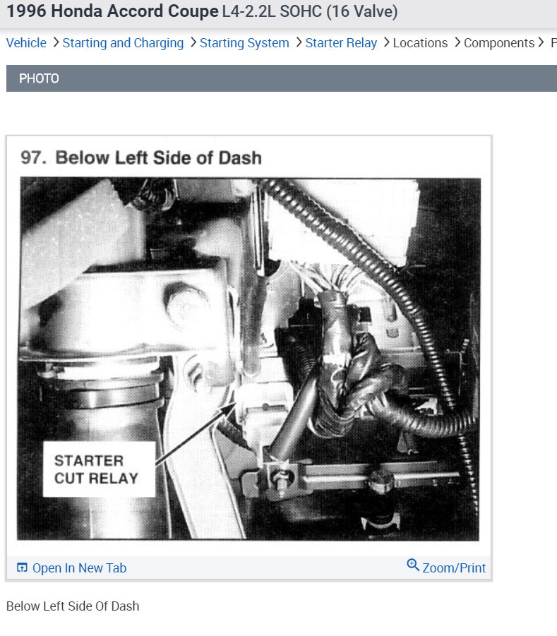

It sounds like the starter relay is not working right here is a guide to help and the starter relay location as well in the diagrams below.
Check out the diagrams (Below). Please let us know what you find. We are interested to see what it is.

Starter Cut Relay (M/T).......Under dash, left side of center console. See Fig. 2 . I don't have a part # but if you remove the old relay it will have part # on it ? check/replace the relay first and let me know ?
https://www.2carpros.com/forum/automotive_pictures/266999_cut2_1.jpg
