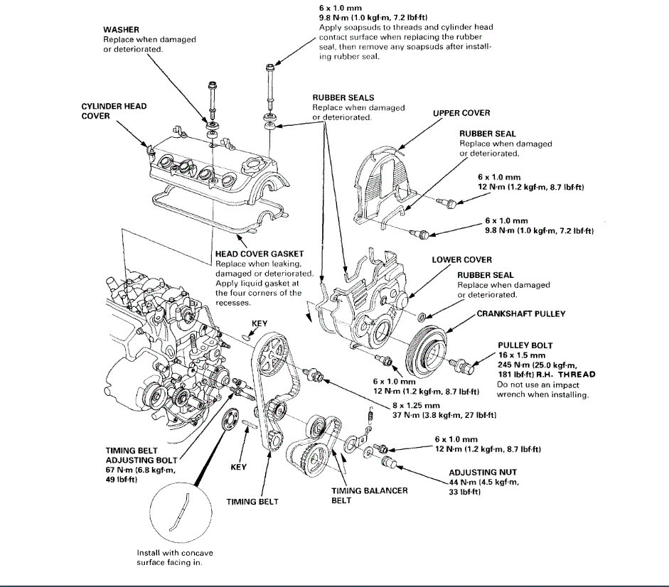

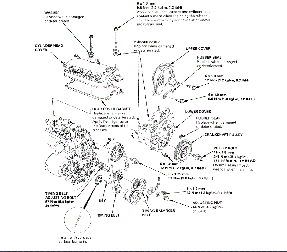

I attached an exploded view of the top end of the engine. See if there is anything you may have missed. I have to ask. Has the valve cover gasket been replaced? Is the leak coming from the top of the engine and running down on the transmission?
