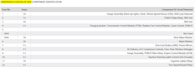

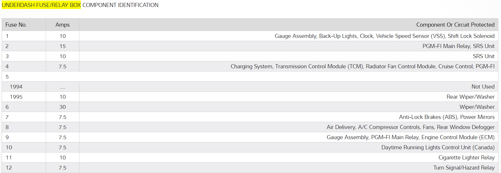

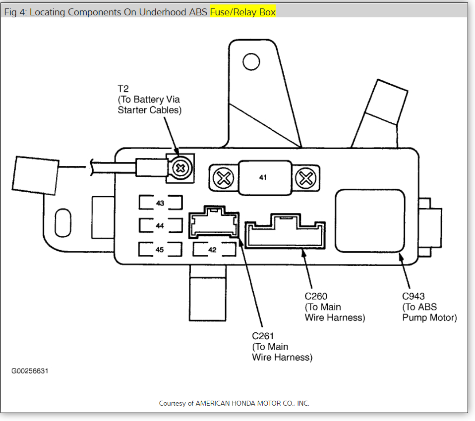

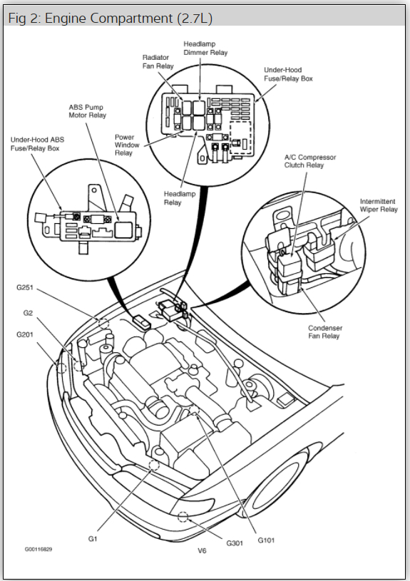

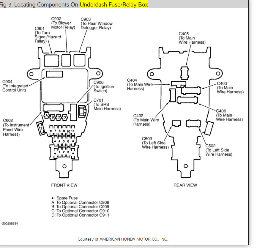

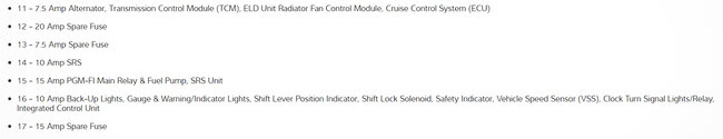

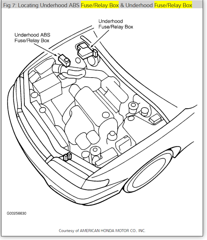

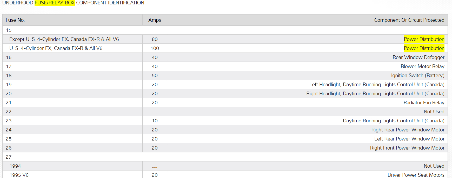

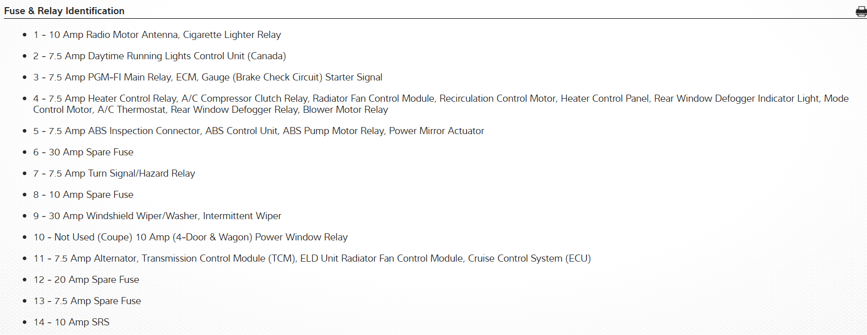

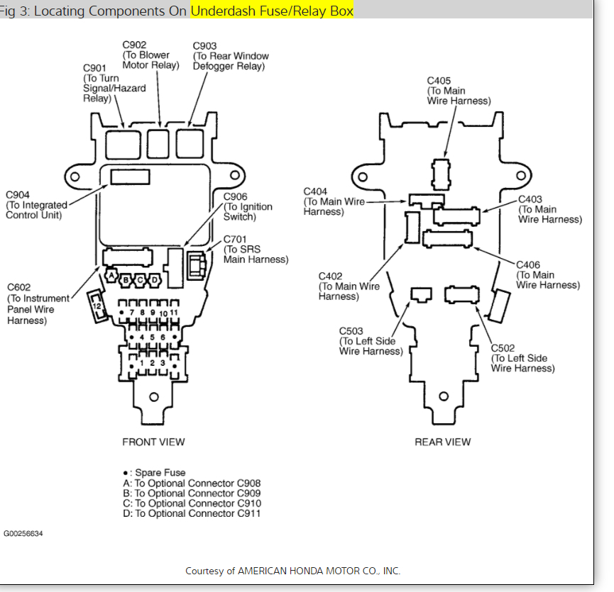

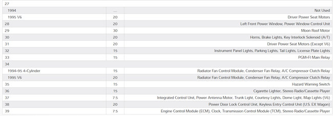

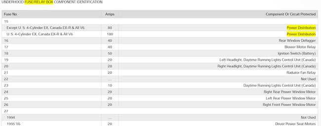

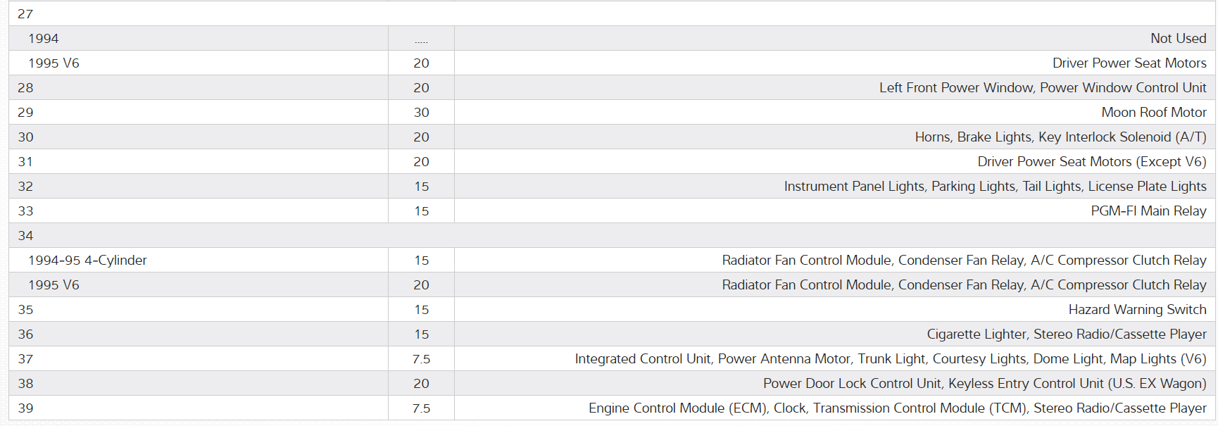

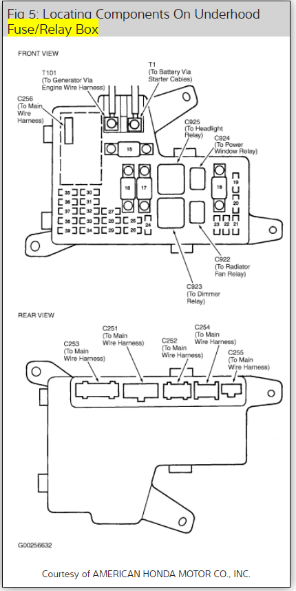

Please check fuse no. 32 and 30 both 15 amp it powers the headlight switch and then to the tail lights. Here is a guide to help you test for power and the fuse locations and descriptions below:
