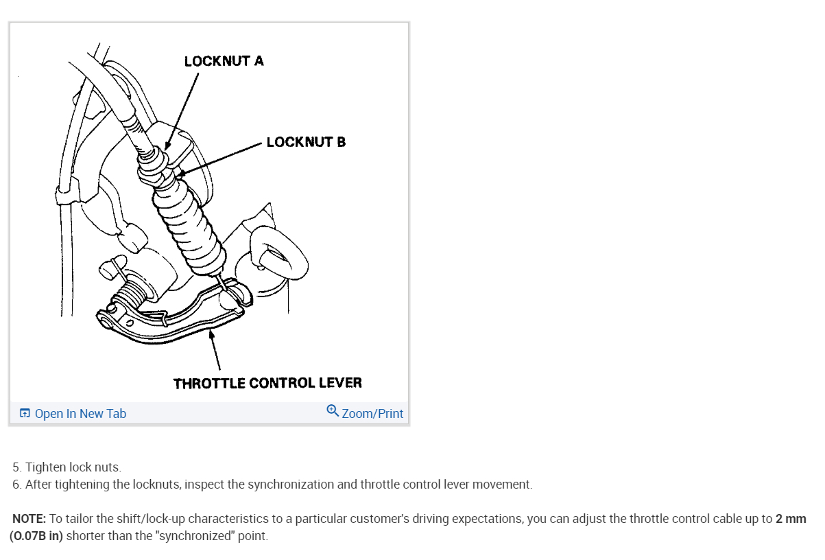

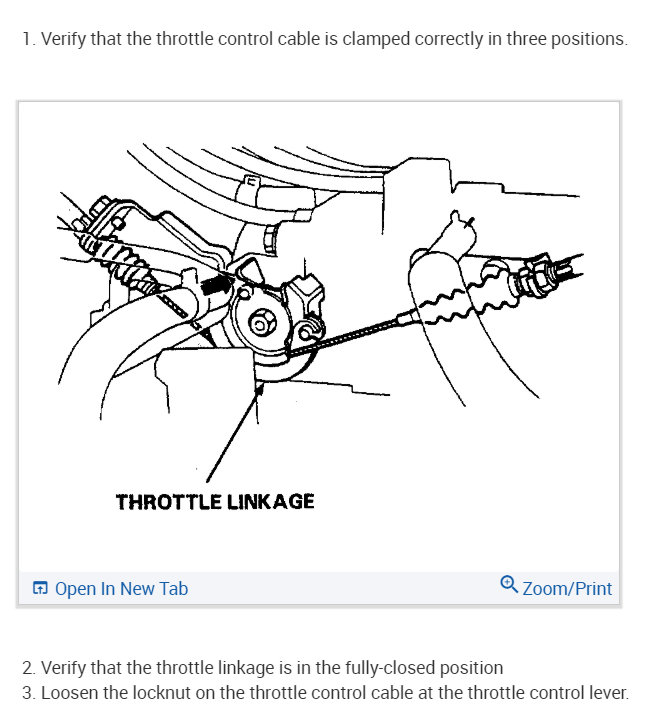

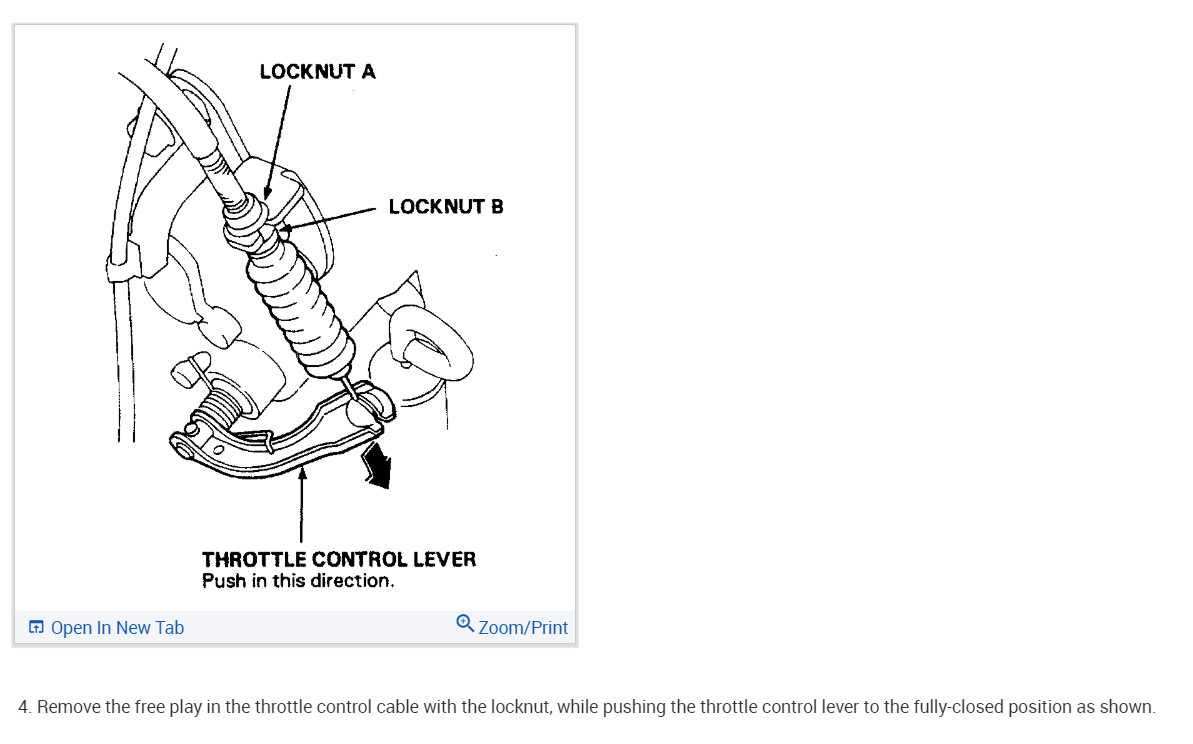

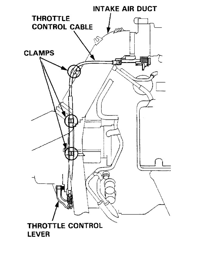

Here is how to adjust the throttle pressure cable which tells the transmission how much throttle you are giving it. Check out the diagrams (below). Please let us know if you need anything else to get the problem fixed.
