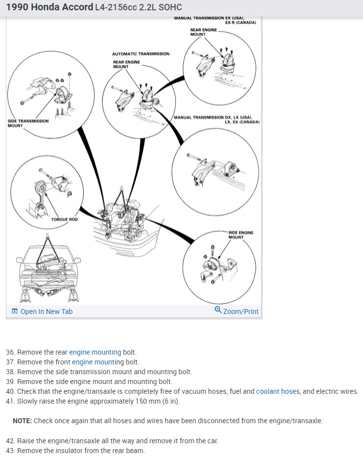

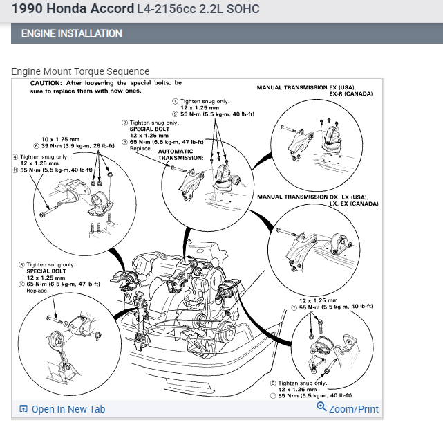

You might run into modifying the motor mounts as they are different.
Keep in mind, this type of swap sometimes requires modifications to components and not a direct swap/replacement.

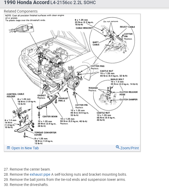

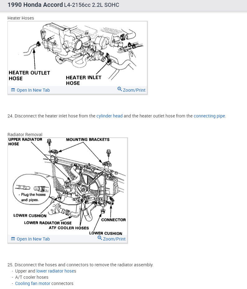

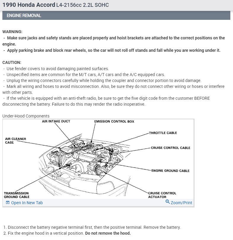

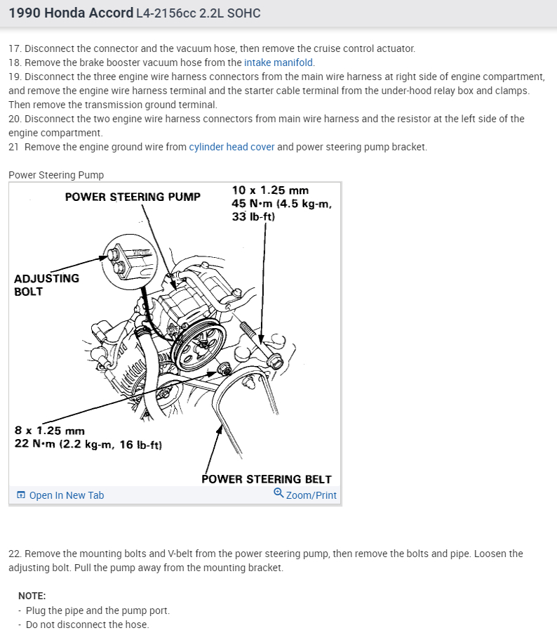

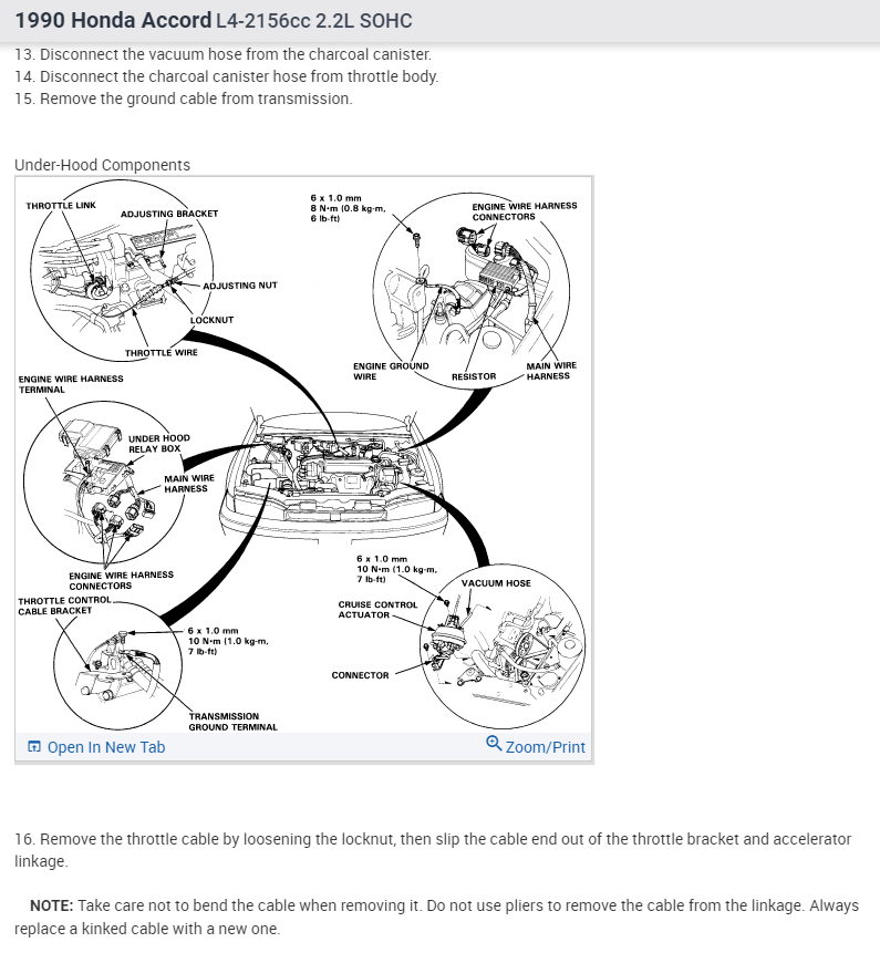

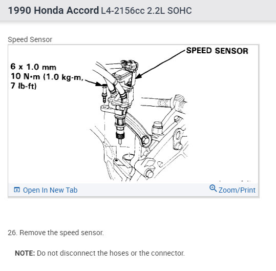

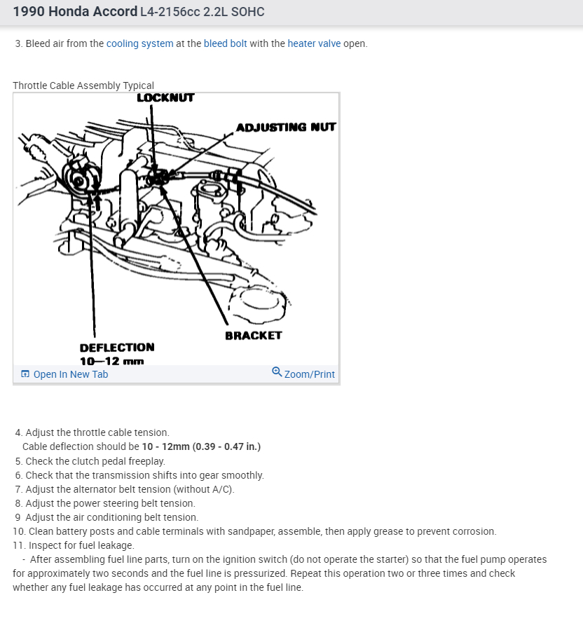

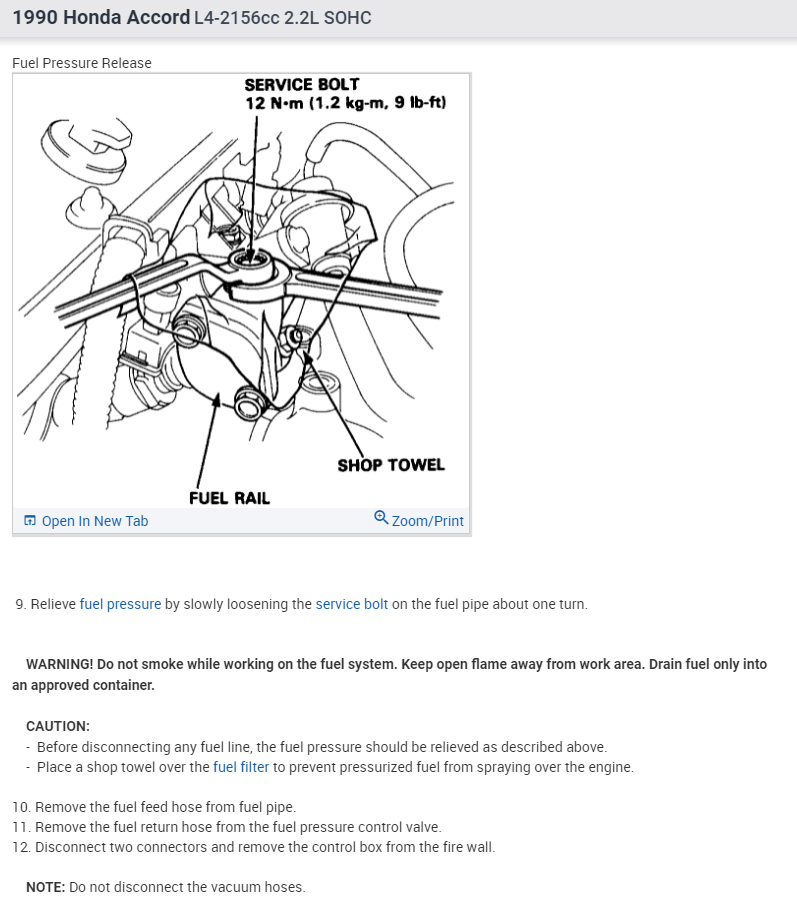

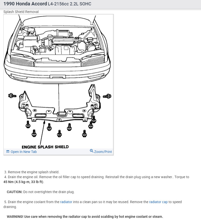

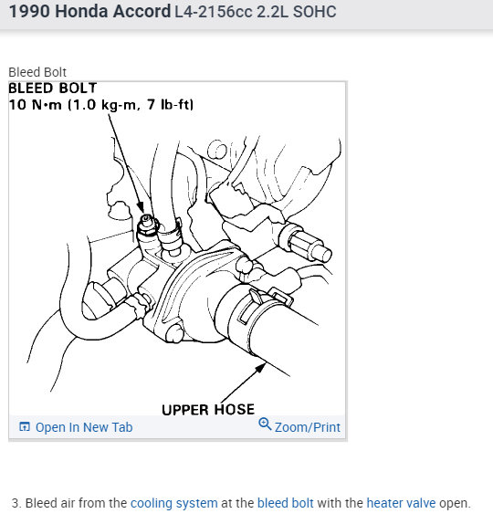

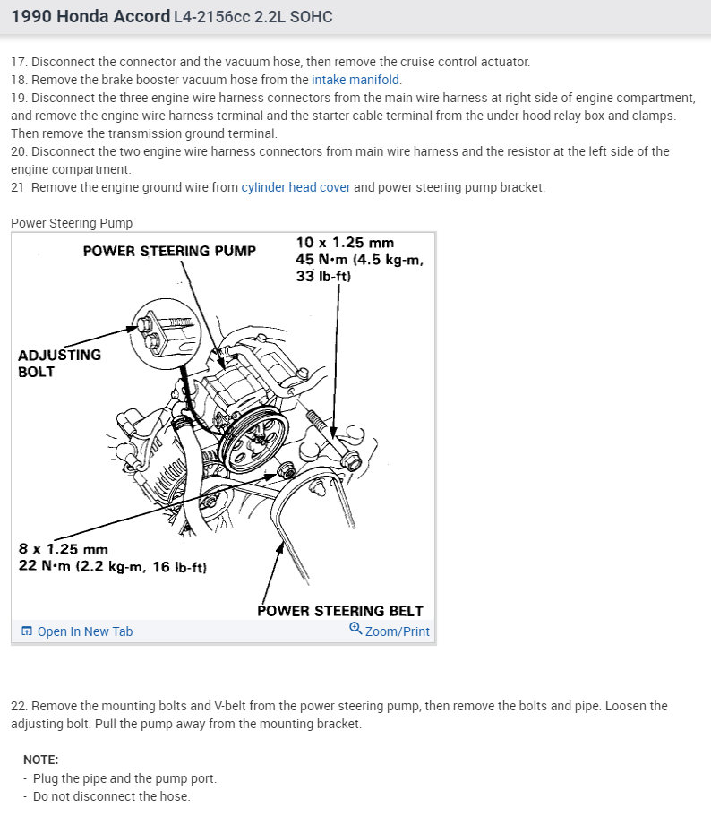

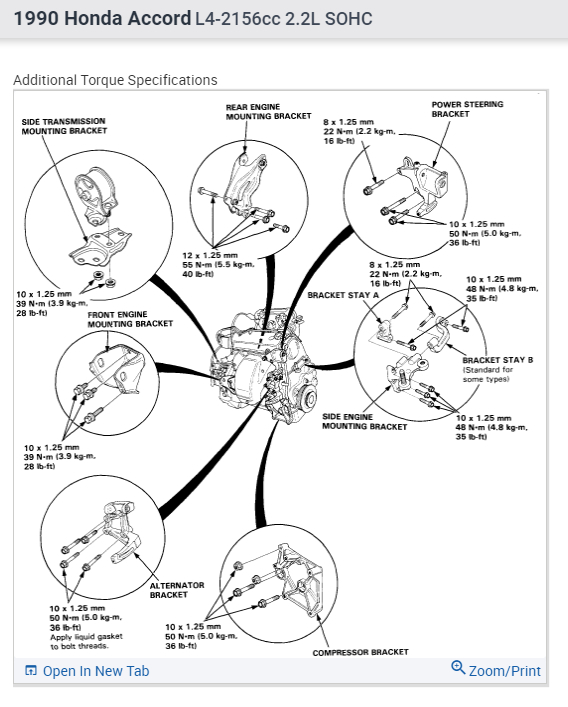

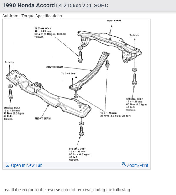

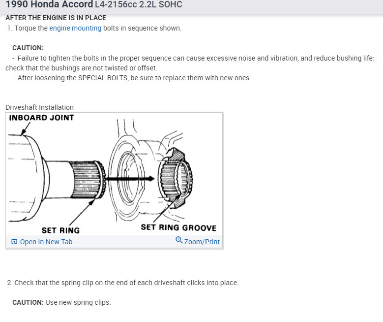

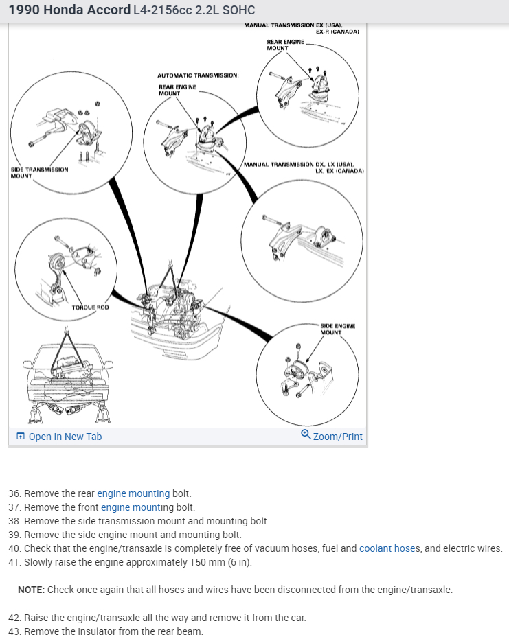

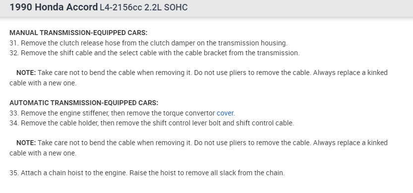

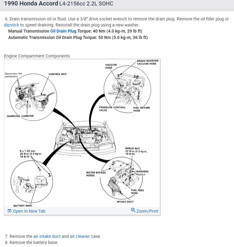

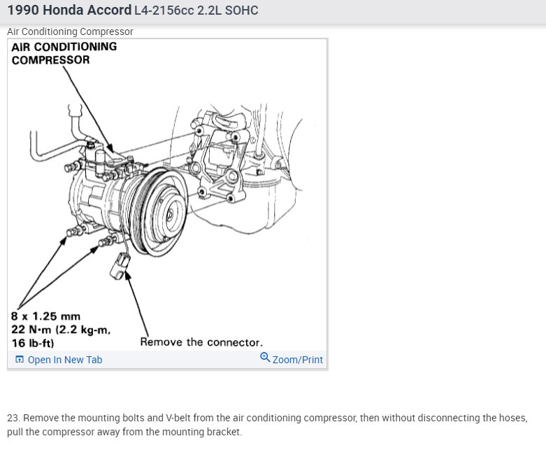

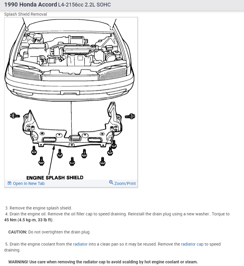

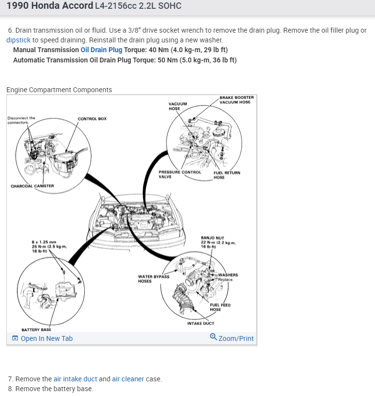

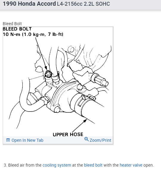

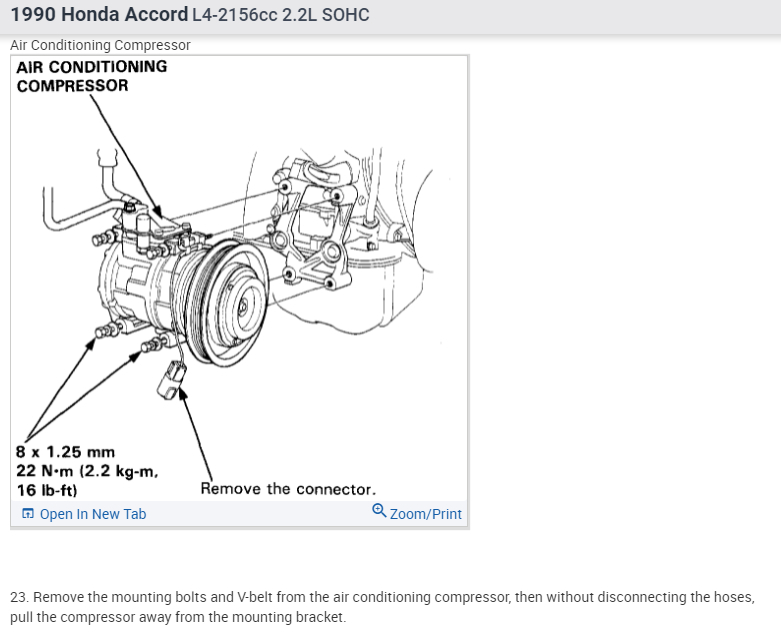

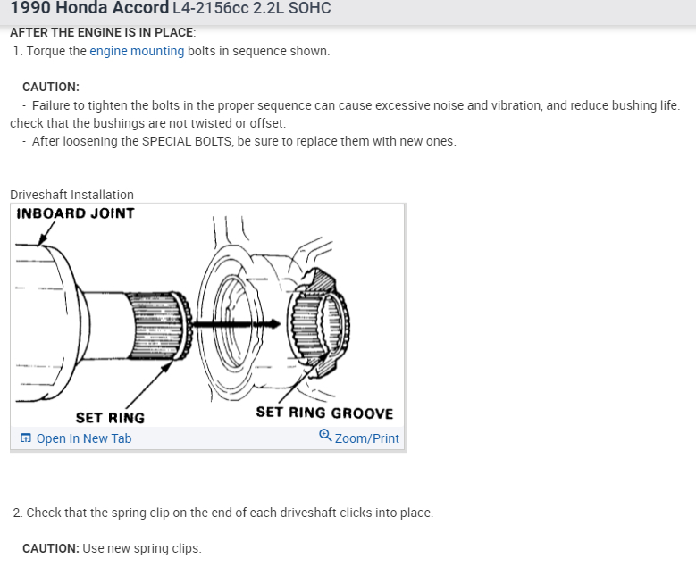

I have attached the standard engine replacement procedure below for reference.
Thank you.
