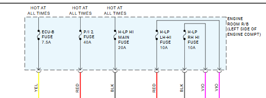

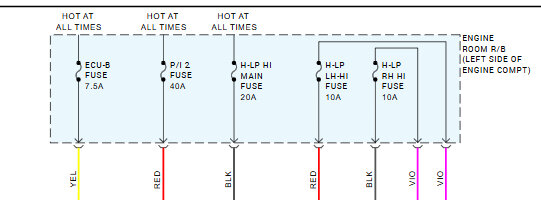

Can I ask if the car makes the noise while the engine is running and the car is not moving, or does the car need to be moving to make the noise? For the lighting issue I would check the fuses for the headlights which are listed in the image below. If the fuses are good the ground for the headlights on the right side could have got disconnected. For the transmission issue I would check the fluid level. Can you upload images or a short video so I can see what is going on with the damage and the noises?
Check out the images (below). Let us know how it goes.
