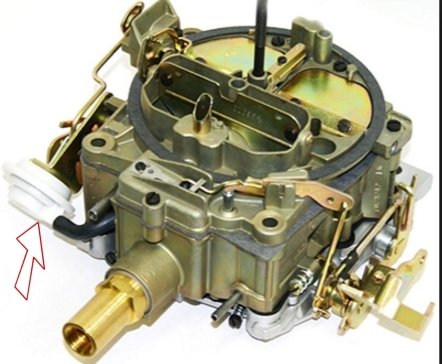

Hey 88,
It sounds like you have a primary choke pull of that has failed, we used to replace those all the time in the shop for this reason. I marked the part in the image below.
Please let us know what you find so it will help others.
Best, Ken

Sorry for taking so long to reply. I wanted to post a picture of the carburetor on my car to see if we are on the same page or if the carburetors are similar enough to carry on with the same advice.
I have not, as yet, done so. For now, let me report that the car seems to be idling at much more acceptable speeds with no other adjustments having been made except to lubricate all the linkages and moving parts on the carburetor once again. The cold start is still good but cranks a bit more than it used to before ignition and stepping gently on the accelerator pedal to hasten ignition causes a very slight pop which I assume is a misfire.
thanks again...... 88
