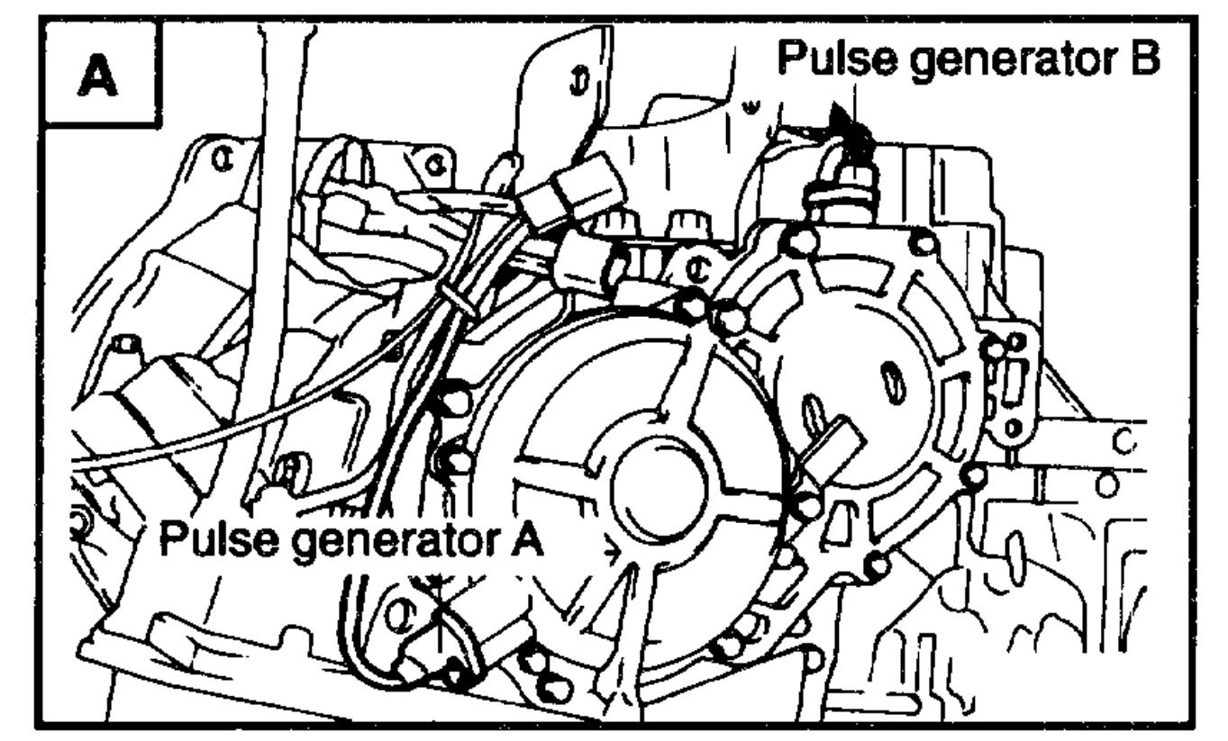

It sounds like a input shaft speed sensor is going out but to be sure. Here is a guide to help us run the codes:
Here is the location of the sensor below.
Check out the diagrams (below). Please let us know what you find.
Oct 29, 2018 at 9:58 AM
