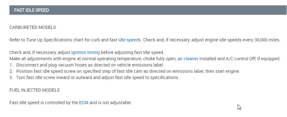

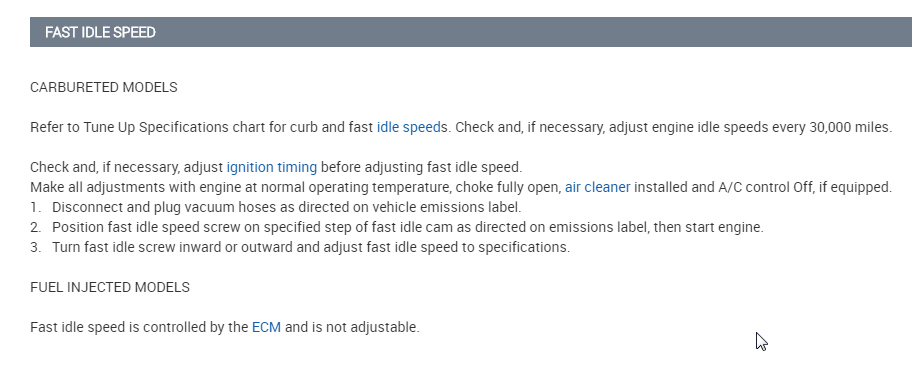

I attached how to replace the IAC assuming you have an electronic fuel delivery system (injectors not a carburetor). It could be the IAC but that normally causes an erratic idle or stall at idle.
If you have high RPM we need to check for a vacuum leak. Here is a guide that runs through this:

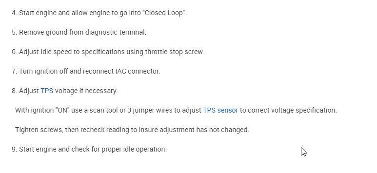

I also attached the fast idle adjustment. Again, if you have a fuel injection system then you don't have a way of adjusting idle speed. However, if it is high then we need to run through this info and go from there. There is a chance that it is a throttle sensor but that would normally have a fault code so let's start with this info and go from there. Thanks

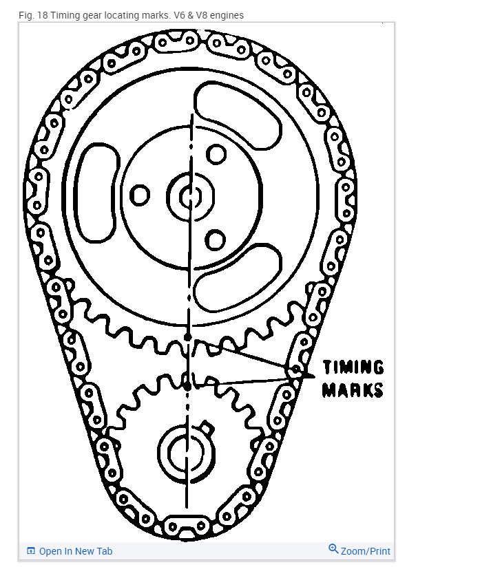

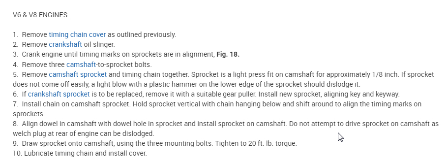

You have a timing chain and that is unlikely to jump timing but based on what it is now doing especially the backfiring, we need to check it. I attached the timing marks and chain replacement process. I don't think you need to replace it unless you find it is off. If it is, the chain could be stretched and need to be replaced.

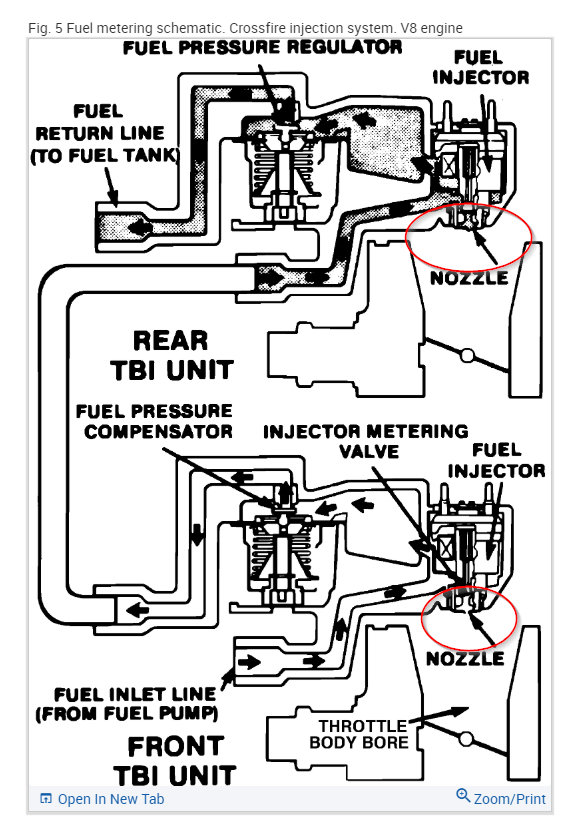

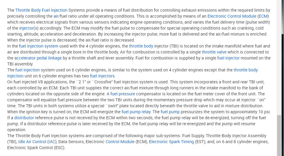

Okay. You mentioned it earlier but you have the Throttle Bore Injection (TBI) system, correct? If you did, where did you see the fuel drops? Were they coming from the injector? If this is the case, I don't think you have an ECM issue. I suspect you have a leaking injector or possible just a "dirty" injectors that is causing fuel to drip from it.
However, if you have seen this and that is when the surge happens then you found the issue. Clearly more fuel is going to raise RPM so we need to suspect an injector issue. The injectors are only supposed to deliver fuel when they are opened (pulsed) by the ECM and it is only supposed to spray fuel, not drip fuel. So if it is dripping fuel then that is either it remaining slightly open or there are deposits in the nozzle causing fuel to drip into the the intake.
Take a look at this info and let me know what you think.

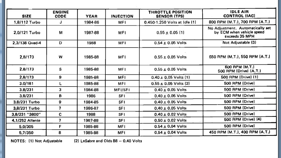

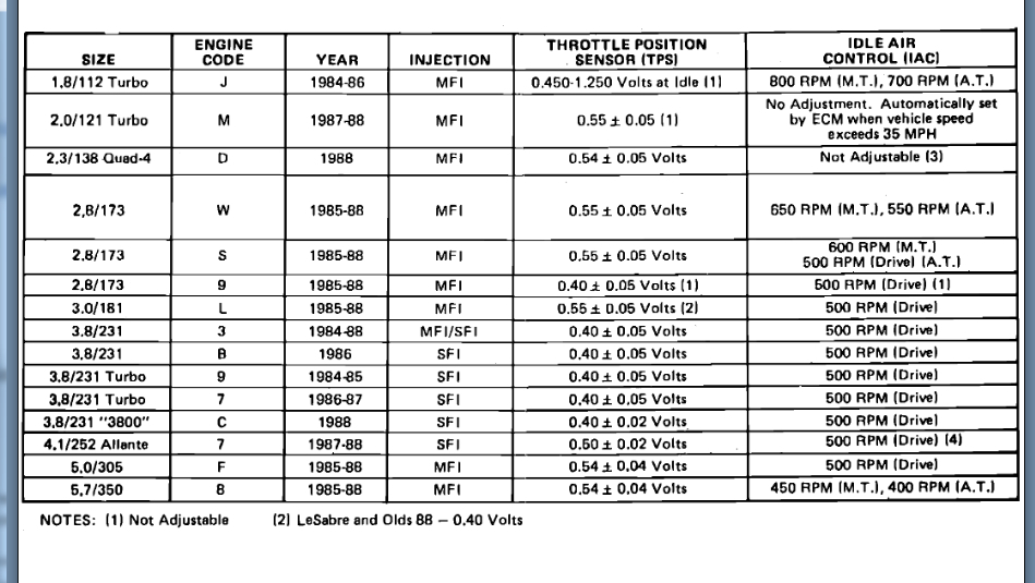

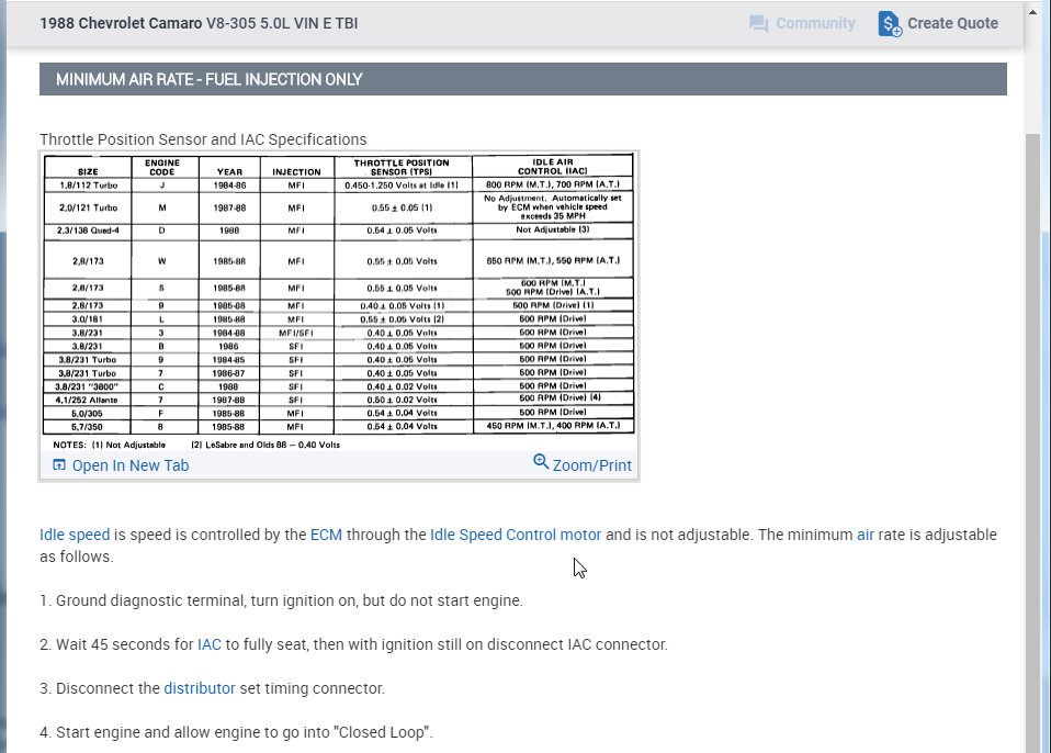

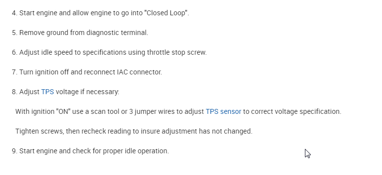

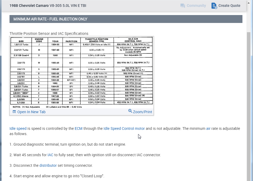

As for your high idle, as you are aware with it being TBI, idle speed is not adjustable. However, there is one process that we can try to reset which is the minimum air rate which will hopefully relearn the ECM's ability to control the idle.
I attached the process. Also, at idle we should be around 500 RPM and there is a chart showing the TPS voltage. When the vehicle is idling, note the RPM and then measure the voltage of the TPS. If the TPS is correct voltage but still has high idle then we know it is not the TPS.
Let me know what you find. Thanks

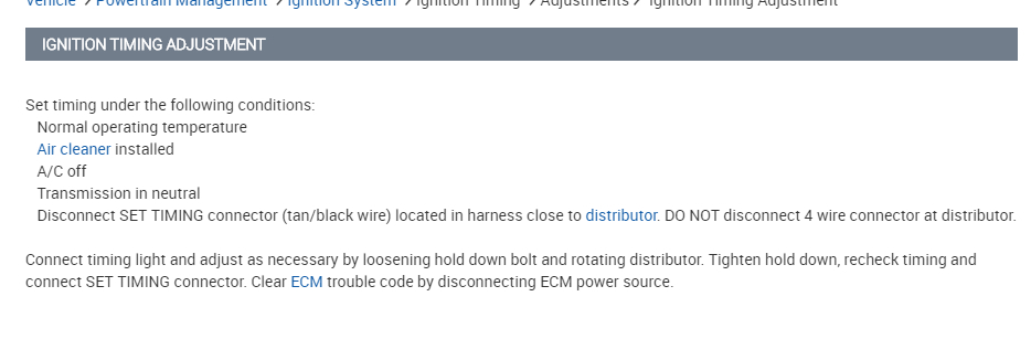

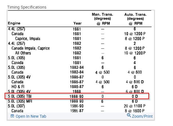

You mentioned it a number of times but I never checked it. The timing on this engine appears to be 0 BTDC. Lets set the timing there and then see what happens. 6 degrees shouldn't make that much of a difference but it could. Worth a try.

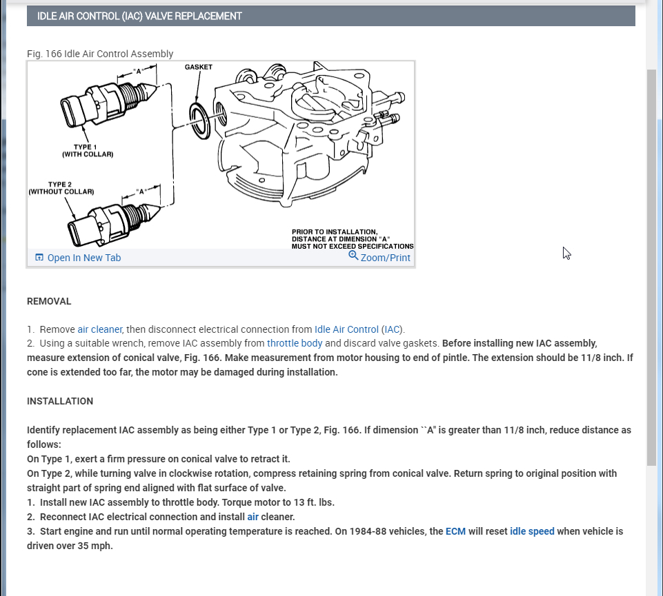

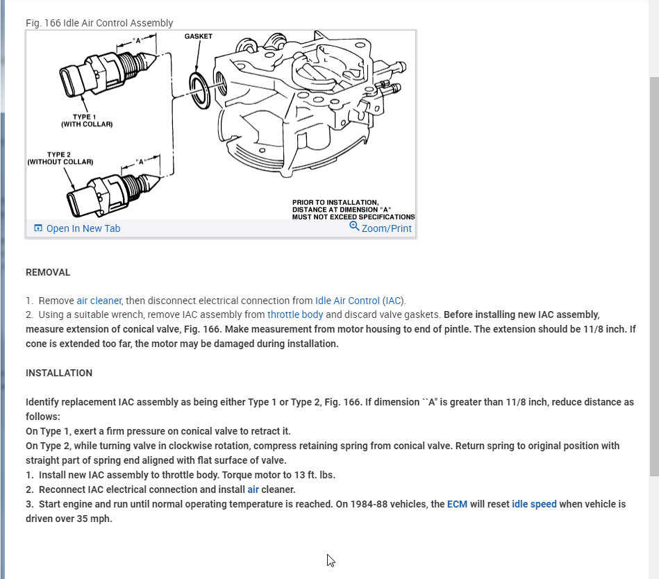

Hi Kenny, would you happen to know the measurement of the pintle in parked position in the IAC ,the to the open is 28mm .but my pintle came of and I refitted I also tried to reset but car still not right. thanks
Apr 30, 2020 at 7:25 AM
So this is interesting because I have never experienced this before. But you installed it at 28mm and the spec on installing the IAC is 11/8 inches which is 35mm (34.9mm to be exact). It cannot be any greater then this or it will damage the assembly. So let's install this at this length and retest it. Also, pay attention to the last sentence where it says on 84-88 the ECM will reset idle speed when driven over 35 MPH. So run through this process and then drive the vehicle and see if that fixes it.
Also, make sure you are measuring as the image shows. Thanks

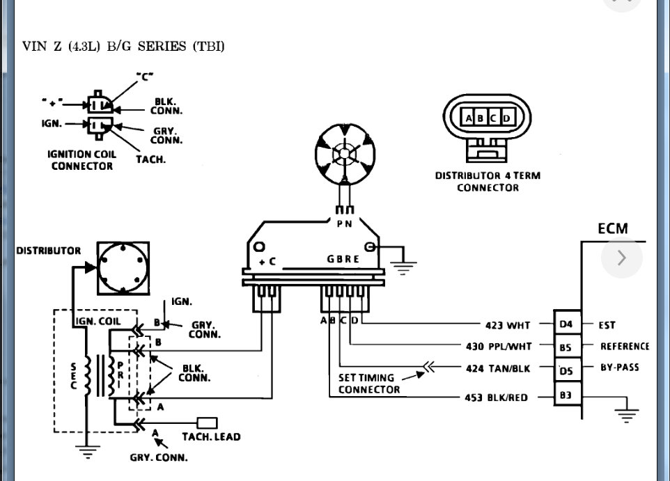

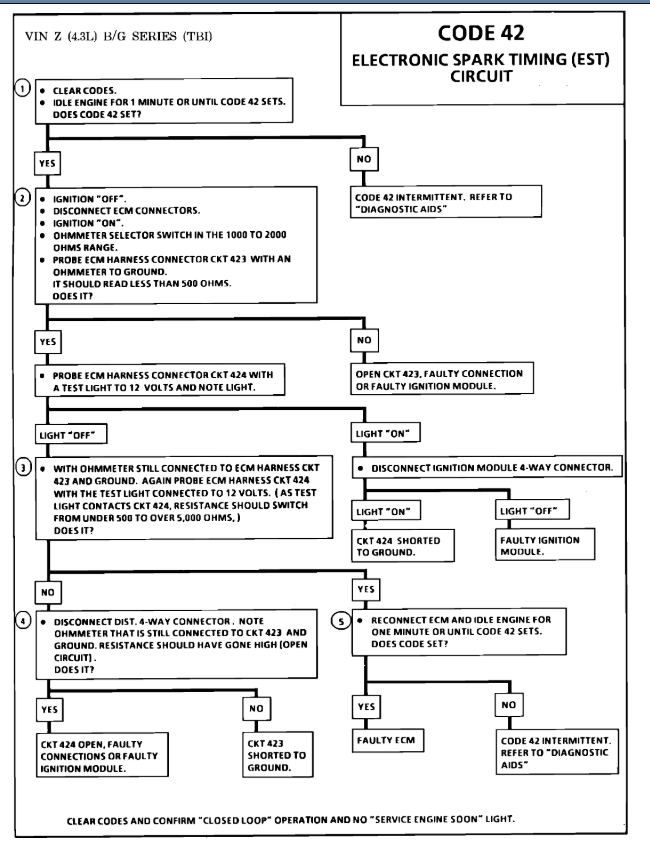

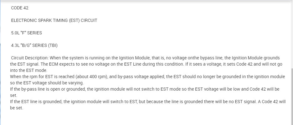

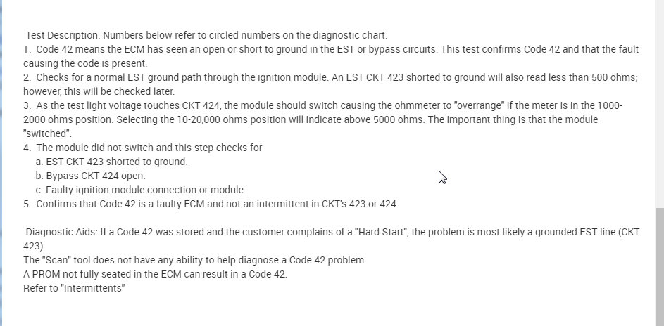

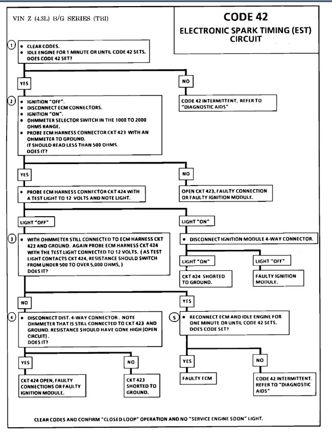

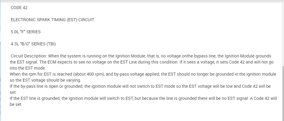

As for this issue we are going to have to get a new post started. Unfortunately we need to keep each post pretty tight to what the heading states. That way when others have the same issue you are they can find the answer. Backfiring is just a little too different then high idle, plus some may have backfiring on this vehicle and not a high idle so they will never find it under this post.
I attached the info about this code so if you can run through this and then post your results on a new post we will tackle this one with you as well. Thanks
