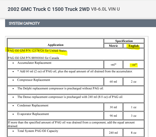

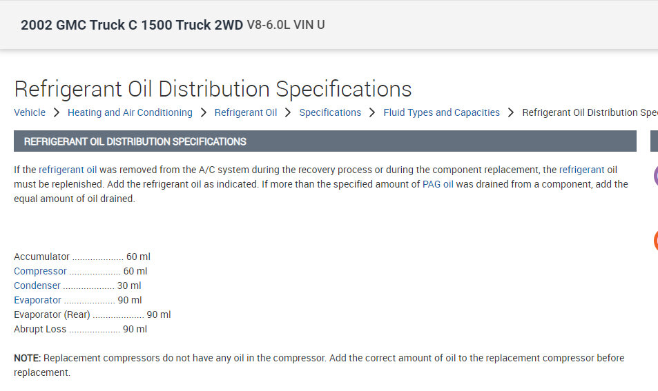

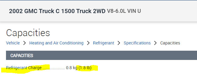

I own the truck listed above 1500 HD with a 6 liter engine.
What amount of R-134a and evaporator condenser oil should be in my A/C unit?
Dudley Garidel
Baton Rouge, LA
Apr 19, 2025 at 12:41 PM (Merged)
If could be restricted. However, if you flushed the system, it should be okay.
If you have a chance, let me know how things turn out for you.
Pic 1 below shows the amount of freon needed for the system, 1.8 lbs. Pics 2 and 3 are related to the PAG oil.
If you look at pics 2 and 3, they indicate how much should be added based on what component was replaced.
I'm not sure if you only replaced the condenser or not, but it is listed.
Let me know if this helps.
See pics below.
