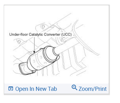

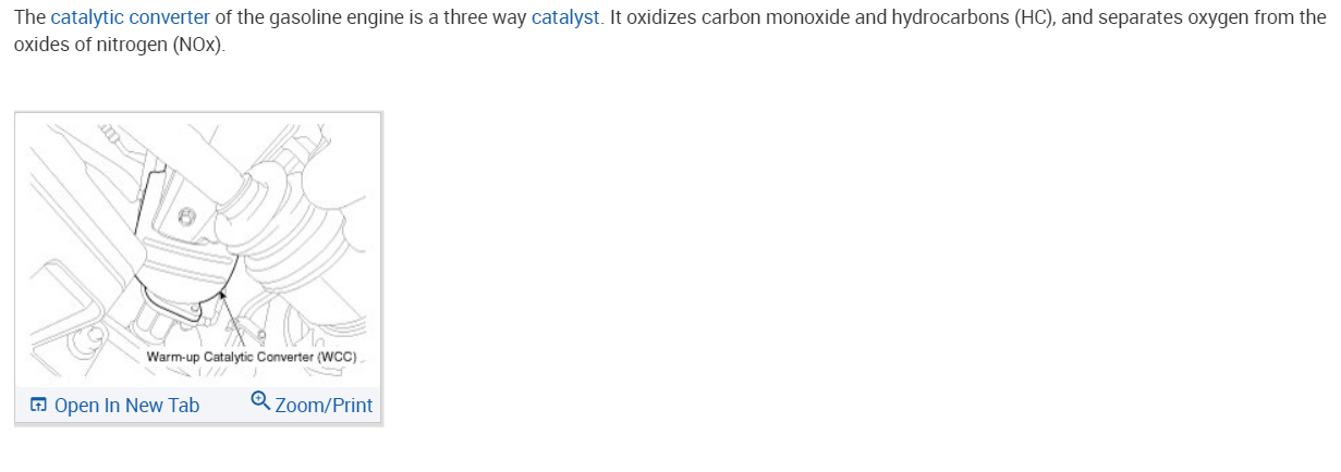

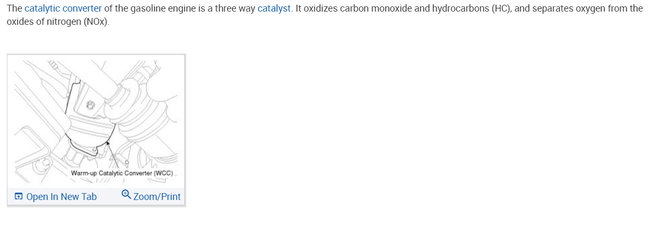

This is typical when the catalytic converter plugs up, to be sure here is a guide to help you confirm the issue with instructions below to show you how to change it out yourself:
and
https://www.2carpros.com/articles/catalytic-converter-replacement
Here is how to change the catalytic converter out on your car in the diagrams below. Check out the diagrams (below). Let us know what happens and please upload pictures or videos of the problem.
