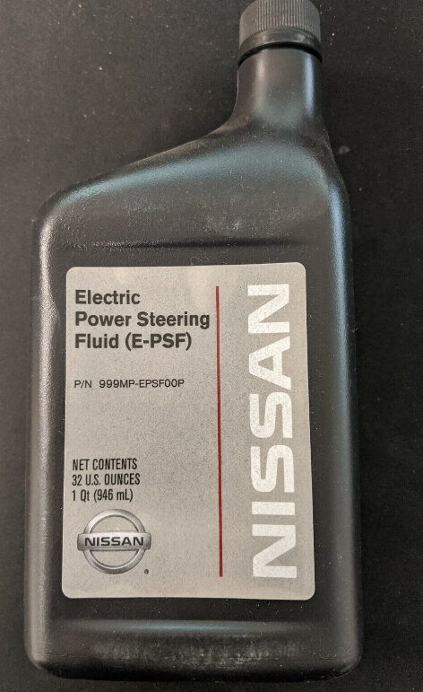

You should have electronic power steering in that. You have to get the fluid from the dealer.
This may not be causing the issue, but you need to make sure that has fluid in it because those electronic steering racks can be over $1400 just for the part.
I have added a picture of this fluid. It also has the part number on it.

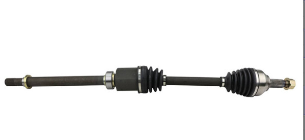

When you said they replaced the "CV joint on the front driver side tire joint", do you mean they replaced the whole CV Shaft? I have added an image for you.

I’m afraid the power steering reservoir I tried to check yesterday was the brake fluid. I looked and looked this morning for the power steering reservoir but could not find it. I got out the user guide for my car and there is no mention of power steering fluid in the list of fluids, the list of capacities, or in the power steering section of the book.

The invoice just says “both CV axles”. I thought they only did the one on the driver’s side. That was a total of $225, and he said he didn’t charge labor on that (so maybe that will tell you what they replaced).

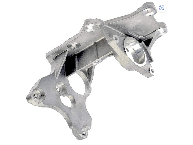

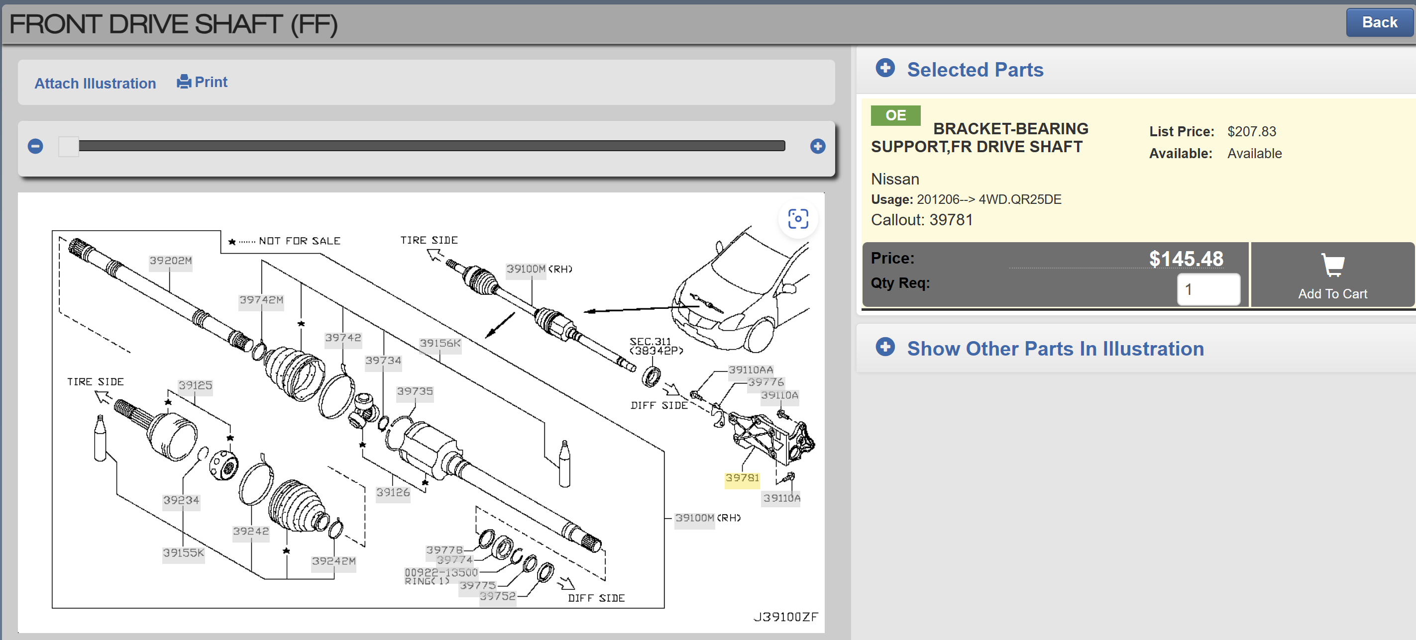

The whine to me sounds like it might be the bearing that sits in a bracket on the back of the motor that holds the passenger side C/V shaft in place. Most times, the bearing gets stuck in this bracket and usually recommend replacing the bracket when this job is done.
If they beat it out of the bracket a re-used it, it is possible the bearing isn't sitting right in it. The noise might be going away from heat or pressure put on or taken off the bearing as the vehicle weight shifts during a left-hand turn.
I have added an image of the bracket for you.
