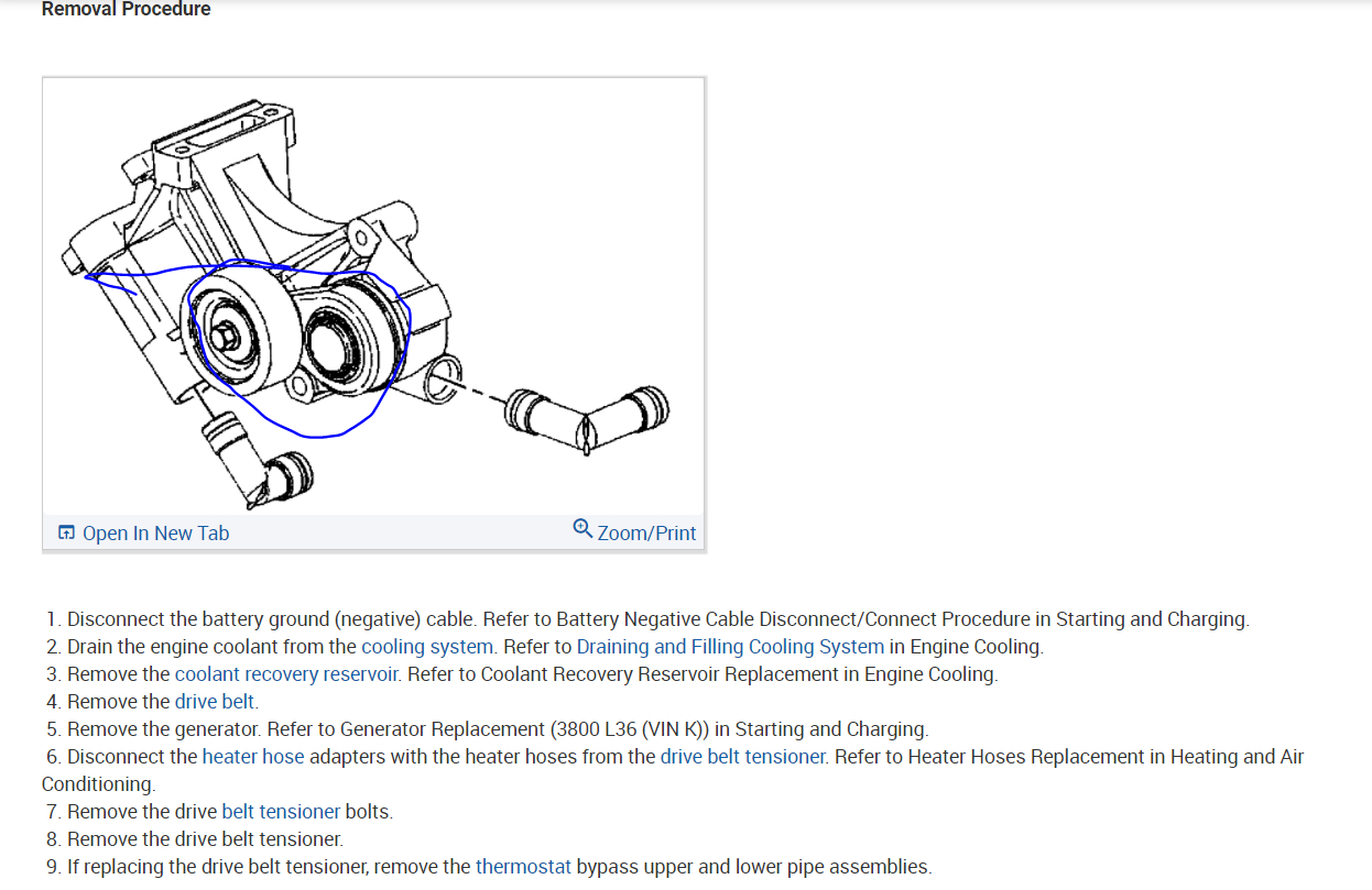

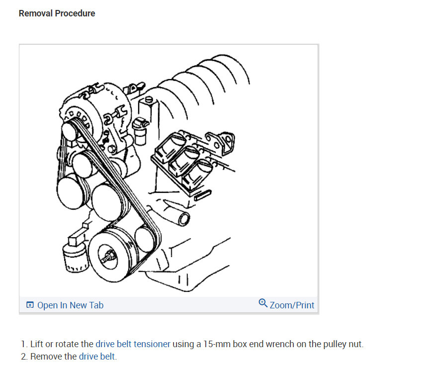

The most common failure for this is the serpentine belt tensioner.
https://www.2carpros.com/articles/car-squeaking-noise
I would remove the drive belt and then drive it and see if the noise is still there. That will confirm it.
https://www.2carpros.com/articles/replace-serpentine-belt
https://www.2carpros.com/articles/serpentine-belt-tensioner-replacement
