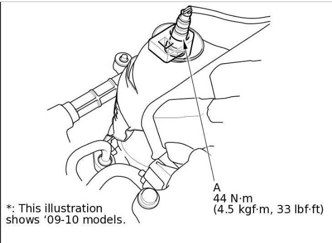

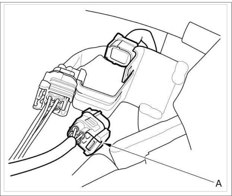

I am wondering if he cleaned it on the car which is a no no because the chemical cleaner can effect the A/F sensor and the oxygen sensors. It could go back to normal after a few miles of driving. Do you have check engine light on? If so lets get he codes to see what happened.
Here is the A/F sensor location and a guide to show you what you are in for when changing the sensor:
https://www.2carpros.com/articles/how-to-replace-an-oxygen-sensor
Please run down these guides and diagrams and report back.

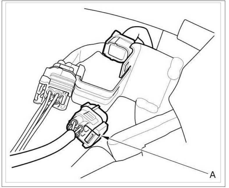

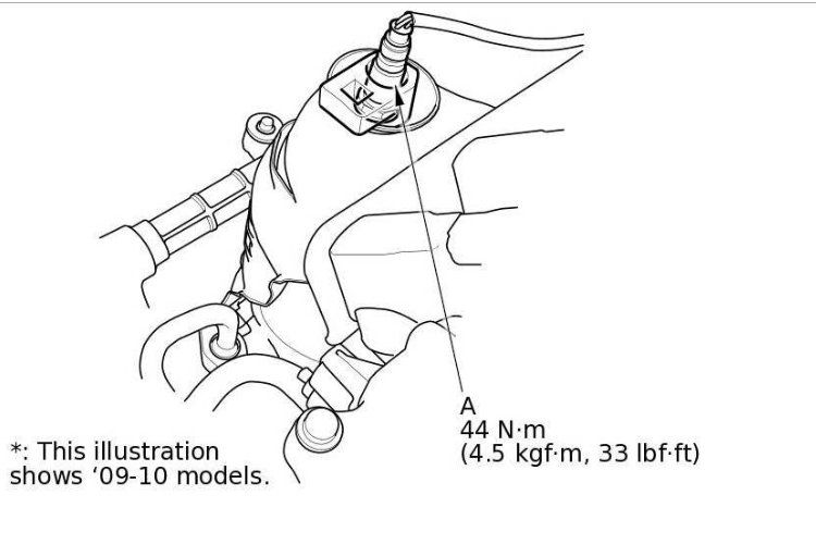

It sounds like the air fuel sensor is not working right I would replace it and see what happens. Here is a guide and diagrams to help you:
Check out the diagrams (below). Please let us know what you find.
