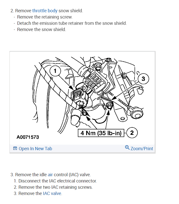

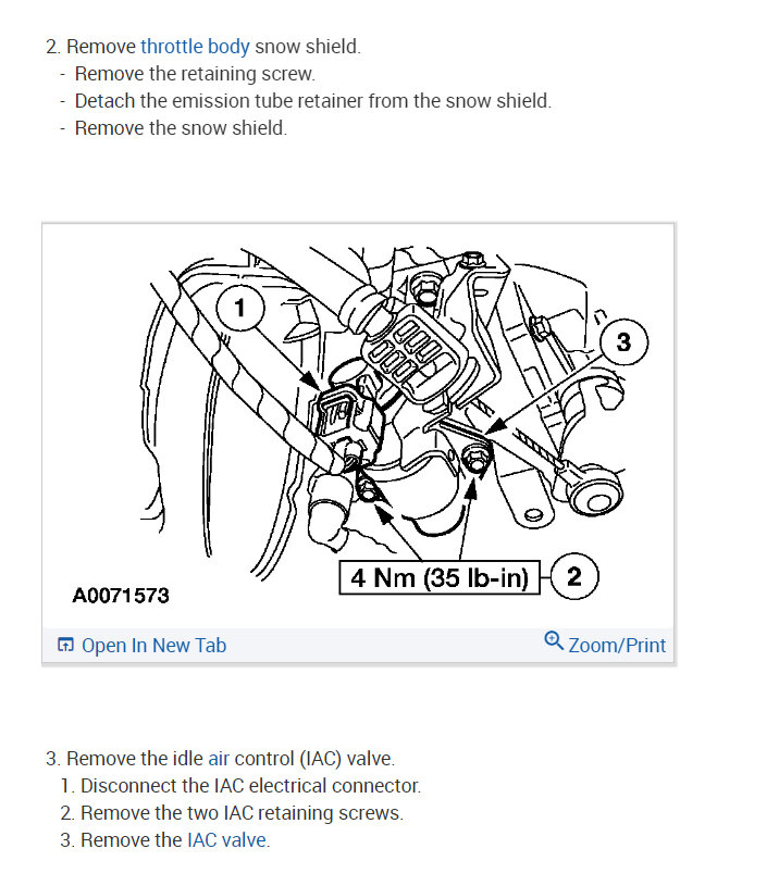

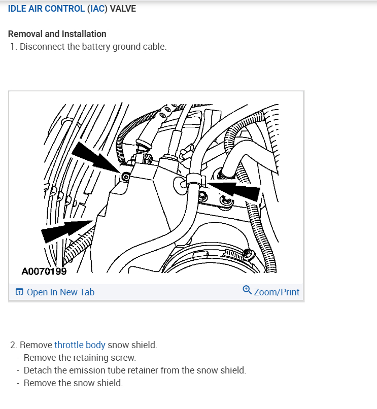

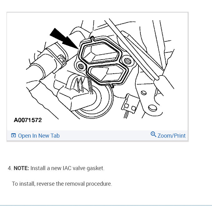

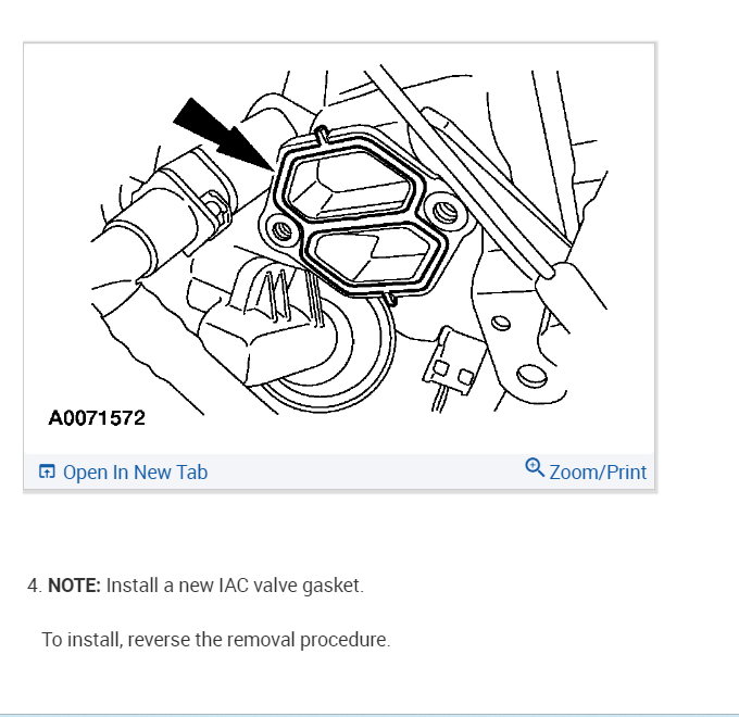

The idle air control valve is mounted on the throttle body. I have left instructions in the images below. Also, here are two guides and can help us fix the problem. Use the first guide when the engine is cold only.
and
https://www.2carpros.com/articles/engine-idles-too-high
