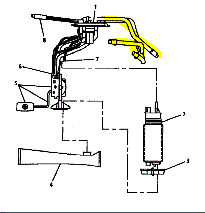

Was anything installed in the trunk that would have required drilling? Although the tank may not be damaged, there are fuel lines at the top of the tank that can be damaged. See pic 1 below. Those hoses are at the top of the tank (fuel pump) and run under the vehicle.

See pic below.
