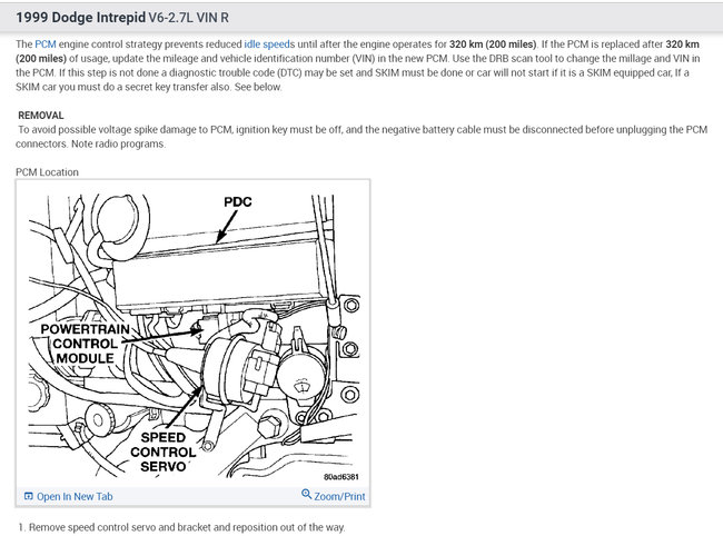

My car has been doing this high idle for a while. I have replaced all the vacuum hoses and MAP and IAC but to no avail. I'm starting to wonder if it maybe the ECU? Not sure where to go from here.
