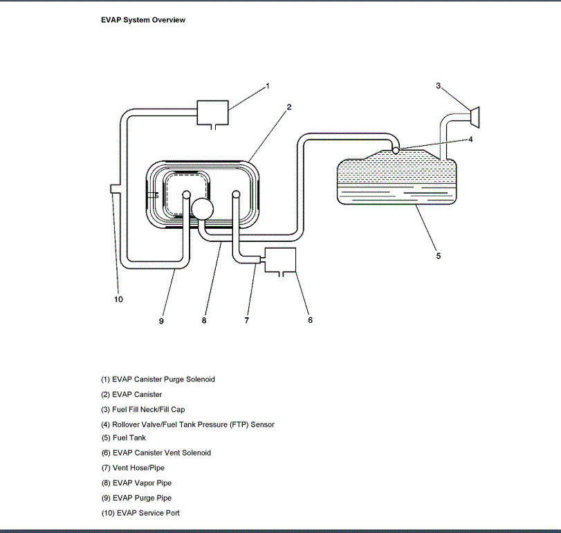

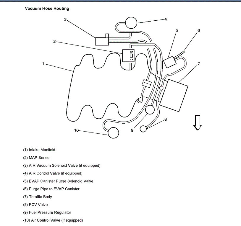

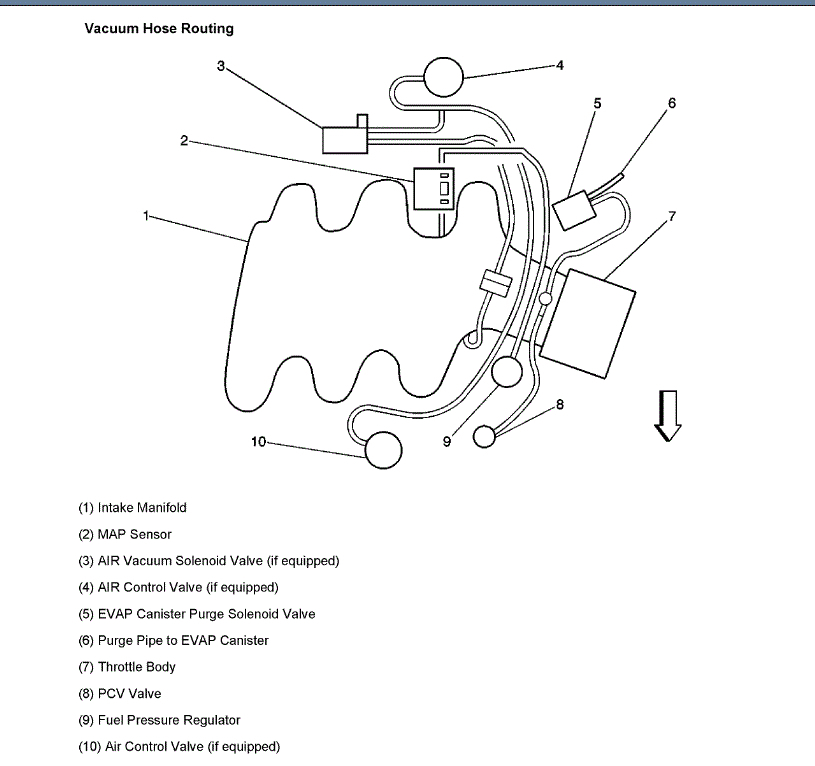

I attached two pics for you to review. They are the vacuum routing schematics. Let me know if they help. Also, here is a link that explains how to check for a vacuum leak:
Let me know what you find.
