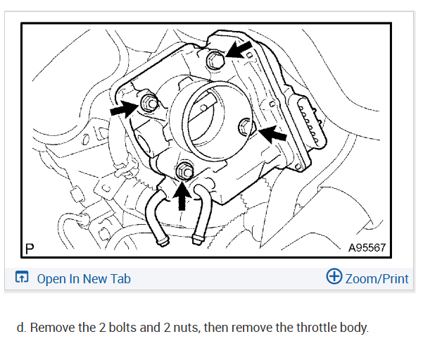

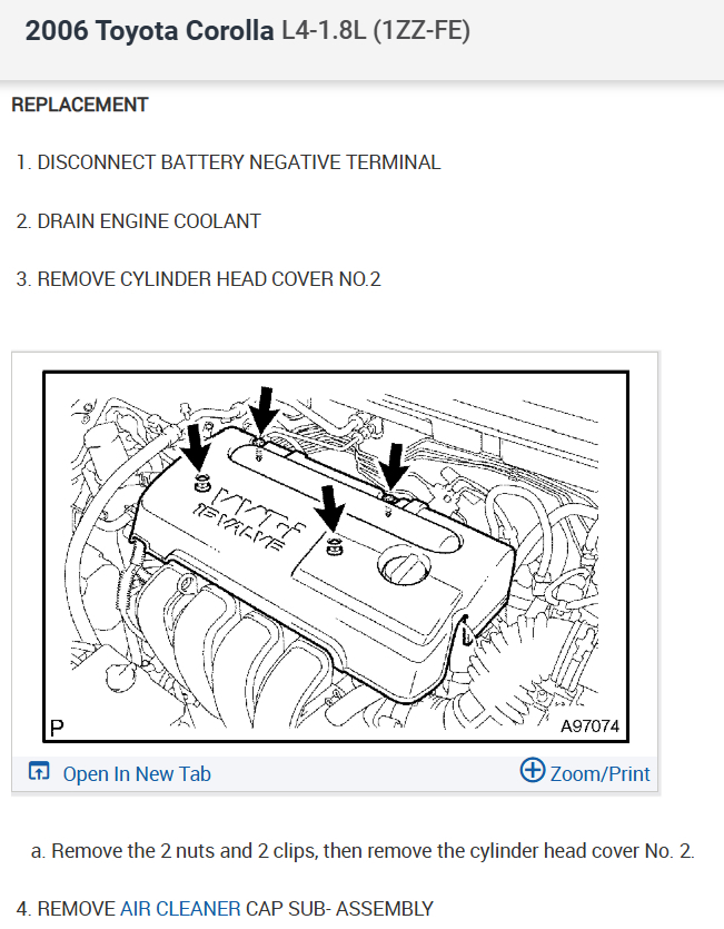

It can be a vacuum leak, or the throttle body needs to be replaced, can I ask if there are any codes? We should run them to see if any are stored.
Here is a guide to help:
Here is a guide that will help with the high idle problem and give the most popular causes for the high idle condition and how to fix it.
https://www.2carpros.com/articles/engine-idles-too-high

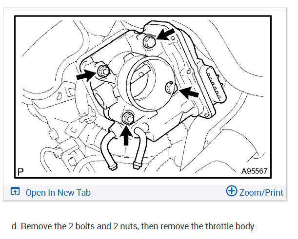

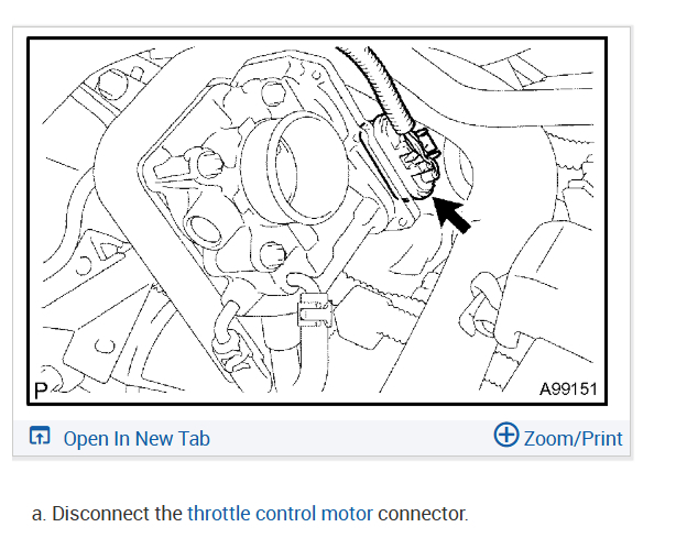

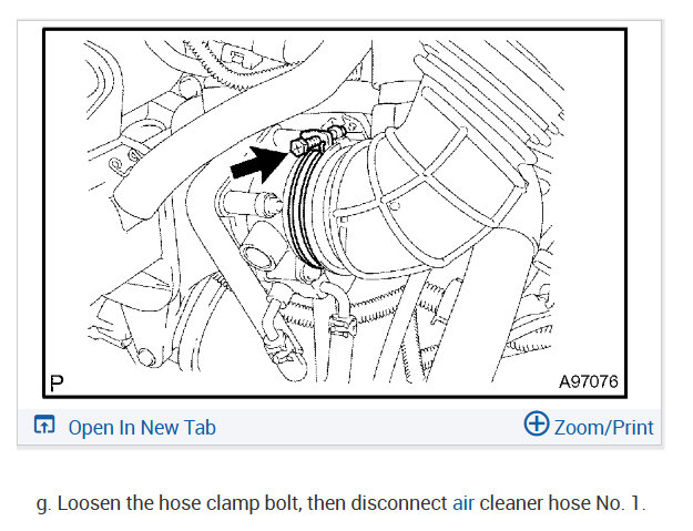

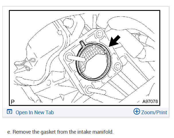

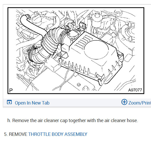

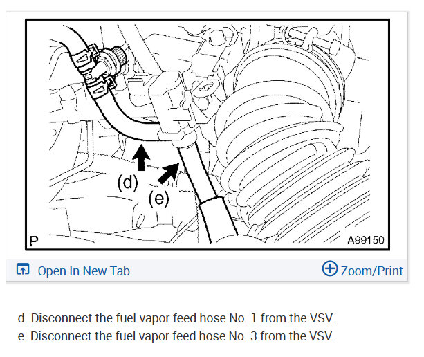

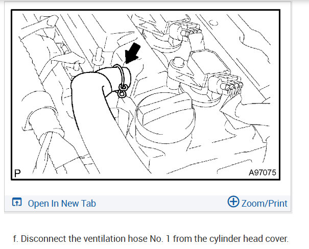

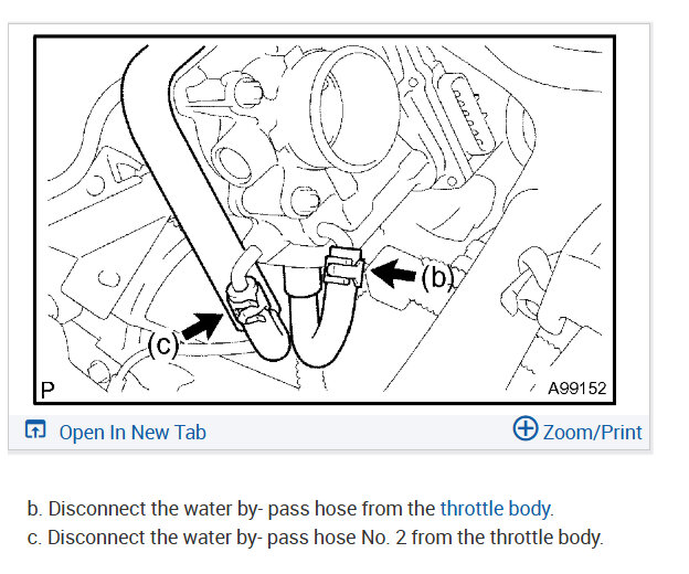

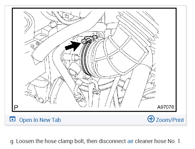

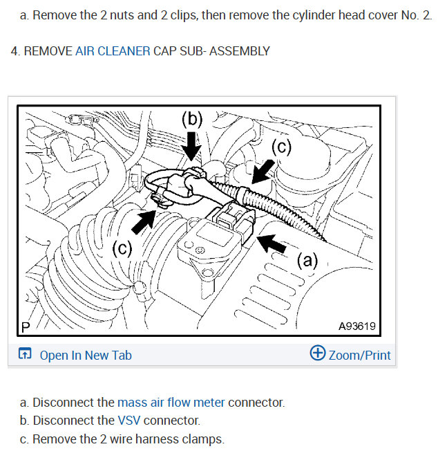

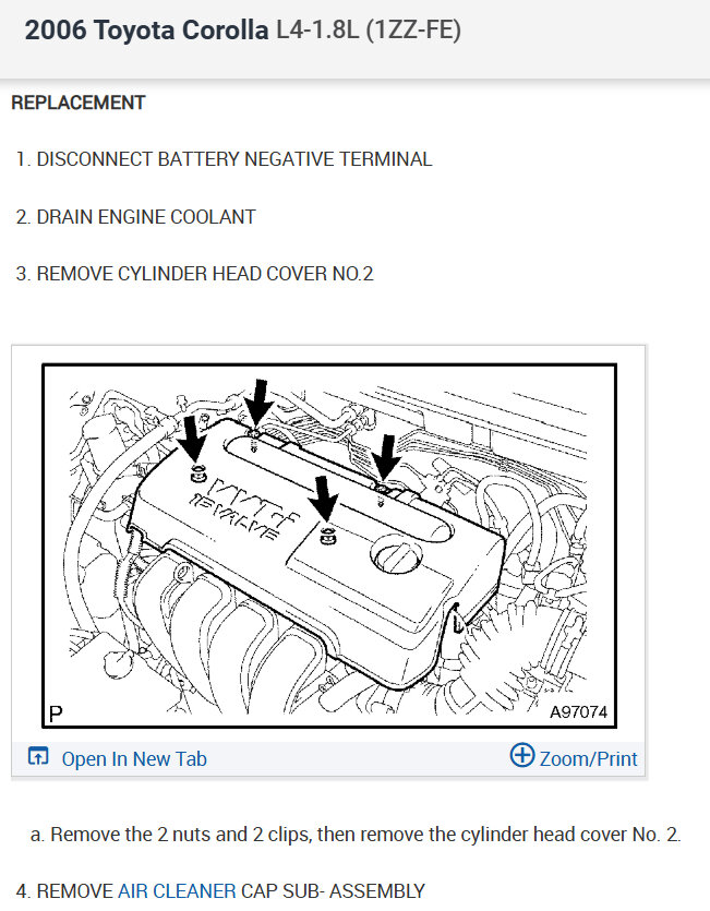

Here is how to swap out the throttle body in case there is a code for it but please go over the guides above first. Also, check the base gasket for the throttle body as well. Check out the images (below). Please upload pictures or videos in your response of any problems so we can see what to help you with.
