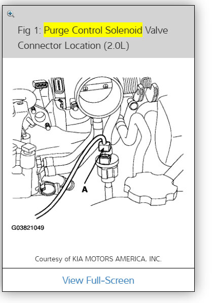

I would check the EVAP purge solenoid, once removed you should not be able to blow through it.
Basic Idle rpm (After warm up)
A/C OFF .................... 700 ± 100 rpm
A/C ON .................... 750 ± 100 rpm
Here is the location of the valve so you can check it out. Check out the images (below). Please upload pictures or videos in your response of the problem so we can see what's going on.
