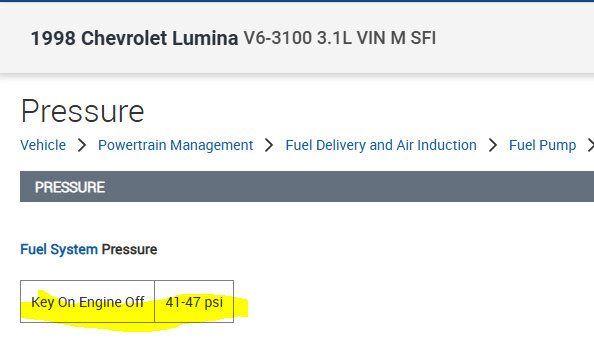

Also, fuel pressure should be between 41 and 47 with the key on and the engine off. It almost sounds like something is plugged after the fuel pressure regulator. See pic below. After the fuel reaches the fuel rail, unused fuel is returned to the fuel tank by a separate pipe. The return is attached to the fuel pressure regulator. That is where I am suspecting a possible issue. Something is blocking the return.
See pic below.
