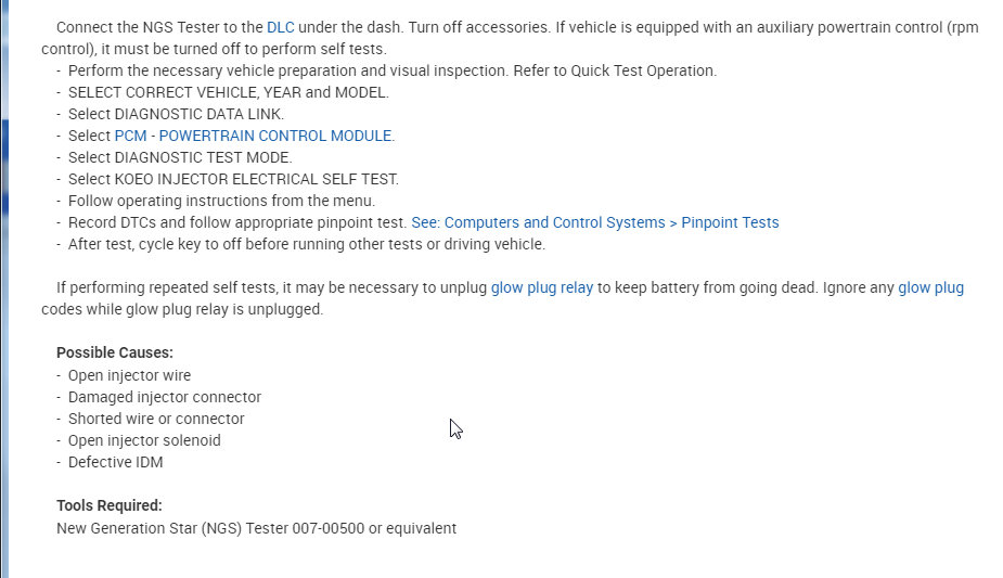

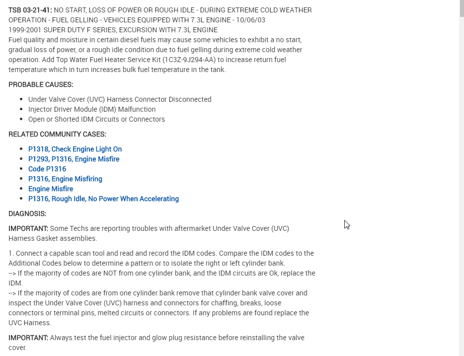

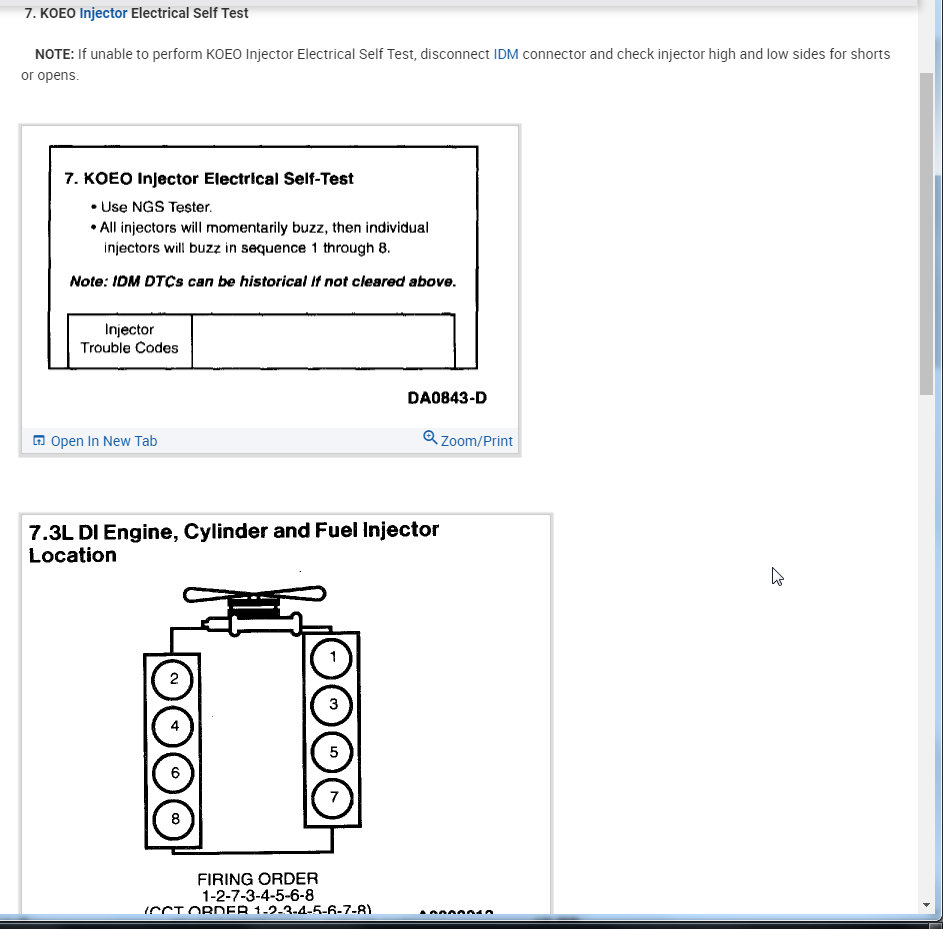

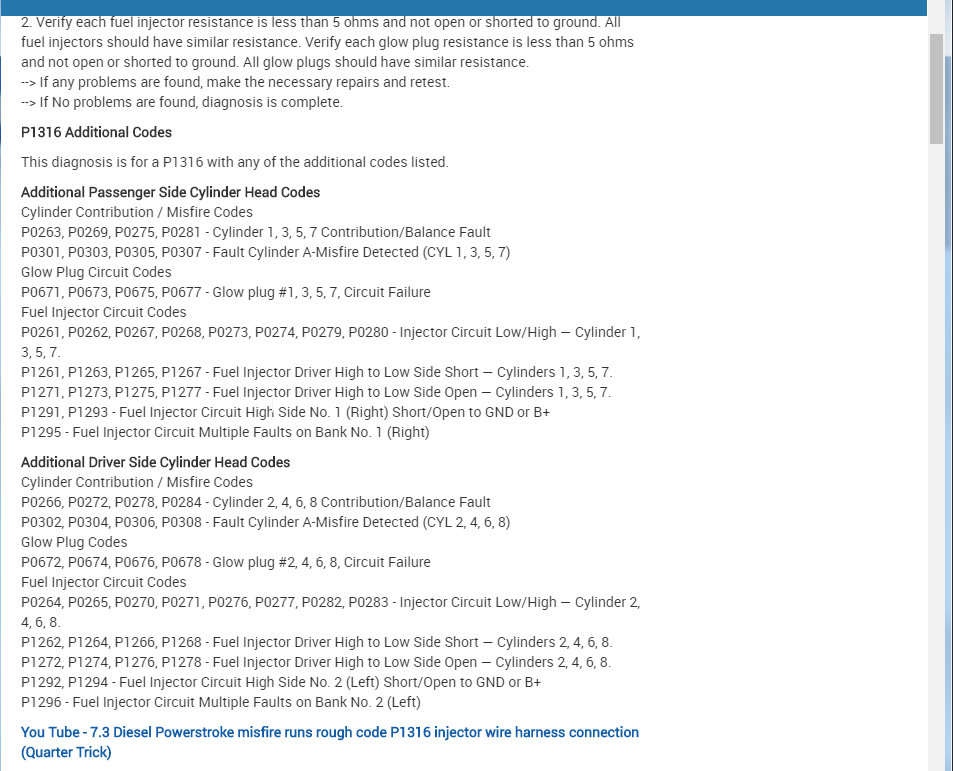

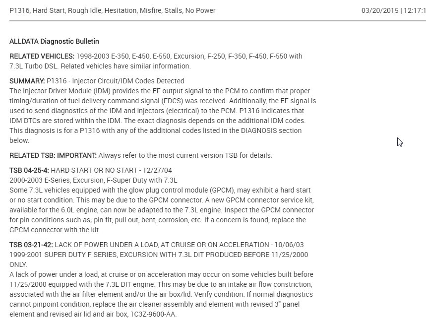

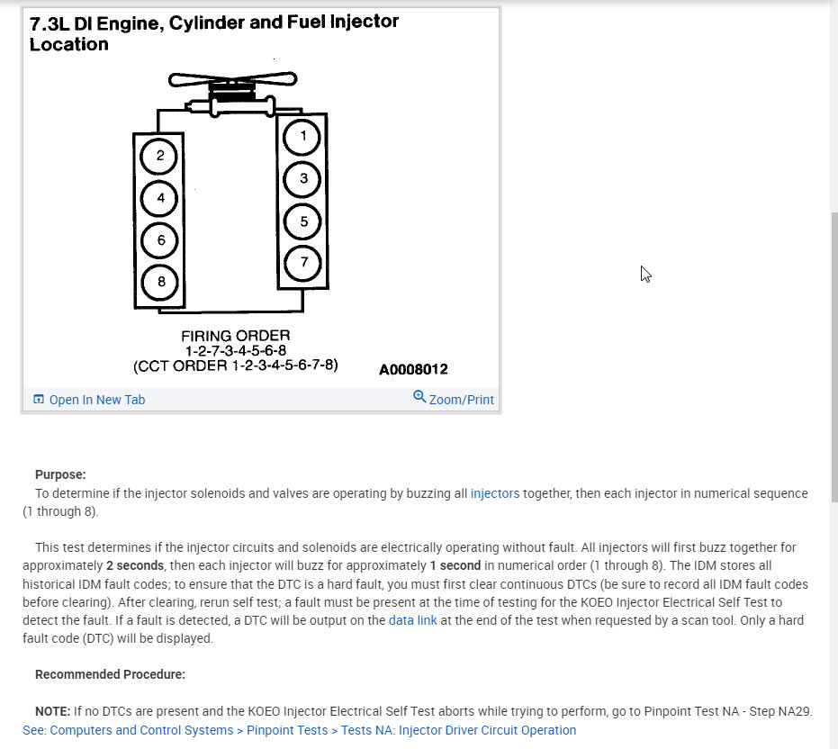

It is possible that you have two issues but I suspect the over full oil and hard starting are the same issue and that is the injectors.
These trucks are known for filling the crankcase with fuel due to injectors that are leaking. Clearly if the oil was not overfilled then it is not going to produce more oil so something else is causing the level to rise. If you found no coolant then the most likely cause is fuel. When you add in the hard starting I am sure this is your issue.

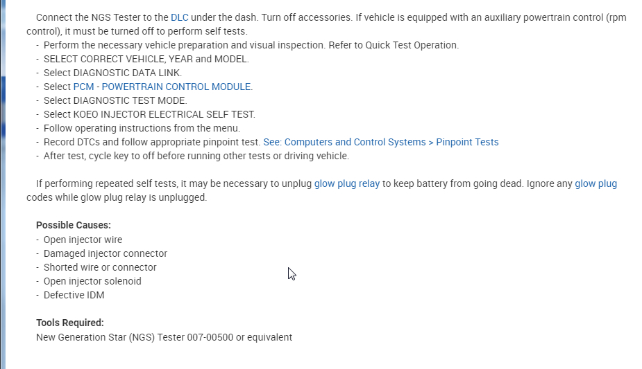

I attached a few documents that go over some of this. Next step is to check for codes and go from there.
