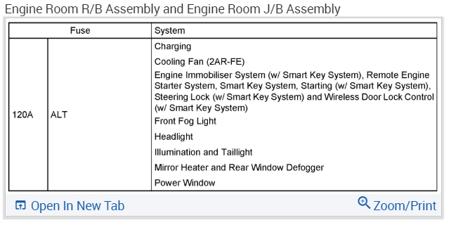

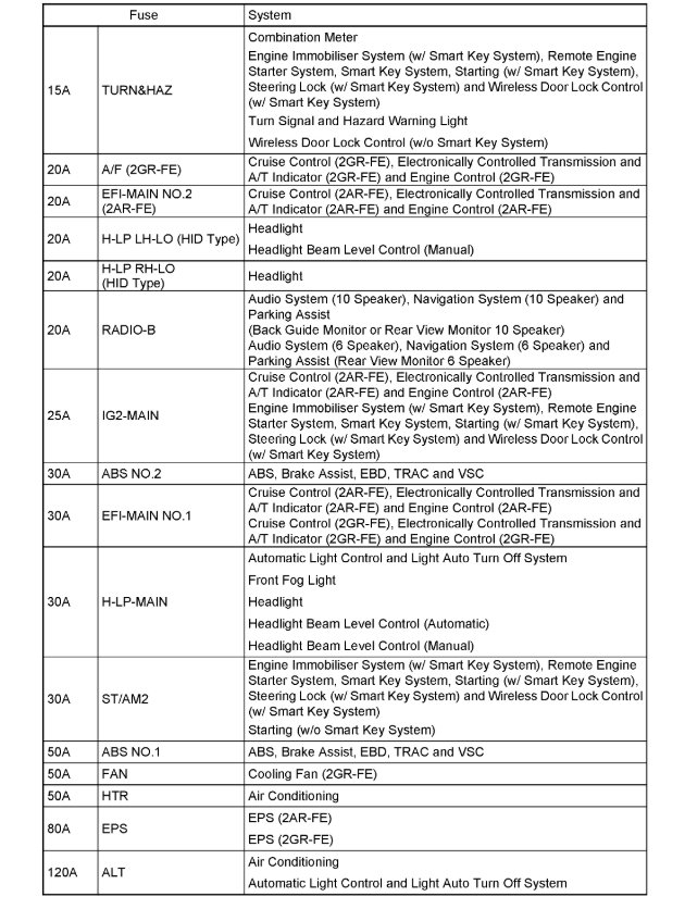

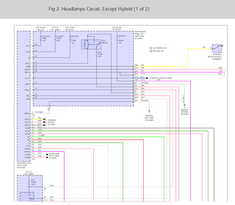

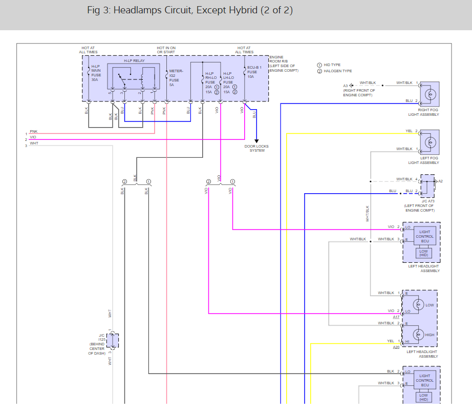

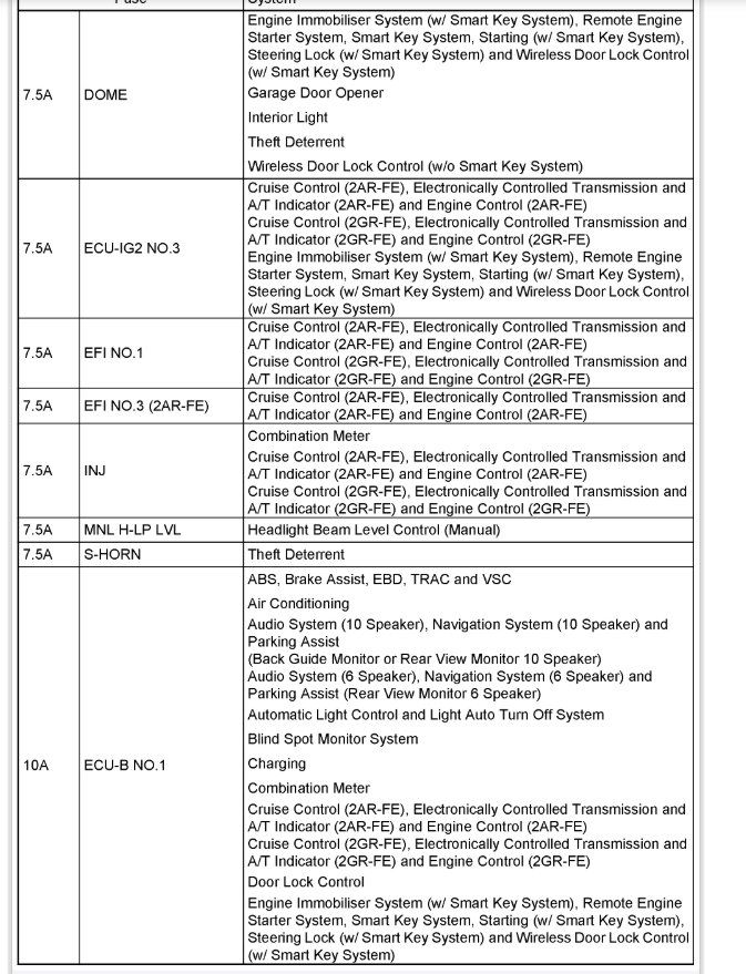

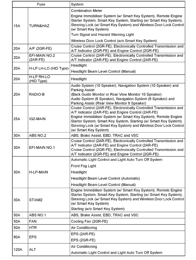

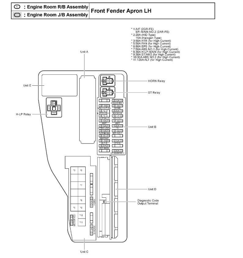

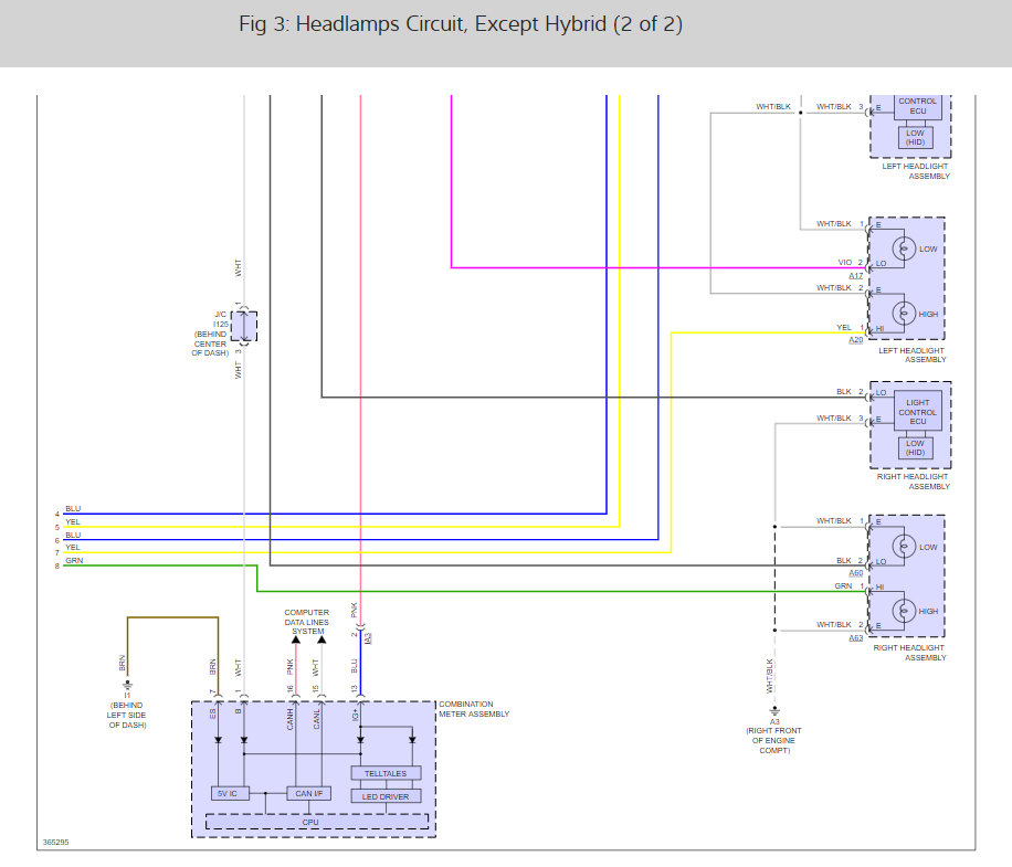

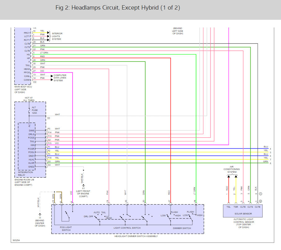

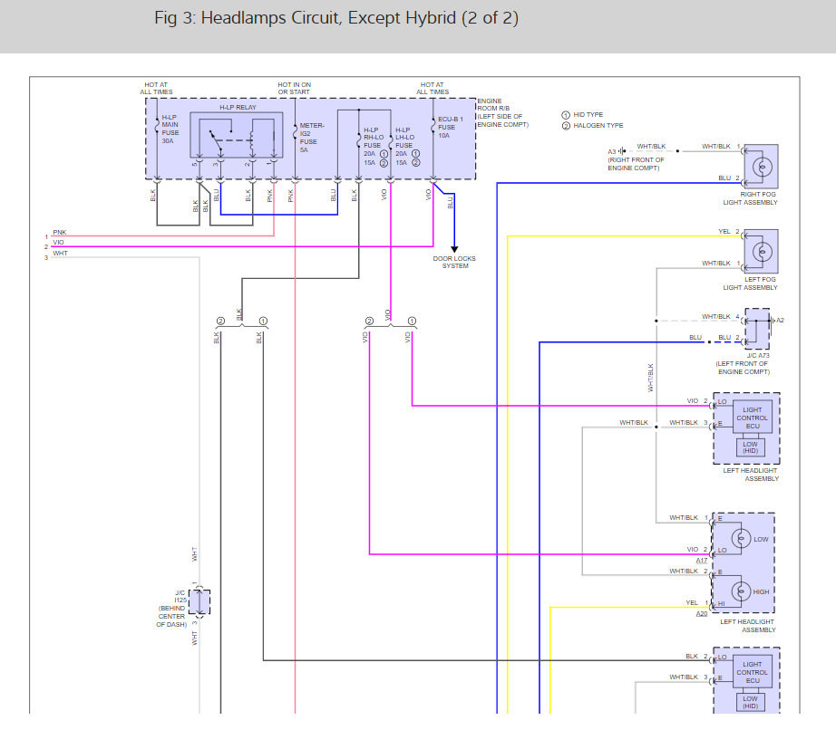

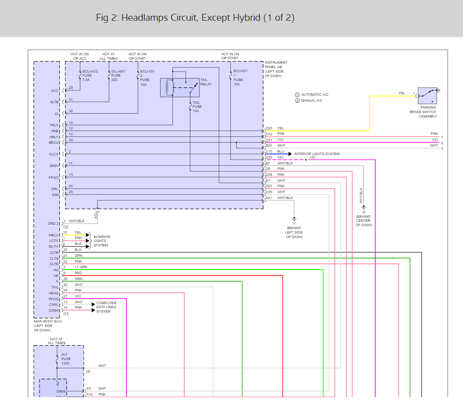

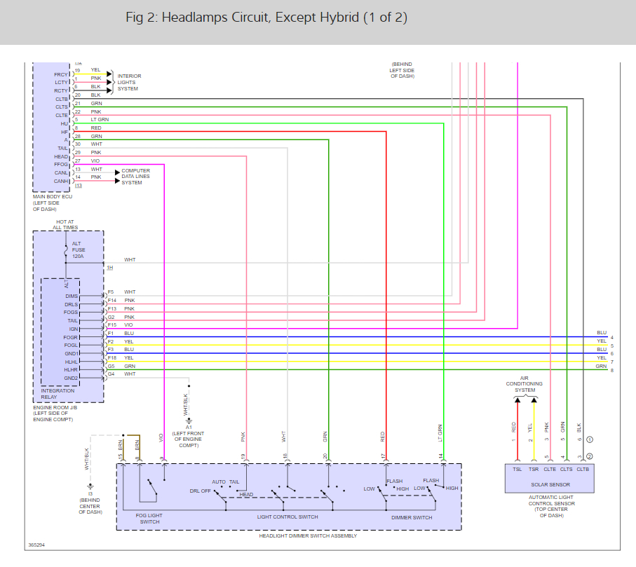

It sounds like the H-LP relay is stuck on. here is a guide to help you test it and the headlight wiring diagrams so you can see how the system works and the relay location as well (below):
May 29, 2019 at 7:35 PM
SAENGS210
  • 10 POSTS
It was a bad integration relay.
