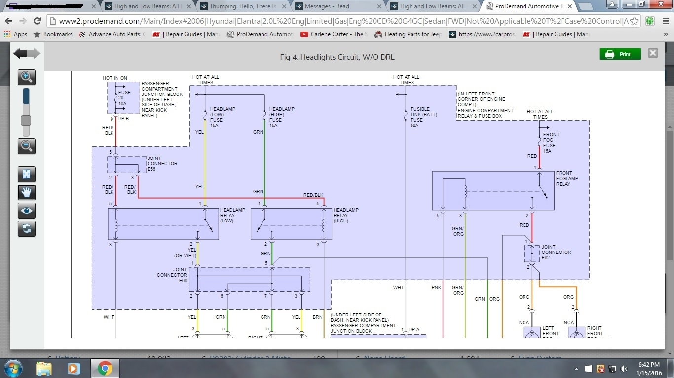

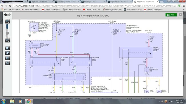

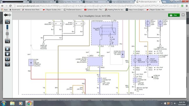

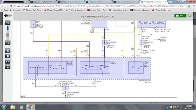

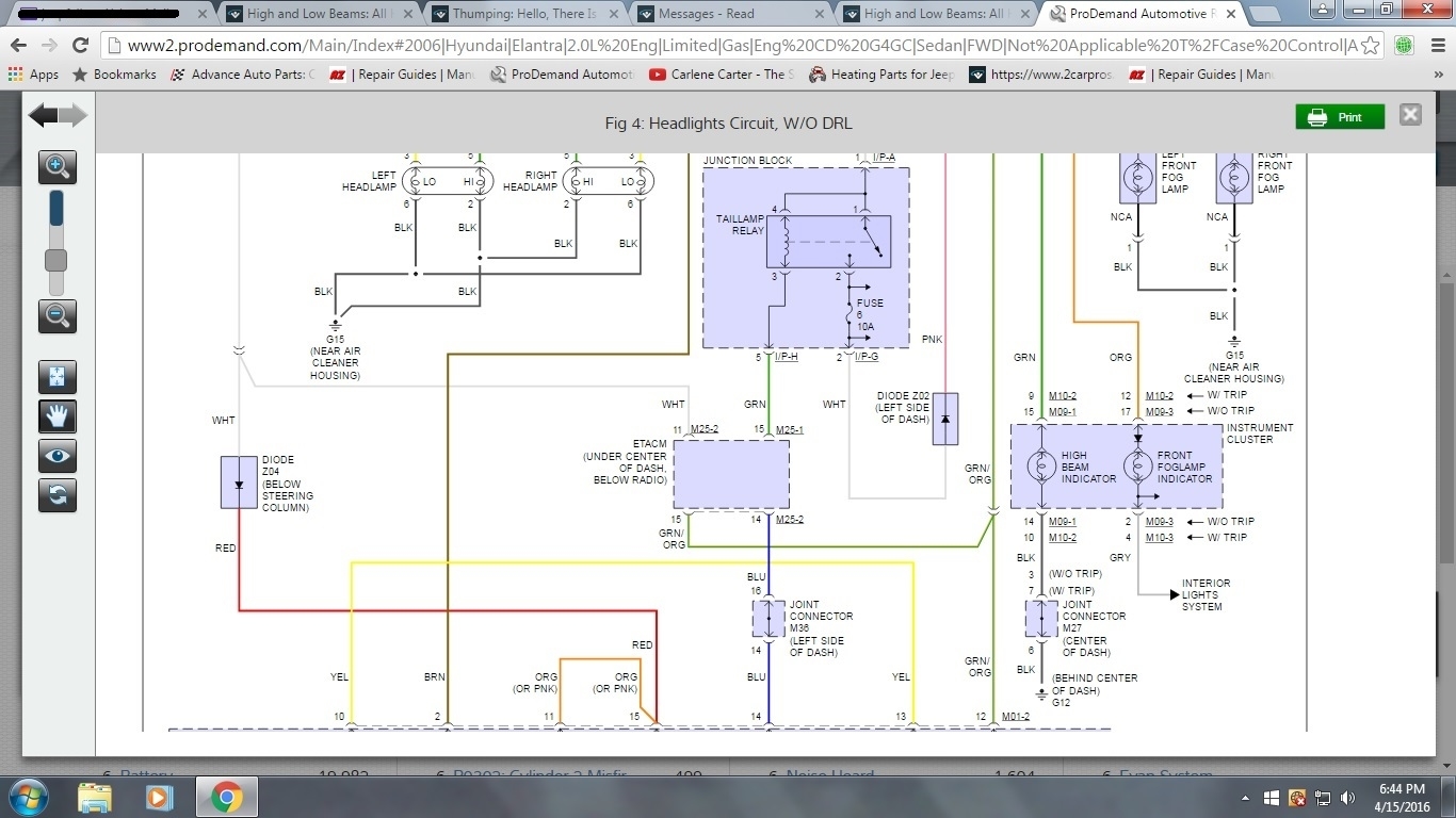

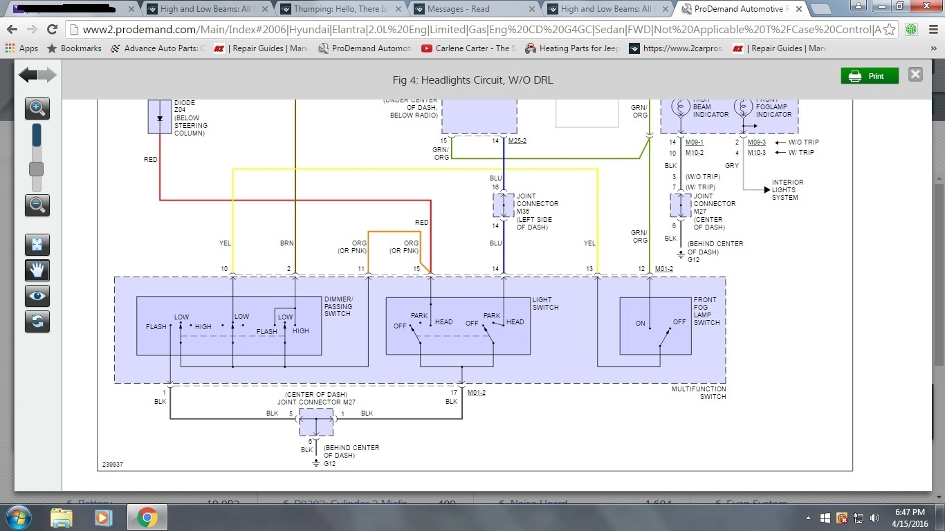

I SCREENSHOT THE WHOLE DIAGRAM IN "PRODEMAND"
I WILL POST THEM IN ORDER TOP TO BOTTOM (THIS IS ONE DIAGRAM CHOPPED INTO THIRDS)
IF YOU CAN PRINT 'EM, I MADE THE SHOTS OVERLAP SO YOU CAN TAPE IT TOGETHER AND NOT MISS NUTHIN'
THIS DIAGRAM IS "NO DRL" (NOT AUTO LAMPS EITHER) SO I RECKON IT'S JUST REGULAR OLE PLAIN JANE LIGHTS
IF YOU WILL LOOK IT OVER WELL, YOU WILL SEE FUSES/ RELAYS/ SWITCHES/ ETC ALONG WITH THE LOCATIONS OF EACH
JUST SORTA GUESSING FOR A POSSIBILITY. LOOK AT THE SECOND PIC, LEFT SIDE, BOTH HEADLIGHTS. THERE IS A GROUND "G15" SEE IF IT IS CONNECTED, MAYBE LOOSEN IT UP AND INSURE IT'S GOT A GOOD CONNECTION (IT'S LOCATION IS LISTED)
THERE ARE OTHER ITEMS THAT ARE IN THE DIAGRAM THAT OPERATE THE LIGHTS, I'D ALSO CHECK FUSES AND FUSIBLE LINKS. IF MR. MULTI-FUNCTION SWITCH HAS HAD A HARD LIFE, DON'T RULE HIM OUT EITHER.
