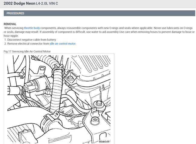

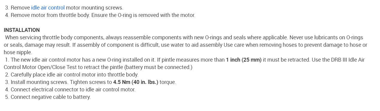

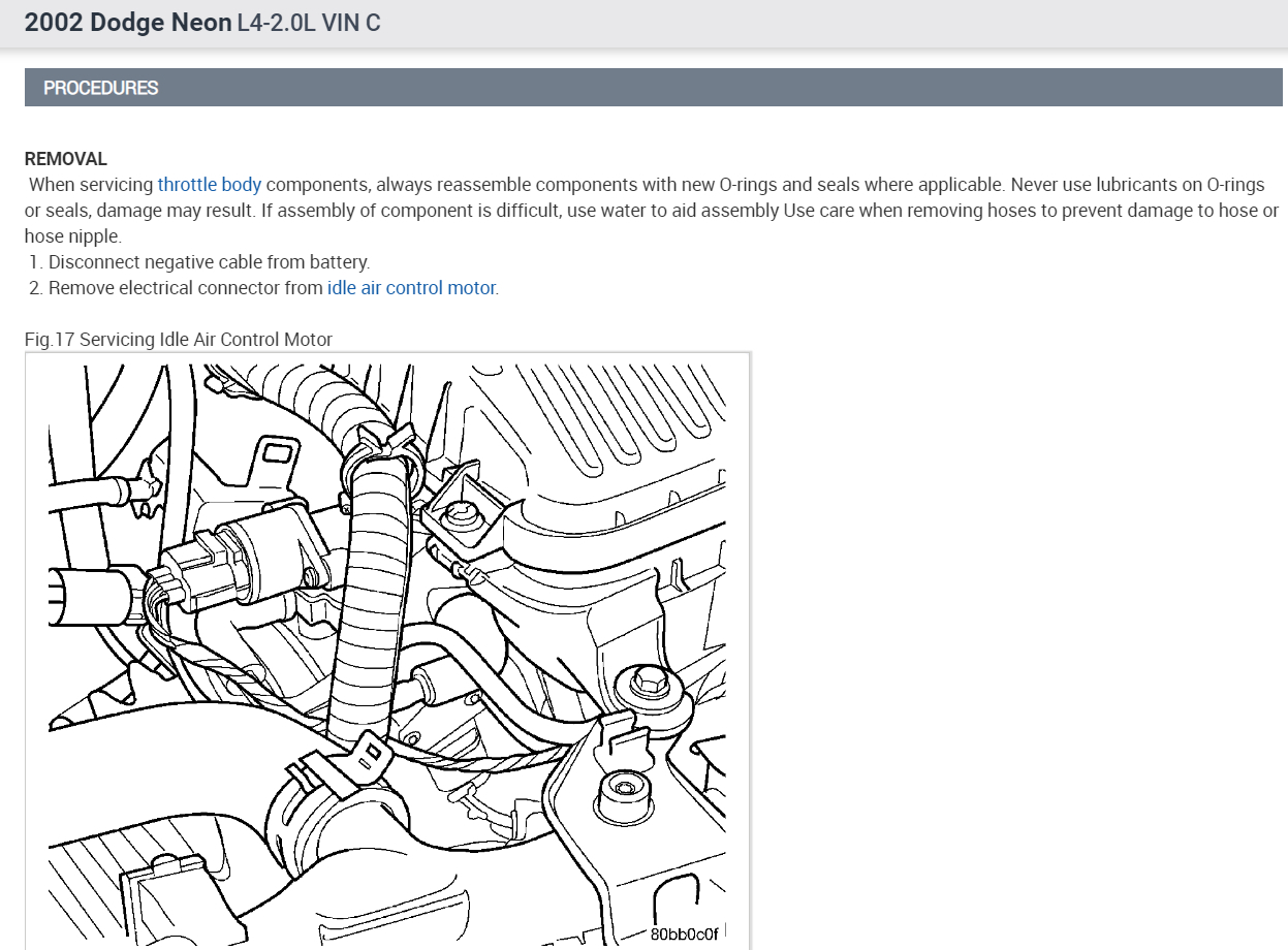

What codes are they? It is probably your IAC motor that is stuck or not working, I would remove the IAC motor and use carburetor cleaner to clean out the passages. Here is the location of the IAC in the images below. This guide may help as well:
https://www.2carpros.com/articles/engine-idles-too-high
