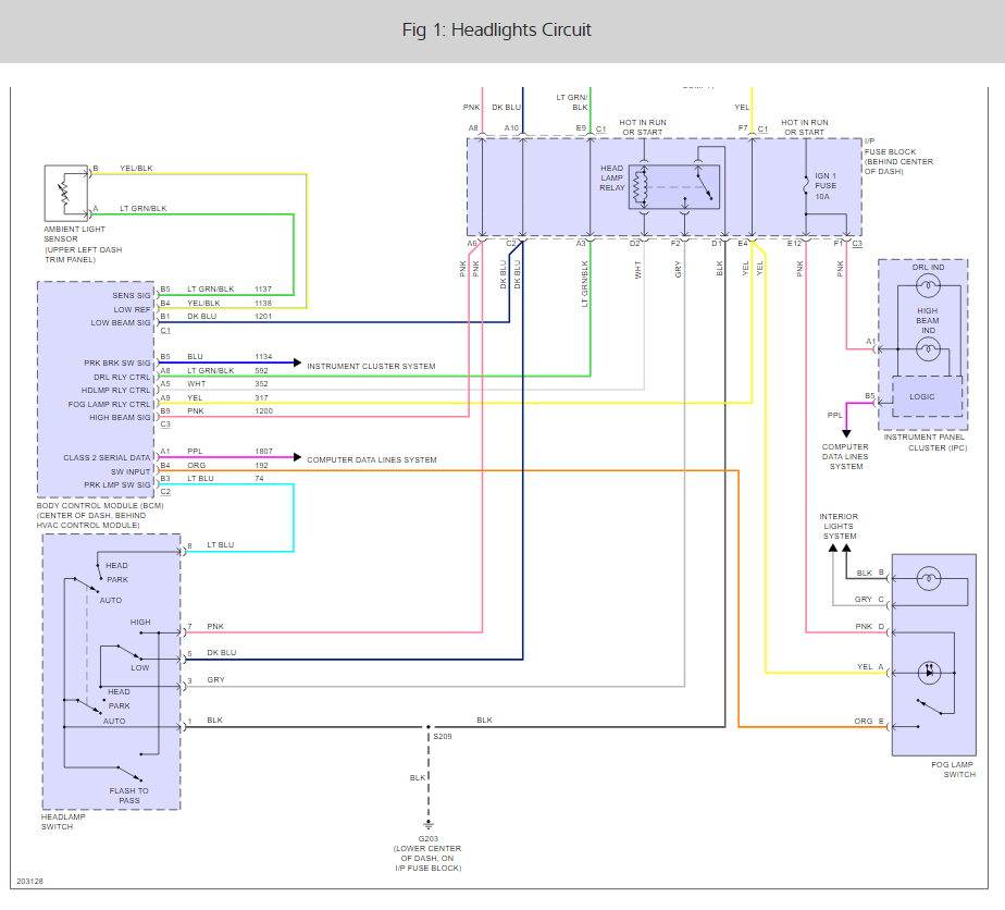

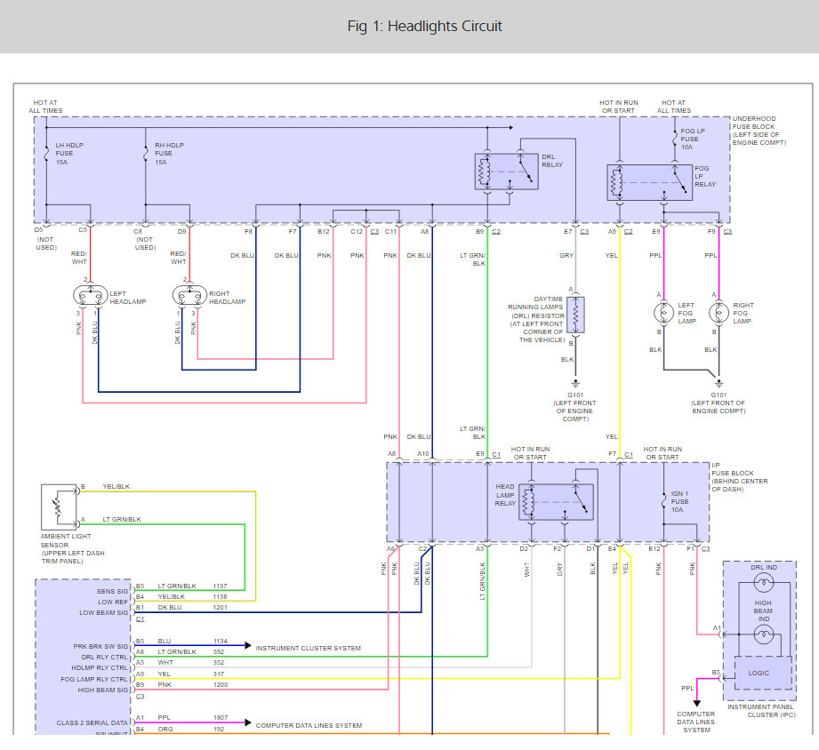

It sounds like you may have blown a fuse, here is some guides and a wiring diagram (below) so you can run some simple tests.
and
Please let us know what you find.

How though when my high beams work and my factory lights work also when I plug hids with ballistic box's to battery they work
