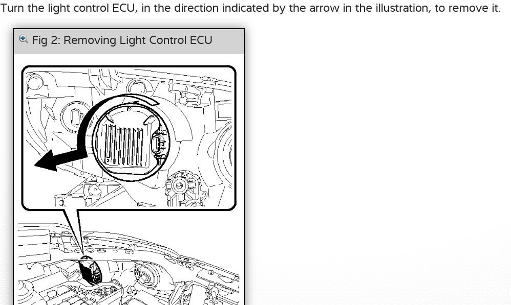

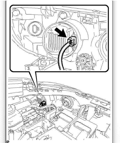

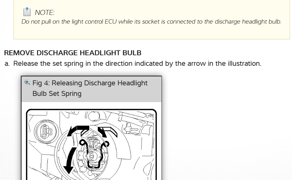

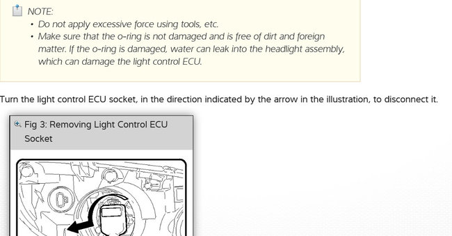

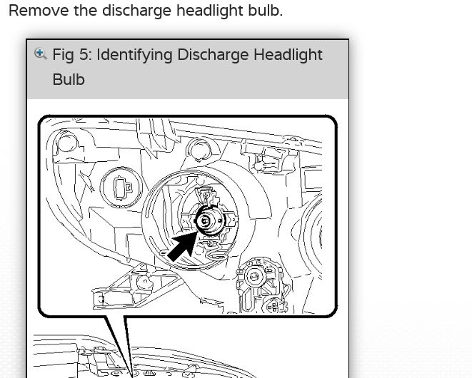

How do i remove the HID bulb on the passenger side headlamp?

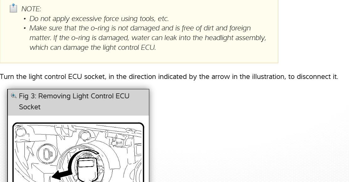

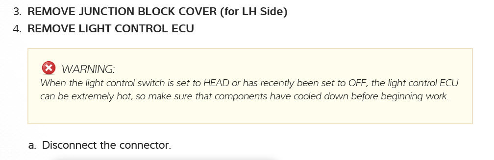

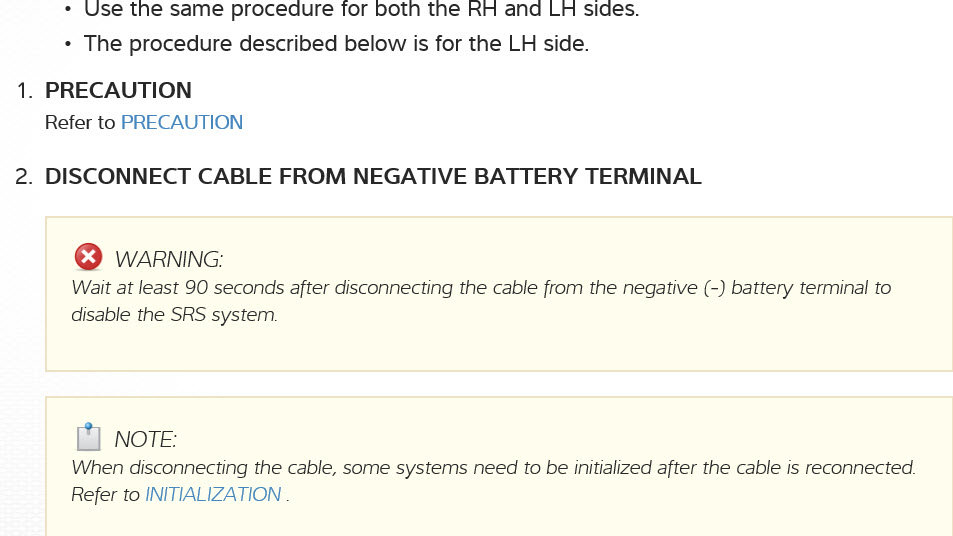

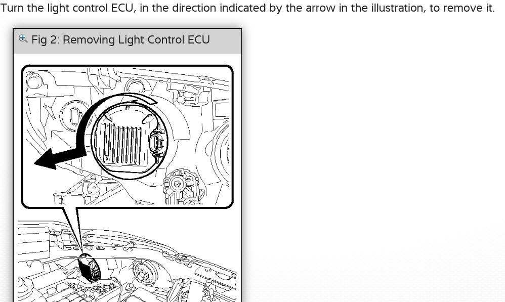

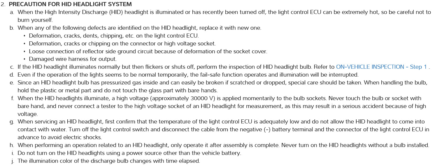

please read precaustion first.... first pic. see other pics.
