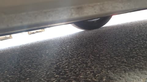

This is the noise.
Kind regards.

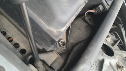

That might be a better one.

Just to confirm it was the rapid tapping noise that you heard in second video when you were coming just off idle?
If this is the case that would be a bearing noise. With this be a diesel they are a noisier but that rapid clicking is a sign of a bearing noise. I would drain the oil and put it through a coffee filter and see if there is metal flake in it.
https://www.2carpros.com/articles/how-to-change-engine-oil-and-filter
Let me know what you find with this.
