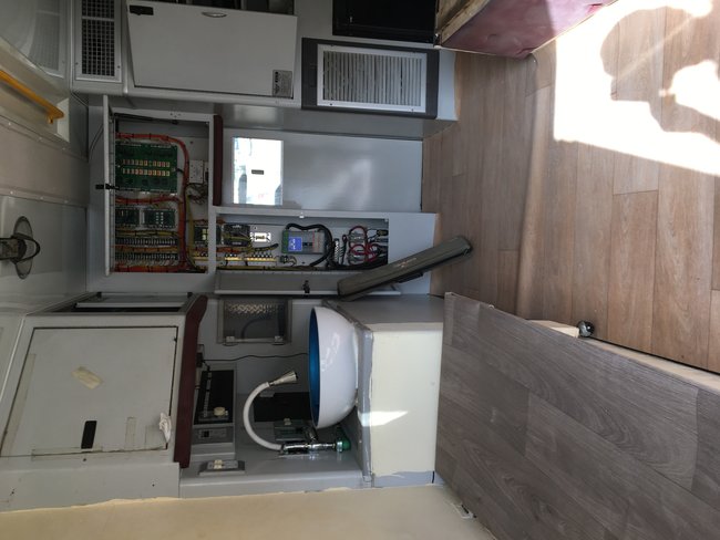

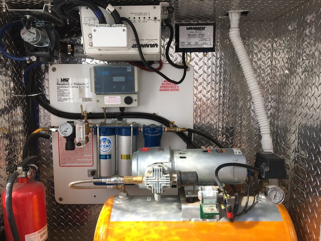

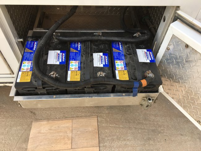

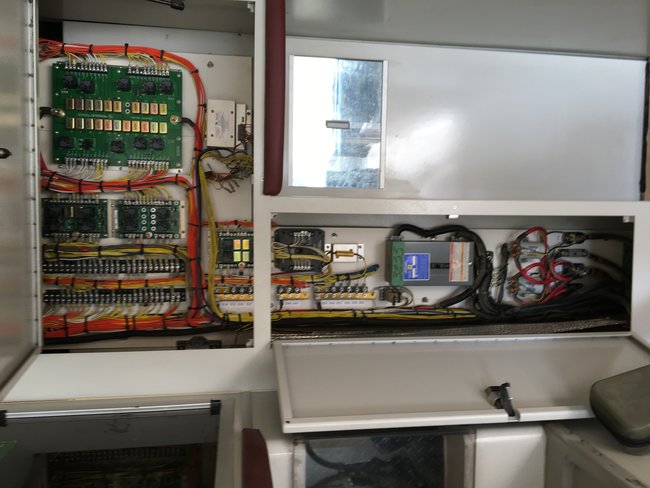

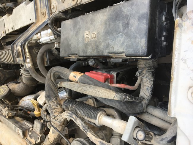

Thanks, Steve, for your time and reply. the unit made by wheeled coach, they sent me the 52 pages of their work, but was hard for me to understand. i have built a shower, toilet and small kitchen. i but water tank and 12v water pump in the compartment some time i camp for two days that way i don't my crank battery go drained that's why i want to have crank battery separately from the other two batteries. i hope the attached image help which wires i should isolate.

That is a different layout than they normally use. Most of the units I've worked on have a starting battery under the hood, the house batteries are normally in a different location. In your case I would probably add a different battery in another spot. Then set that one up as a starting battery. It would allow you to use a common isolator to split the systems and still charge the batteries with the factory alternator. You could do that with the current batteries but it's going to take running new cables to one battery to split it off and installing a heavier cable to run the starter. An RV store would have all the parts.
