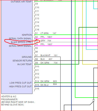

Yeah, I am not talking about that resistor I am talking about the front blower motor.
There is a adapter that connects to the blower motor and I am not getting power to the middle wire which is the gray wire. There is a red wire which there is power and a black is the ground.
Jul 22, 2018 at 11:08 AM
DANNY L
CERTIFIED EXPERT
5,648 POSTS
Hello again.
Okay, I found and attached a picture of where the gray wire goes. It connects to the D3 terminal on the blower speed control circuit of the heater and A/C programmer (circled in red). The programmer is located behind the right side of dash, behind the glove box. You can test this with a digital bolt Ohm Meter. I have attached a link showing how to test. Hope this helps and again thanks for using 2CarPros.
