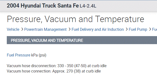

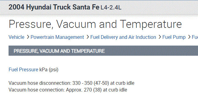

The picture below shows the manufacturer's pressure specifications.
