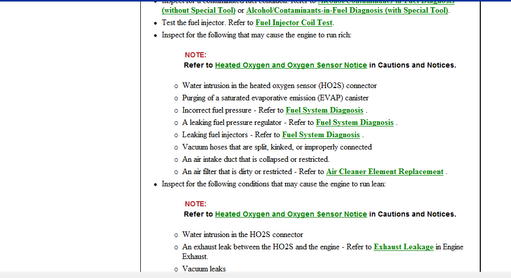

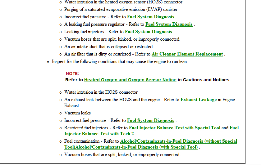

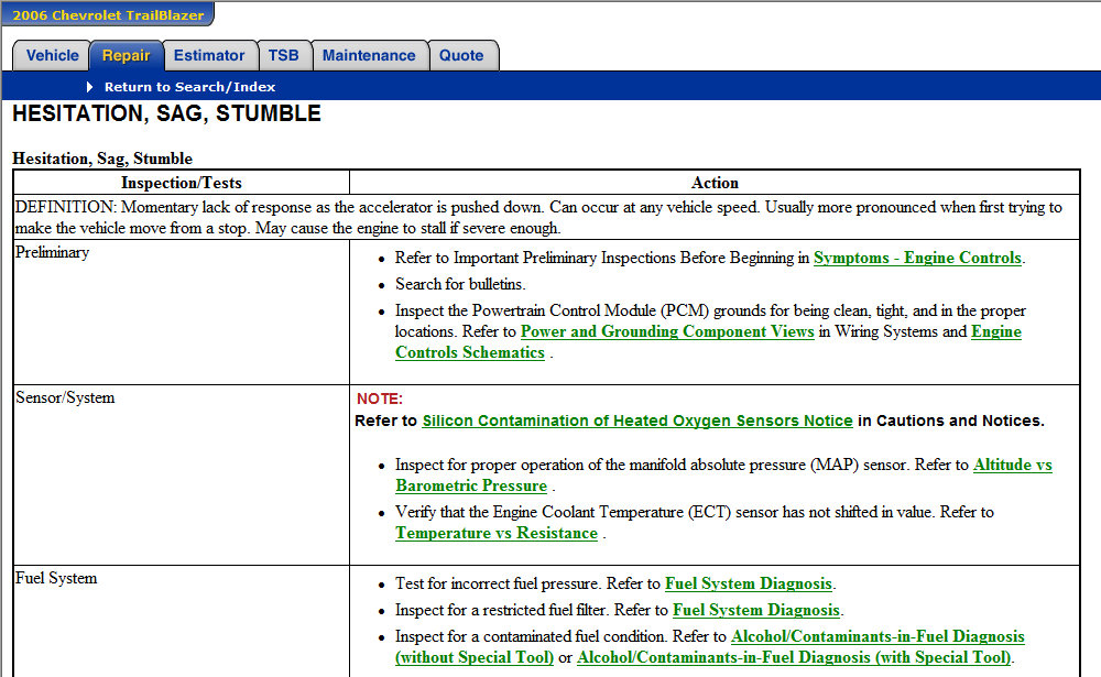

Our problem can be from fuel system or ignition system first we must check the fault codes.
send fault codes to us for more trouble shooting.
check our guide for more tips for engine hesitation:
https://www.2carpros.com/articles/engine-hesitates
check fig 1,2,3 for trouble shooting hesitation specific to your vehicle.
